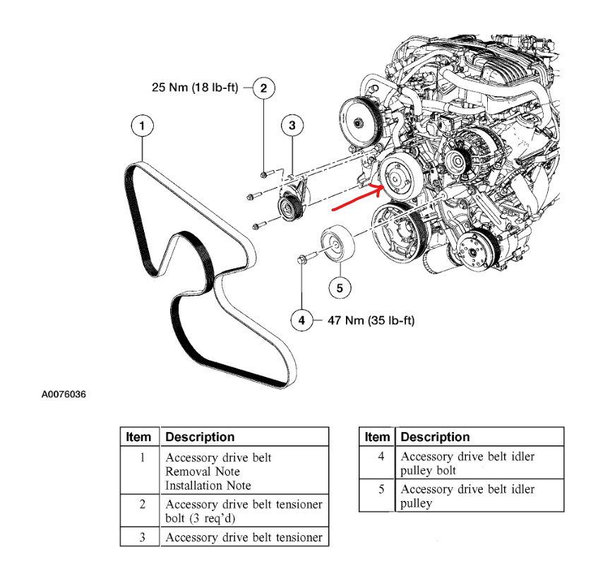

I had a leak in water pump replaced it with new one , then the knocking noise from engine just started

Take belt off and see if noise is still there, also check the water pump belt pulley is tight to make sure it is tight, this guide can help as well
https://www.2carpros.com/articles/understanding-and-repairing-engine-knocking-noise-an-in-depth-guide
check out the images (below). Please let us know what happens.
