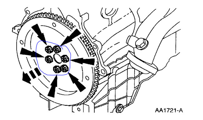

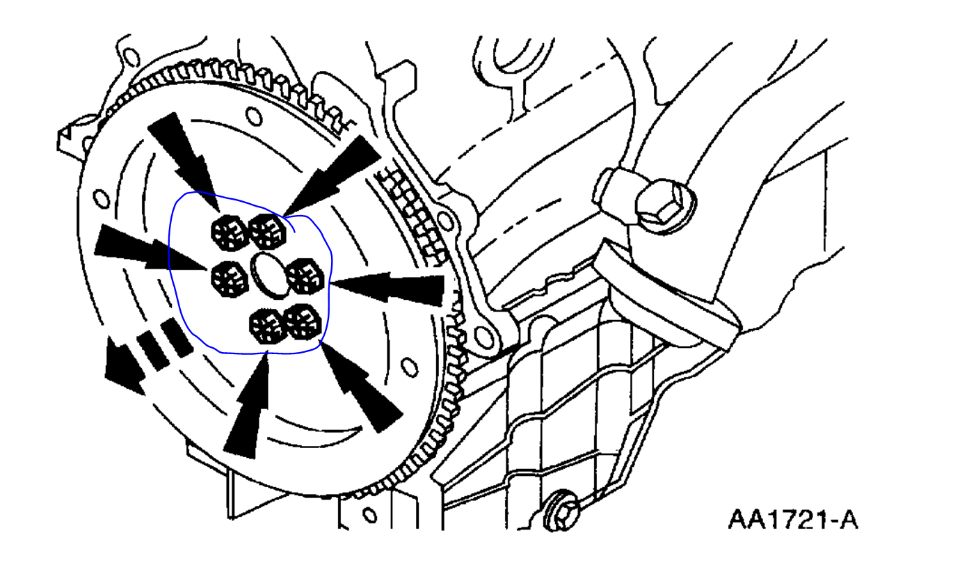

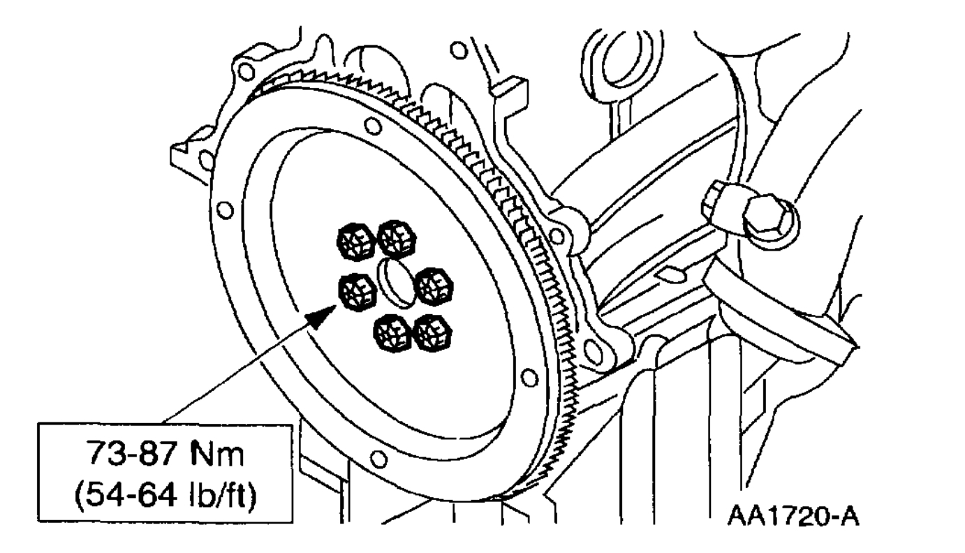

The other possibility is a cracked flywheel. It would only make a knocking noise under load which would be when it is in gear.
The transmission needs to be removed to gain access to the flywheel.
I attached a YouTube video for you of the removal.
https://www.youtube.com/watch?v=AyG4xmSWylE
https://www.2carpros.com/articles/transmission-replacement-removal-manual
Removal
1. Remove the transmission/transaxle.
2. Remove the clutch, if equipped.
3. Remove the flywheel or flexplate.
- Remove the bolts.
- Remove the flywheel or flex plate.
Installation
NOTE: Engine balancing is not required. Balance weights should not be installed on new flywheel.
NOTE: Special bolts are used for installation. Do not use standard bolts.
1. Inspect pilot bearing (manual transmission only). Install a new one as necessary.
2. Install engine rear plate, if removed.
3. Install the flywheel or flexplate and flywheel reinforcing plate on the crankshaft.
4. Tighten the bolts in a criss-cross pattern.
5. Install the clutch, if equipped.
6. Install the transmission/transaxle.
