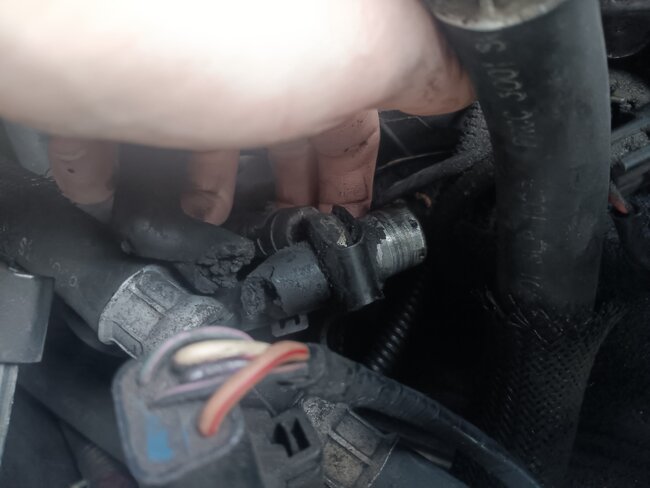

The knocking noise video is first & im not sure what this is in the pic , hopefully u can help me identify it. Thanks So Much

The engine noise does not sounds good, also it looks like you found the vacuum leak. It does sounds like the timing chain system needs to be replaced, but can I ask if this is the original engine (275k miles)? If so it needs to be rebuild, if you go over this video series it will show you how step by step.
https://www.youtube.com/watch?v=QuNLrE3rrb8&list=PLe3kz1i_LrtW1Jw7wWI-3jSsaml8EjQVb
Thanks for the video and images. Let me know.

I cant tell if the noise is the vacuum leak or the serpentine belt that needs to be replaced. As far as the engine noise I would change the oil and filter to see if that helps, the noise is a broken timing chain guide, bad timing chain if you want to fix it. This video shows how to replace the set.
