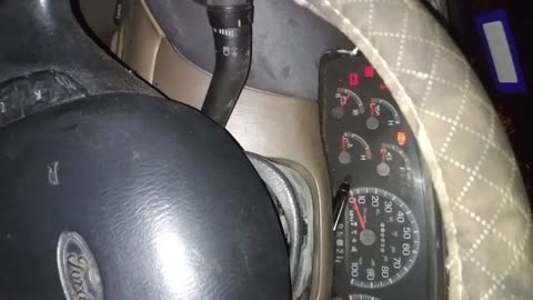

I'm at work right now but when I get off I'll record the sound and send it to you. it could be a ticking noise because the noise is coming from the left side of the motor at the bottom. I can hear it more underneath the truck than i do at the top. Also before I change out my catalytic converter my oil pressure gauge would bounce when idling. now I have to keep it revved up to 1,500 to 2,000 RPM's or else the oil pressure gauge will drop and the truck will shut off.
Nov 11, 2020 at 9:31 PM
JAMESBURROW
  • 46 POSTS
And it seems to get worse when the engine gets warmed up.
Nov 11, 2020 at 9:33 PM
JAMESBURROW
  • 46 POSTS
Video.
Nov 12, 2020 at 8:52 AM
  • 110,244 POSTS

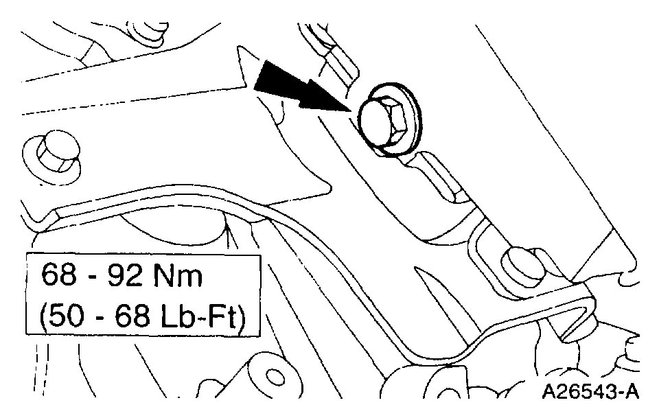

In all honesty, I hear what sounds like an exhaust leak (tick). However, when you revved the engine, I heard a knock when you let off. If I had to guess, I think you have a bad connecting rod bearing or one of the main bearings. If the oil is clean and full, I suspect you should remove the oil pan and actually check for a loose rod bearing.
The proper way to check bearing clearance is to use a product called plastigage. Here are the directions. I just want you to see what I am referring to. It requires a good bit of work.

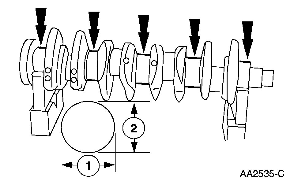

2005 Ford Truck F 150 4WD Pickup V8-5.4L SOHC VIN 5
Crankshaft
Vehicle Engine, Cooling and Exhaust Engine Cylinder Block Assembly Crankshaft Service and Repair Procedures Crankshaft
CRANKSHAFT

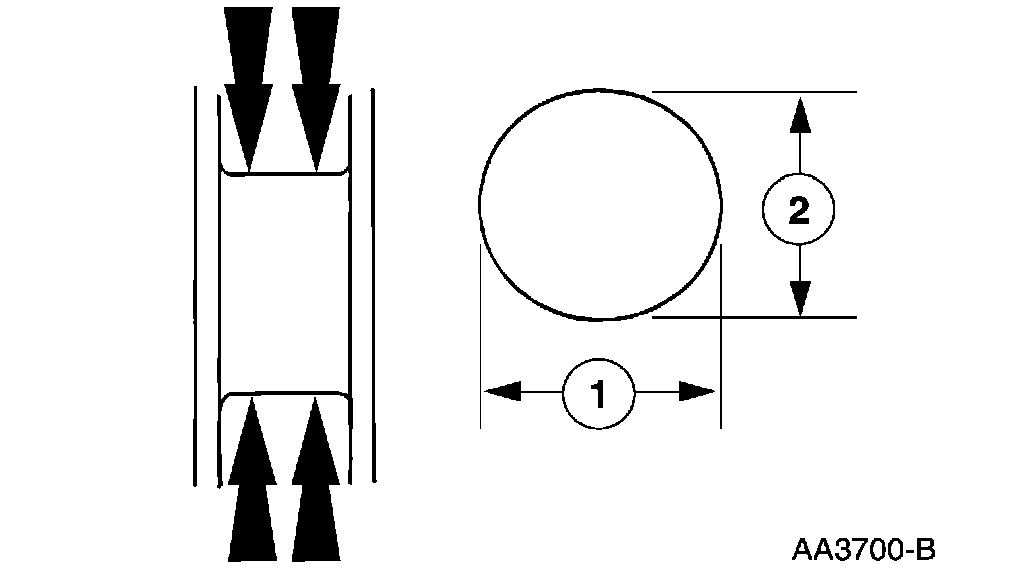

Crankshaft Main Bearing Journal Diameter
pic 1
1. Measure each of the crankshaft main bearing journal diameters in at least two directions.
If out of specification, install new components as necessary.

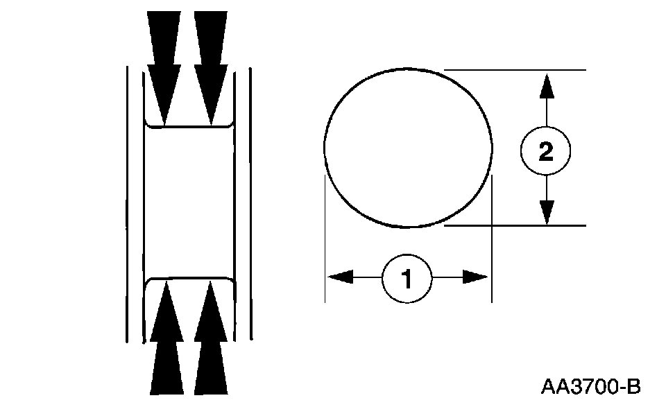

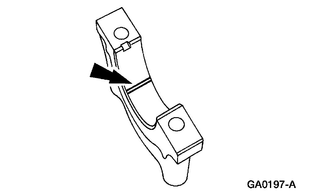

Crankshaft Main Bearing Journal Clearance
pic 3
Special Tool(s)
NOTE: Crankshaft main bearing journals must be within specifications before checking journal clearance.
1. Remove the crankshaft main bearing caps and crankshaft main bearing.
pic 4

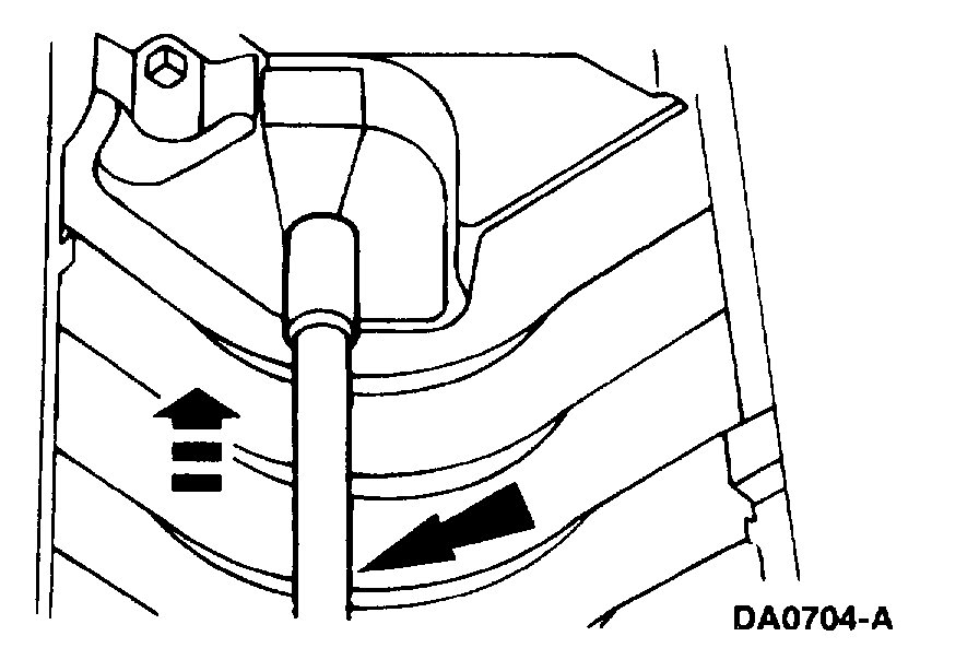

2. Lay a piece of Plastigage across the face of each crankshaft main bearing surface.
3. NOTE: Do not turn the crankshaft while carrying out this procedure.
Install and remove the crankshaft main bearing cap.
pic 5
4. Verify the crankshaft journal clearance.

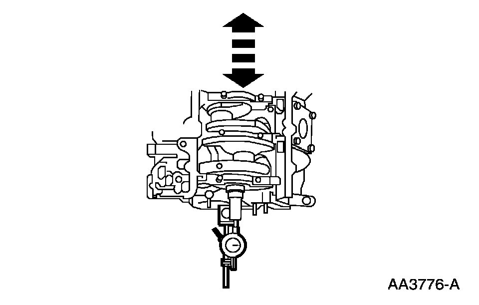

Crankshaft End Play
pic 6
Special Tool(s)

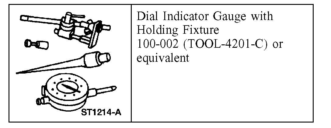

1. Measure the crankshaft end play. Use a Dial Indicator Gauge with Holding Fixture to measure crankshaft end play.
2. Position the crankshaft to the rear of the cylinder block.
3. Zero the indicator.
pic 7
4. Move the crankshaft to the front of the cylinder block. Note and record the crankshaft end play.
If crankshaft end play exceeds specifications, install a new crankshaft thrust washer or crankshaft thrust main bearing.

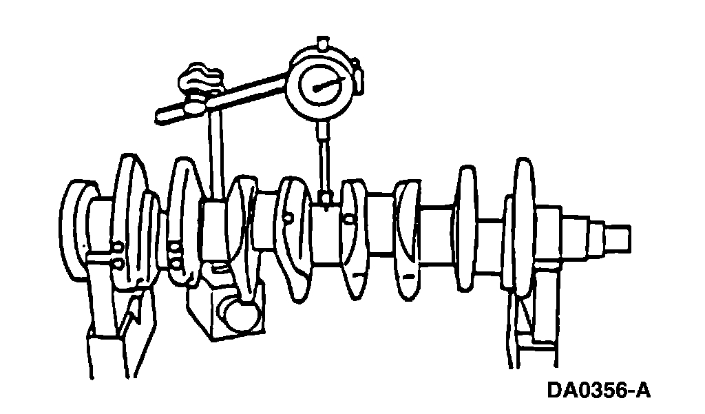

Crankshaft Runout
pic 8
Special Tool(s)
pic 9
1. NOTE: Crankshaft main bearing Journals must be within specifications before checking runout.
Use the Dial Indicator Gauge with Holding Fixture to measure the crankshaft runout.
Rotate the crankshaft and subtract the lowest dial indicator reading from the highest dial indicator reading to figure the crankshaft runout. If it is out of specification, install new components as necessary.
Crankshaft - Connecting Rod Journal Taper, Out of Round
pic 10
1. Measure the crankshaft connecting rod journal diameters in two directions perpendicular to one another at each end of the connecting rod journal. The difference in the measurements from one end to the other is the taper. Verify measurement is within the wear limit.

If this is the original engine and it has 300K, you would likely be better off replacing the engine simply because of wear.
Let me know if you have any questions, and I'm sorry for the bad news. Please remember that I am listening to a recording, so I could be wrong. However, the knocking was somewhat loud when you left off the throttle.
If I can help in any way, let me know.

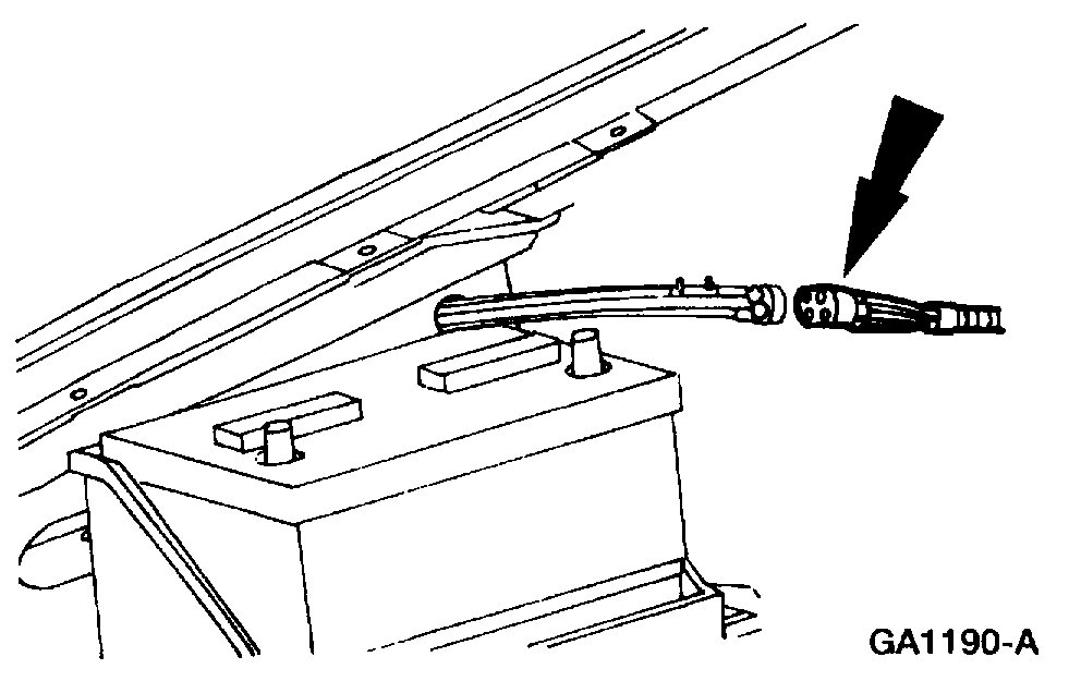

1. Disconnect the battery ground cable.

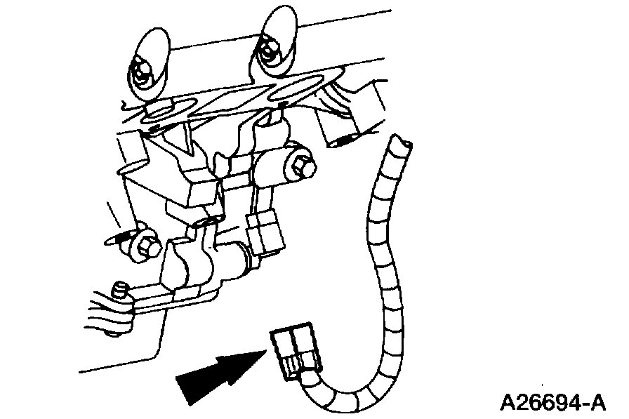

5. Disconnect the climate control vacuum connector.
pic 3
6. Disconnect the evaporative emission canister purge valve vacuum connector.
pic 4

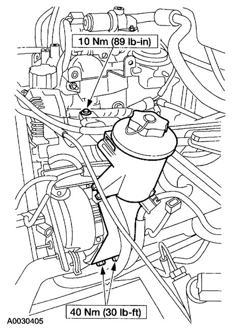

7. Position the power steering reservoir aside.
^ Remove the upper bolt.
^ Remove the lower bolts.
^ Position the reservoir aside.

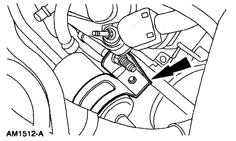

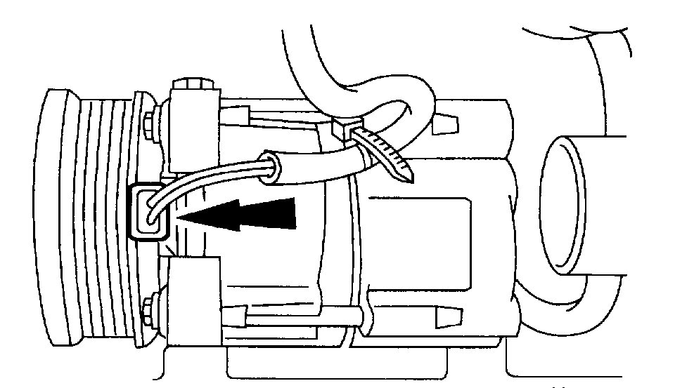

9. Disconnect the two starter cable leads from the starter relay.
pic 6

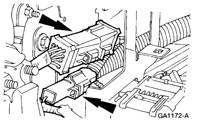

10. Disconnect the two 42-pin connectors and the single pin connector.
pic 7

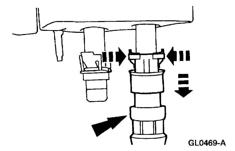

13. Compress the holding tabs and disconnect the heater water hoses from the heater core.

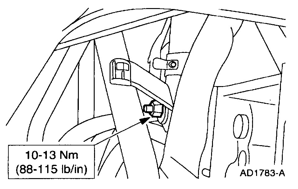

pic 11

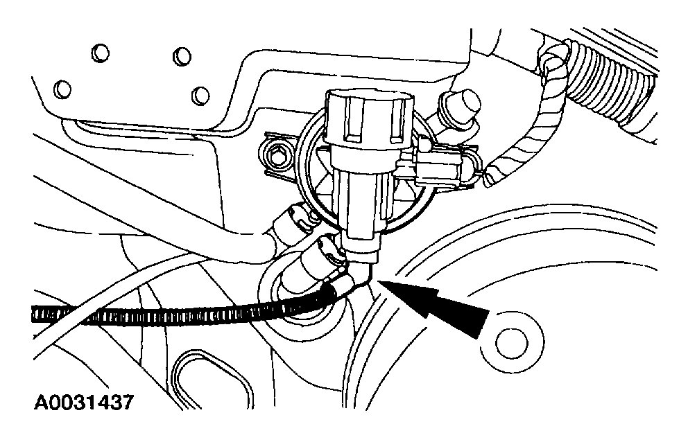

16. Disconnect the A/C compressor electrical connection.
pic 12
17. Disconnect the crankshaft position (CKP) sensor.

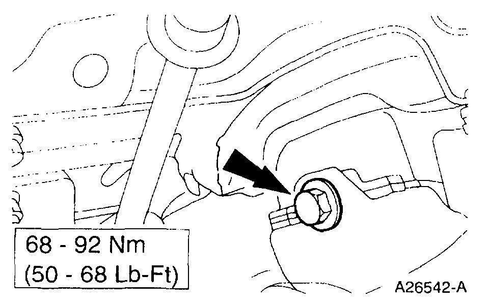

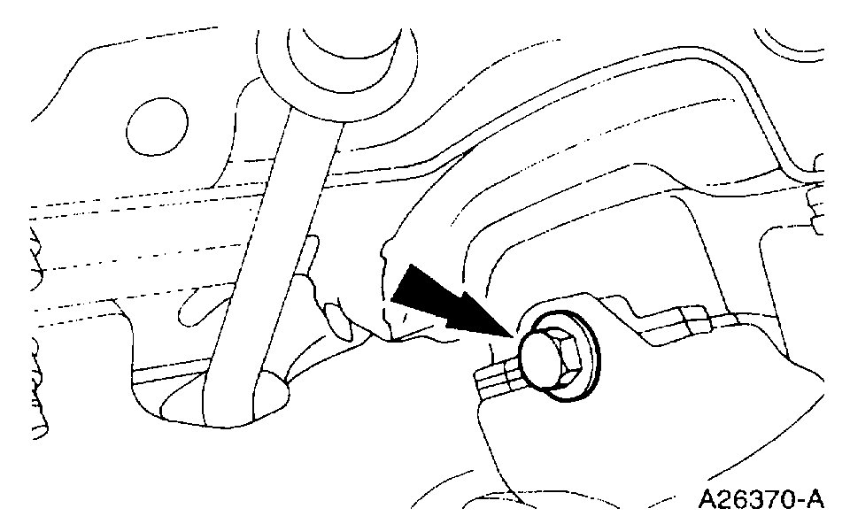

18. Remove the starter motor.
19. Remove the A/C compressor.

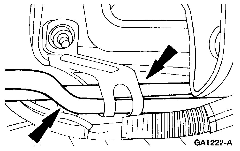

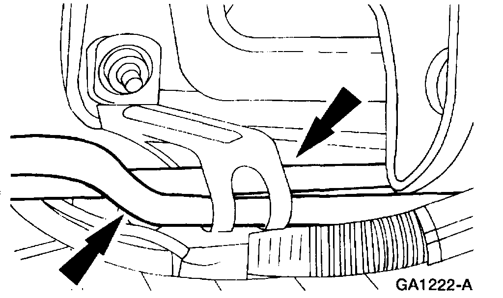

20. Remove the A/C line (muffler) bracket and position aside.
pic 14
21. Remove the transmission fluid cooler hose from the block-mounted clip.

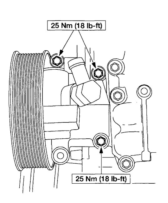

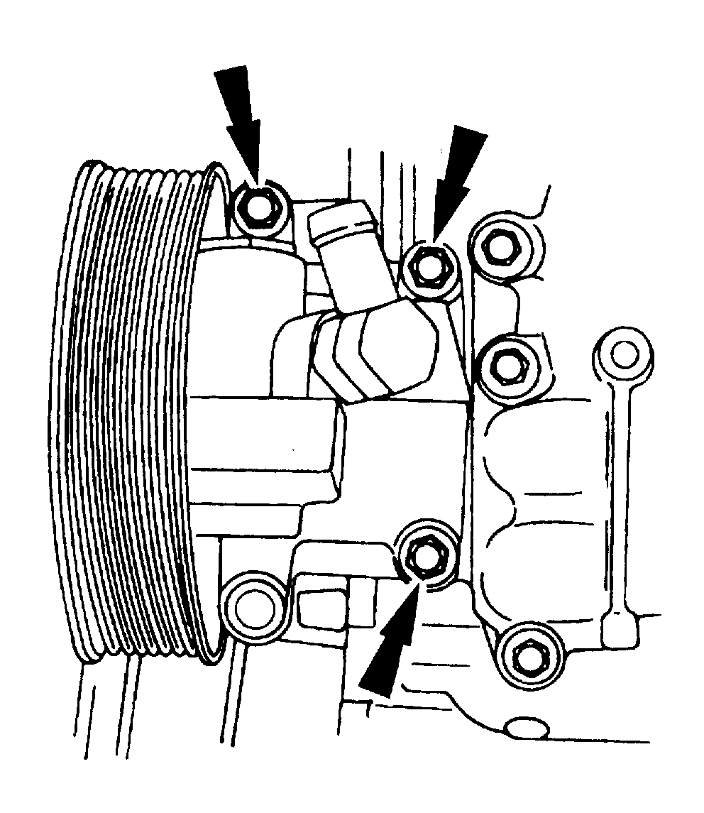

pic 16
24. Remove the bolts and position the power steering pump aside.
pic 17

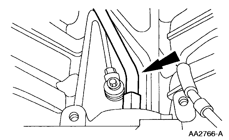

25. Disconnect the oil pressure sender electrical connection.

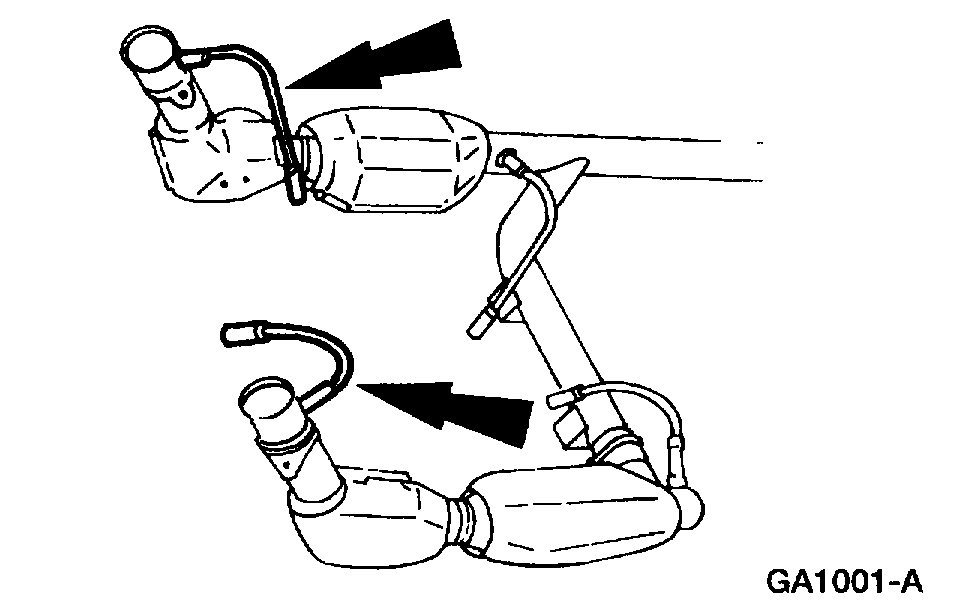

pic 18
26. Disconnect the heated exhaust gas oxygen sensor electrical connectors.
pic 19

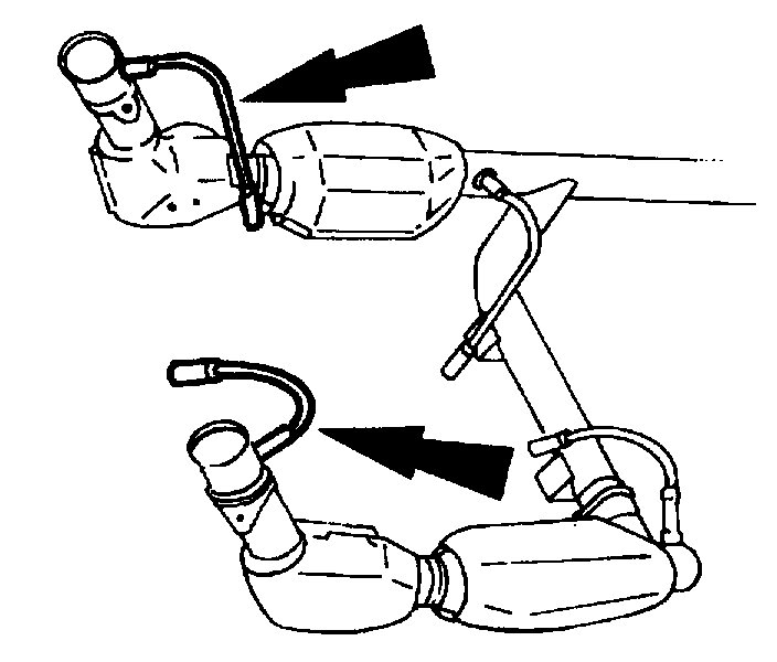

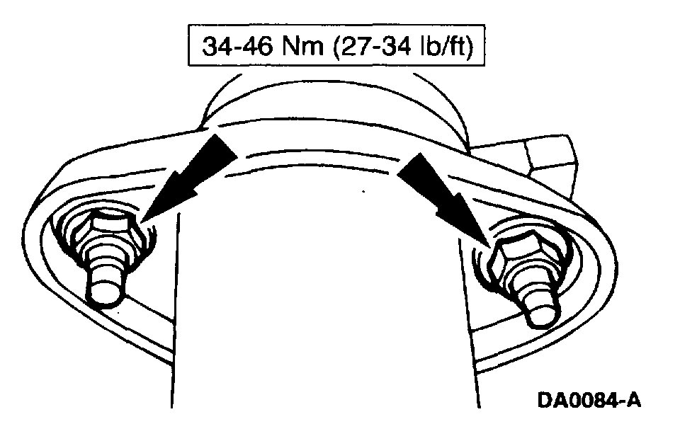

27. Remove the RH exhaust manifold to three-way catalytic converter nuts.
28. Remove the RH exhaust manifold studs.
pic 20
29. Remove the LH exhaust manifold to three-way catalytic converter nuts.
^ Position the Y-pipe aside.

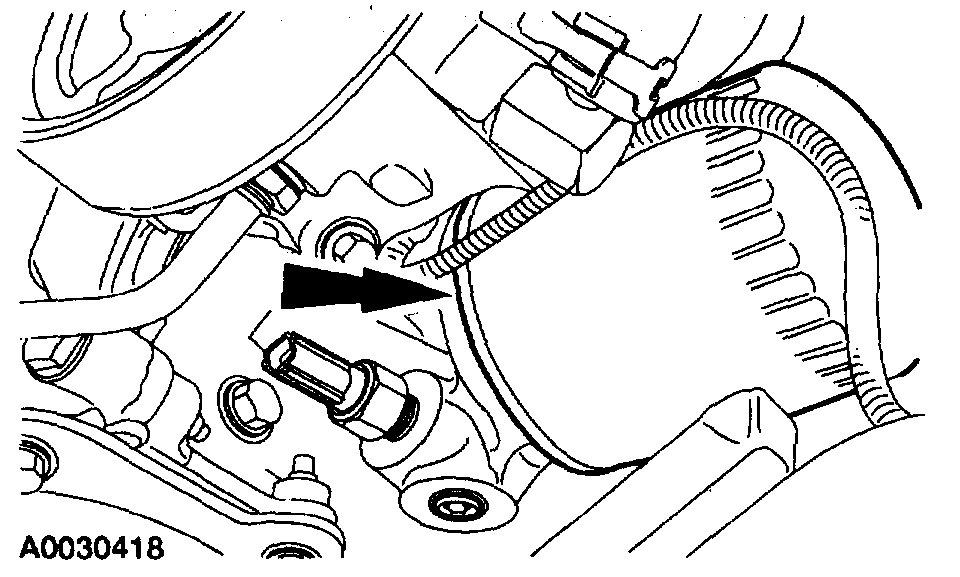

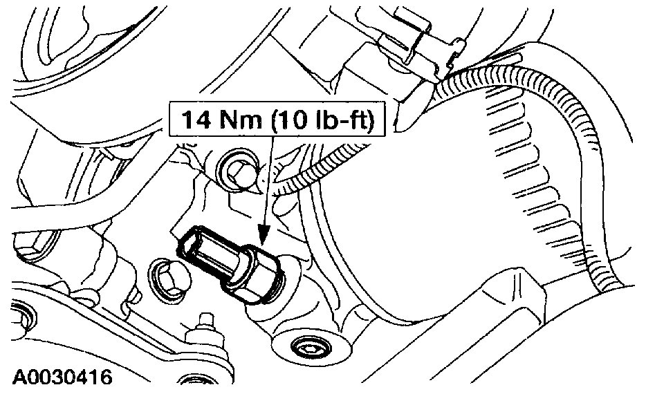

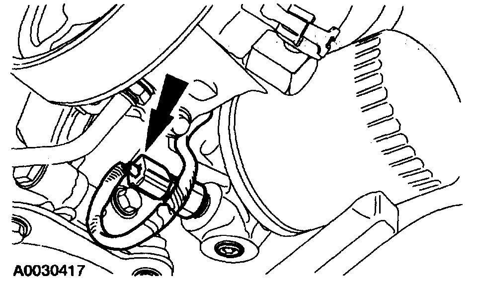

32. Remove the oil bypass filter.
pic 24

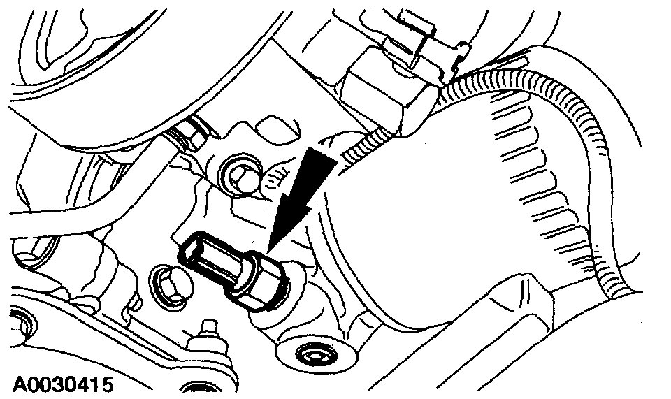

33. Remove the oil pressure sensor.
pic 25
34. Slide back the hose clamp and disconnect the lower radiator hose from the oil filter adapter.

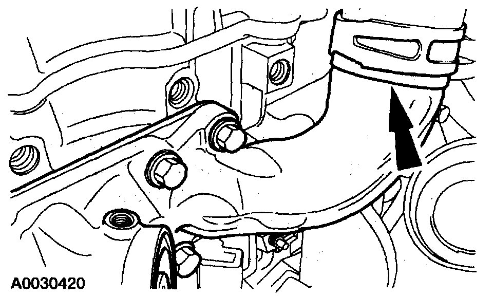

38. Remove the heater water inlet tube and discard the O-ring seal.
pic 27

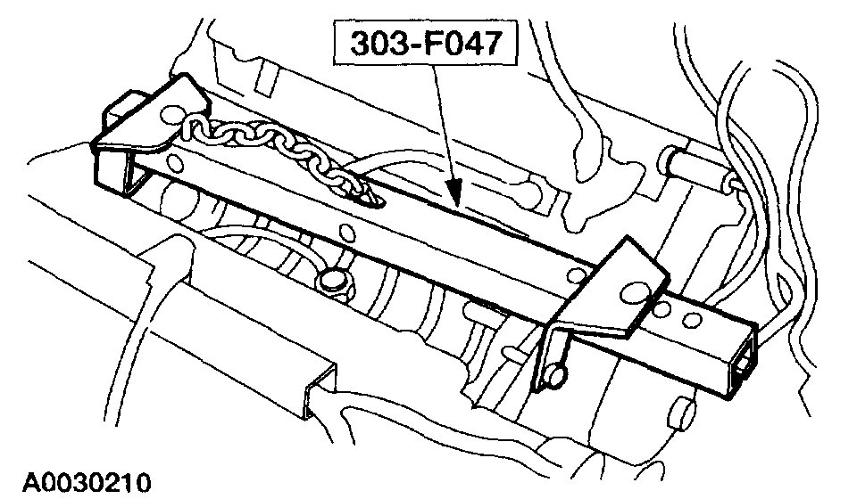

39. Install the special tool.
40. Remove the engine.

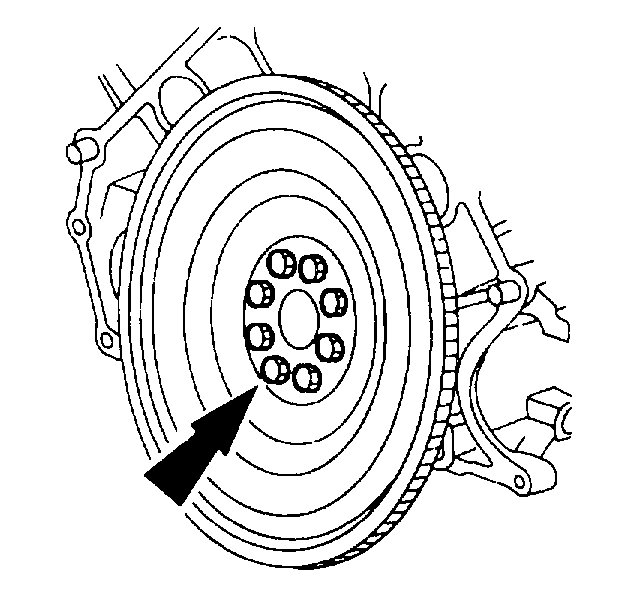

Remove the flywheel.

1. Attach the special tool.
2. Remove the engine from the engine stand.

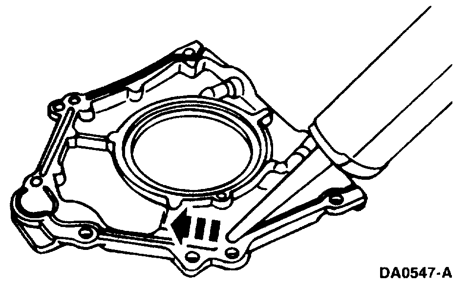

4. NOTE: If not secured within four minutes, sealant must be removed and sealing area cleaned with metal surface cleaner. Allow to dry until there is no sign of wetness, or four minutes, whichever is longer. Failure to follow this procedure can cause future oil leakage.
If the retainer plate was removed, apply a 4 mm (0.16 inch) bead of silicone gasket and sealant around the rear oil seal retainer sealing surface.

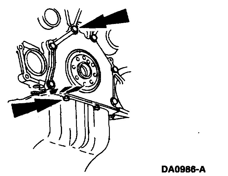

pic 32
5. If removed, install the crankshaft rear oil seal retainer and bolts.
pic 33
6. If removed, install a new crankshaft rear oil seal.
7. If removed, install the crankshaft oil slinger.

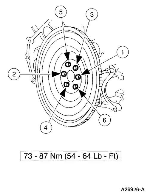

Romeo engine (4.6L)

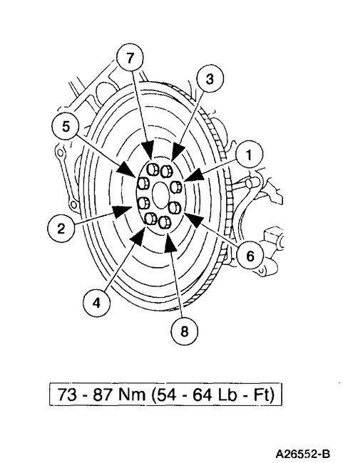

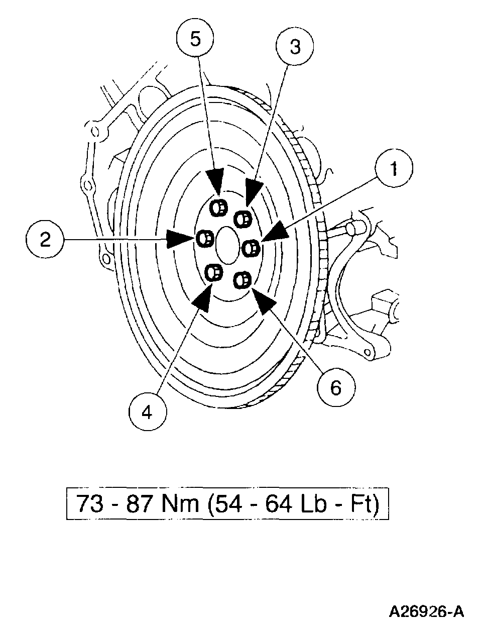

8. Install the flexplate and the bolts. Tighten the bolts in the sequence shown.
pic 35

14. Install the starter motor.
15. Install the A/C compressor.

20. Install the oil bypass filter.
pic 42

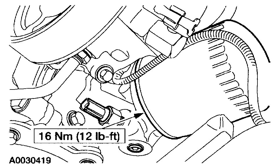

21. Install the oil pressure sensor.
pic 43
22. Connect the oil pressure sensor electrical connector.

30. NOTE: Do not reuse the O-ring seal.
On Windsor engines, slide the water heater tube forward over the new O-ring seal.
^ Lubricate the O-ring seal with engine coolant.

31. Position the transmission wiring bracket and install the upper two transmission bell housing bolts.
32. Connect the transmission wiring harness connectors.

37. Install the power steering reservoir.
^ Position the reservoir.
^ Install the two lower bolts.
^ Install the upper bolt.
