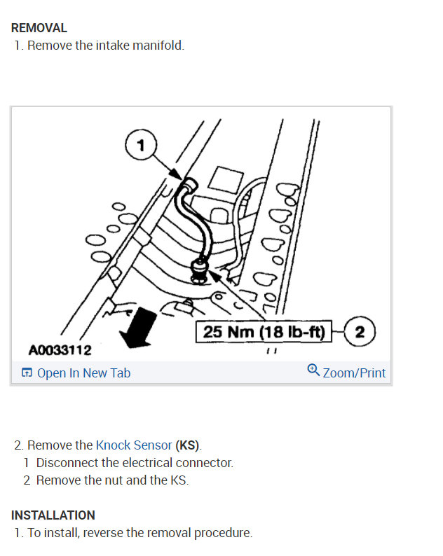

Got a oil change with the filter. Also replaced number two 02 sensor.. week later it starts knocking then turns into pinging. Now just flip a coin one day it knocks and other day it just pings and some days nothing. Now I live by the mountains and when I go shopping down from here it's not so bad but soon as I get home it starts in again. I have checked everything. I'm lost for words and haven't a clue what's going on.
Jan 12, 2021 at 8:49 AM
  • 55,399 POSTS

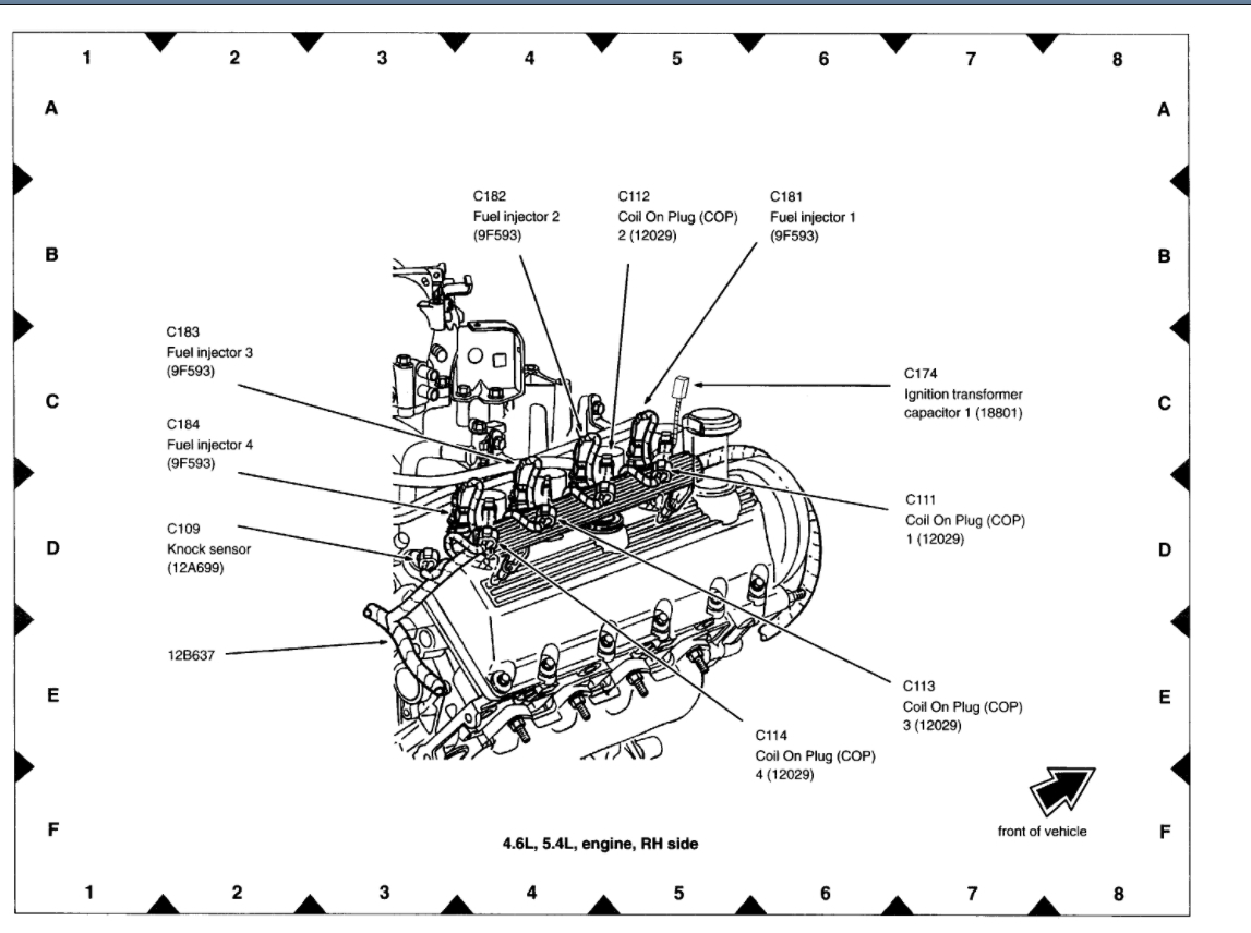

it sound like the knock sensor stopped working but we should run the codes first. this guide will help with the knock sensor location in the diagrams below:
Jan 13, 2021 at 9:50 AM
HPCMOMMA
Sorry took so long, but thank you and for sure will post what I find out and the codes it is telling me. My first thing is the knock sensor replace. You are not the only one who told me about that. I have went through all options and this is what is next. Thank you and talk to you soon.
