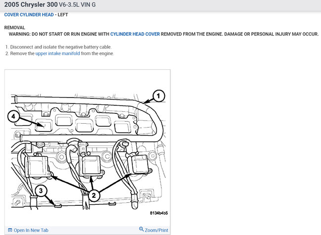

While driving suddenly lost power and the engine started making a knocking/loud ticking noise on the left bank?
150,000 MILES • 3.5L • 6 CYL • 2WD • AUTOMATIC
BOOSTISLYFE
  • 6 POSTS
I was driving to work when all of a sudden it lost power and the engine started making a knocking/loud ticking noise on the left bank of the engine. I heard it could be the rocker assembly. It does have some play it seems like just not totally sure.

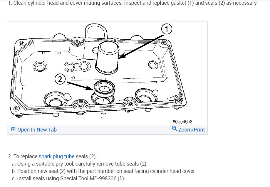

  • 55,721 POSTS

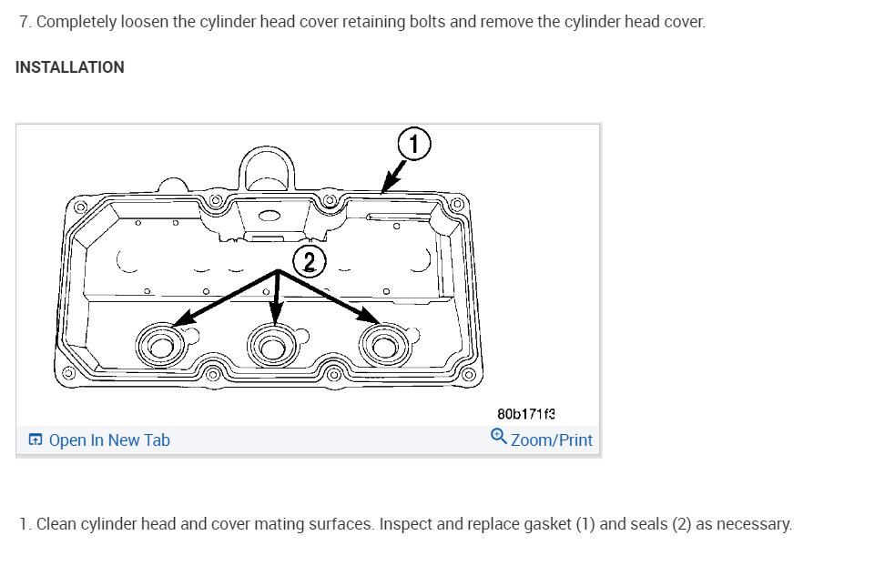

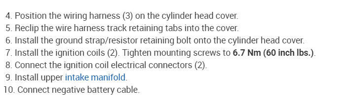

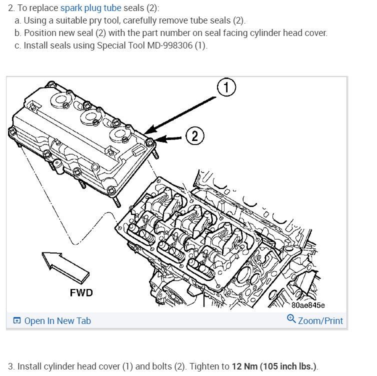

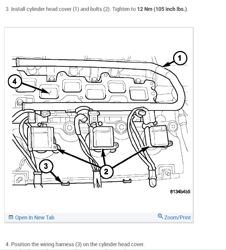

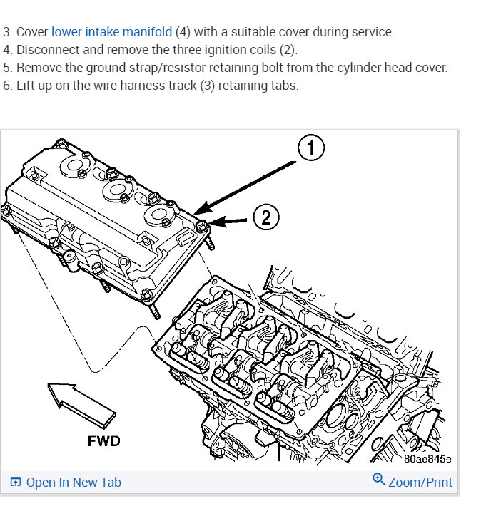

Okay, these engines had problems with the valve train, I would remove the valve cover on the side of the engine that is making the noise to check the rockers and valve lash. You are looking for excessive clearance. Check out the images (below). Let us know what happens and please upload pictures or videos of the problem so we can see what's going on.
Aug 5, 2023 at 3:14 AM

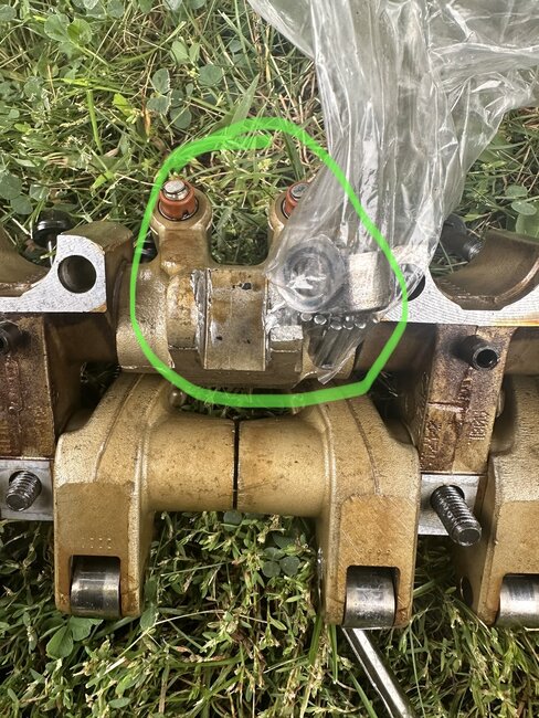

Found this on the other side.
Sep 6, 2023 at 8:00 AM
BOOSTISLYFE
  • 6 POSTS
No that was after taking that one off and why it was loose and coming off the valve.
Sep 8, 2023 at 7:15 AM
  • 55,721 POSTS
Yep, you found the problem, nice work, thanks for the video, let me know if you need anything else to fix the engine.
