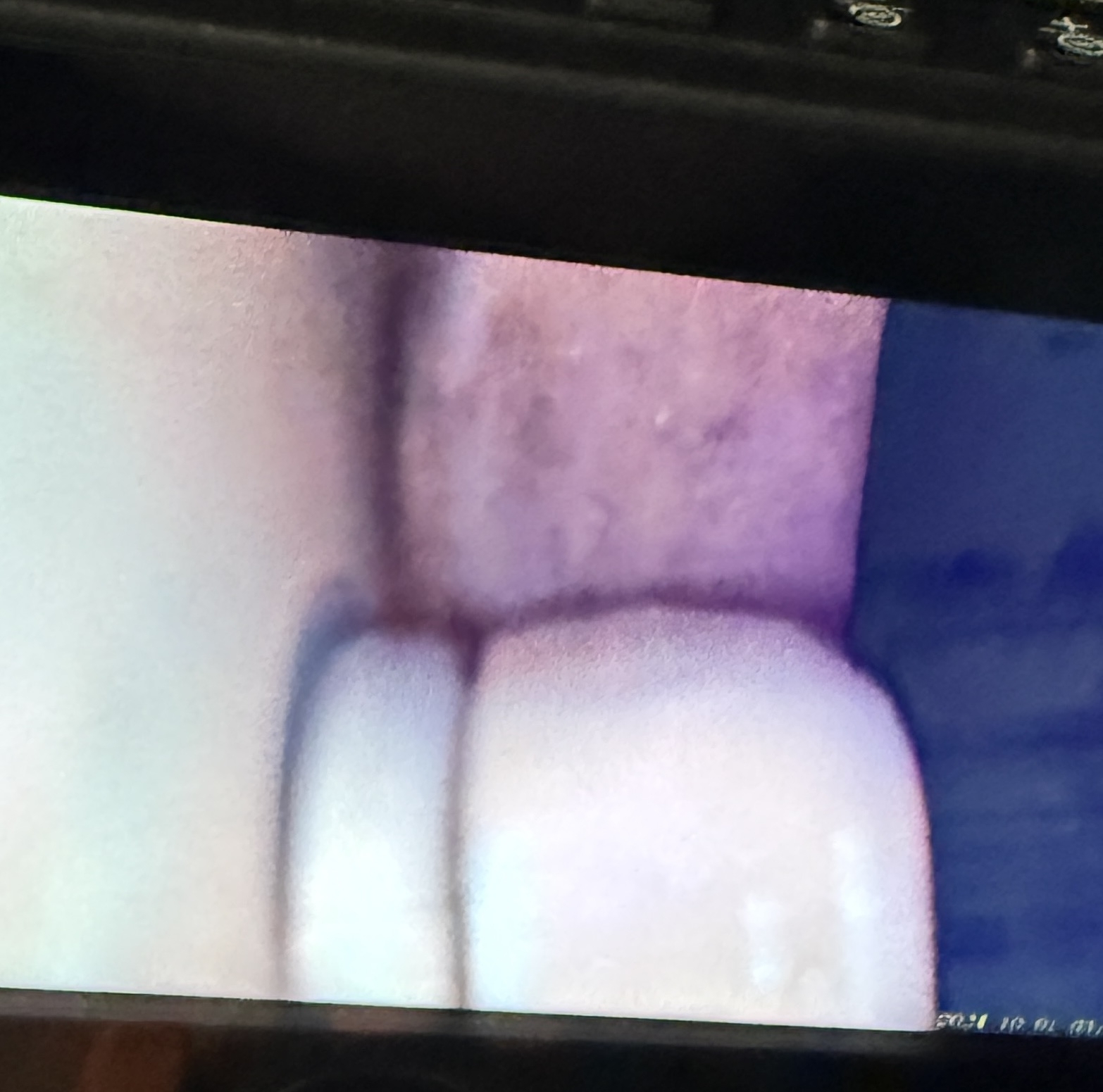

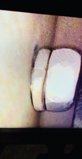

So I took it to a garage today and they went up in the site hole with a camera of the fly wheel and took pictures and said the bolts was loose. They took the starter off and turned the motor and tightened all the bolts up on it. I’ll add the pictures I took from the camera.
But no noise at all now.
Jun 24, 2026 at 5:10 PM
  • 55,381 POSTS
Nice work! I would have bet money on the rod knock. Lucky you :) Sorry about that,,, I am glad you found the problem. I will show this to others to not count out a loose flex plate :)
