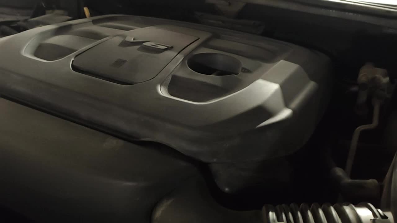

I noticed that engine knockings are obvious during the did day and even during late afternoon, I Iraq, ambient temperature reaches more than 45 degrees centigrades, not sure howmuch is the air temperature,
Th knock becomes more evident when coolant temperature rises to more than 90 degrees, and becomes almost always present when above 100 degrees. Giveng that the maximum coolant temperatures reach upto 107 degrees, but when engine is just turned on and when Air conditioner is on, the coolant temperatures keeps below 85 degrees , no knock is present.
Not aure wheather this has long been present or a recent issue,
My ocatane rate is 90 and above which is already known here in Iraq to be a qualified degree fuel,
Even so I tried the premium fuel , the same problem was there.
Alot of aftermarket shops, advertising about ecu reprogramming, claiming that these car are programmed already for low temperature countries, not for middle east, and they should be reprogrammed for the AFR, and for the cooling Fan low threshould start.
Wheather right or not, I am not convinced with that and looking for trusted advice.

Hello, I can help you, can you please upload a short video of the engine noise I can tell for sure what's going on once I hear the engine. Here is a guide of engine noises but a video would be best.

Here is it.

Thanks for the video, from what I can hear the engine sounds okay, is there a certain RPM that the engine will make the noise?

SorryI did not mean any noise but an engine knocking that appears on the description already sent, related to pre ignition.
I am sorry if I was supposed to use another term.
But I think it should be the right term ( engine knocking related to engine pre ignition or retad sensors and air fuel mixture.

So, is the problem can be bad fuel, do you have a check engine light on?

No check engine light.
Premium fuel was used, and the same problem.

Like I say I checked out the video and the engine sounds okay, can you have a helper rev the engine up while you take the video?
