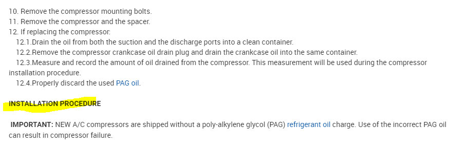

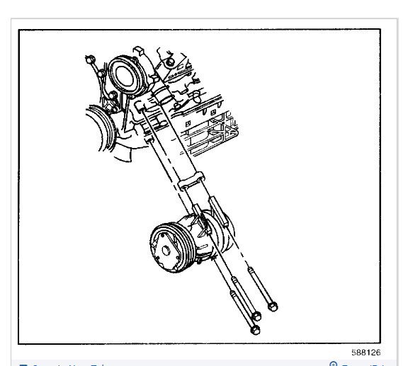

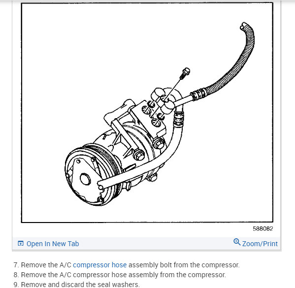

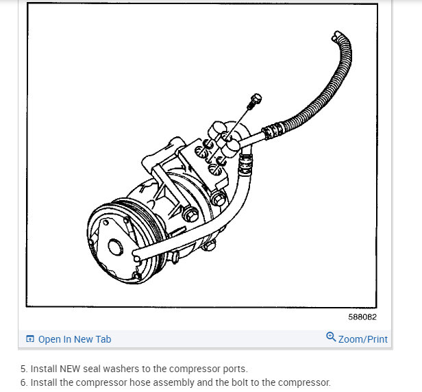

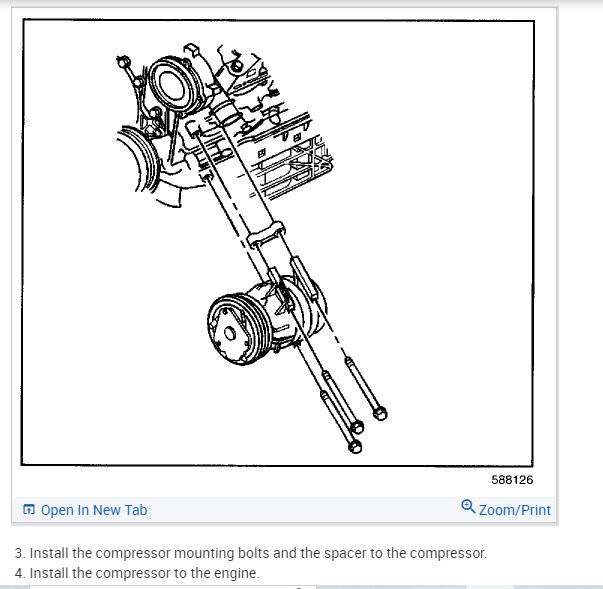

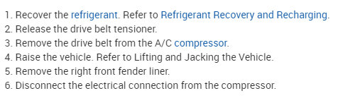

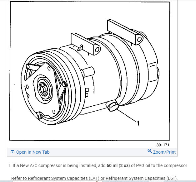

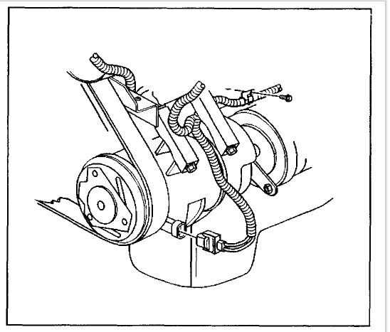

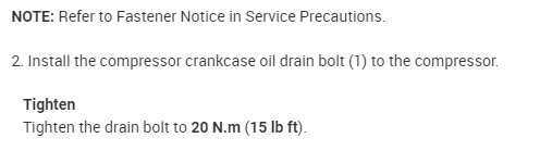

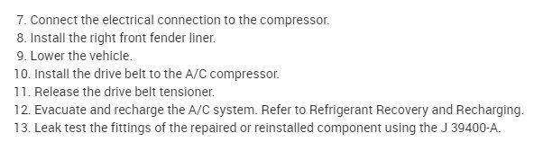

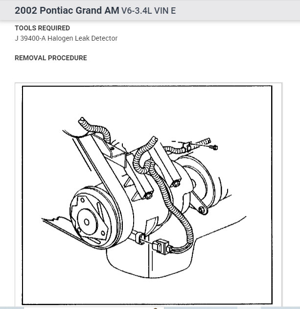

That isn't too far off. I would say it's still a little low on freon. At this point, my first suspect is the compressor is failing.
I don't know if you need them, check I attached the directions below for replacing the compressor.
Let me know if this takes care of the problem.
see pics below.

A/C compressor failed/locked up upon removal of old compressor, accumulator, A/C lines etc. No oil was found in the system, replacing with four seasons 58992 new compressor, accumulator, orifice tube, condenser etc. suction lines show visible leakage at crimps so new lines also, along with the 8 ounces of oil which i added through new compressor and accumulator. Thanks again for the replies! First compressor i ever saw to suddenly start knocking like a loose rod, lol.
