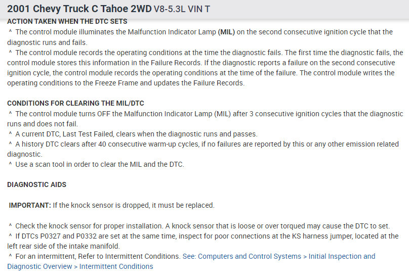

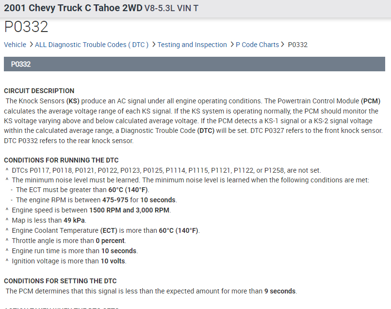

You could have that code triggered due to the sensor not getting propter voltage input or even having a bad connection.
Please note that many times you will get codes related to certain parts but the actual fault is not simply that part but could be due to other factors.

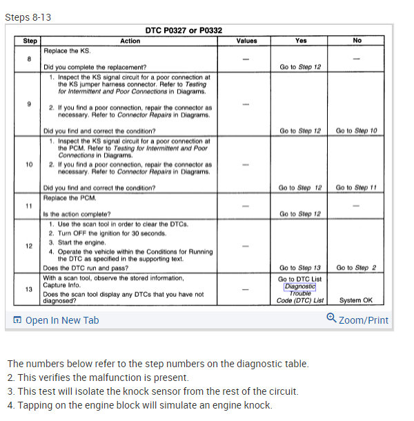

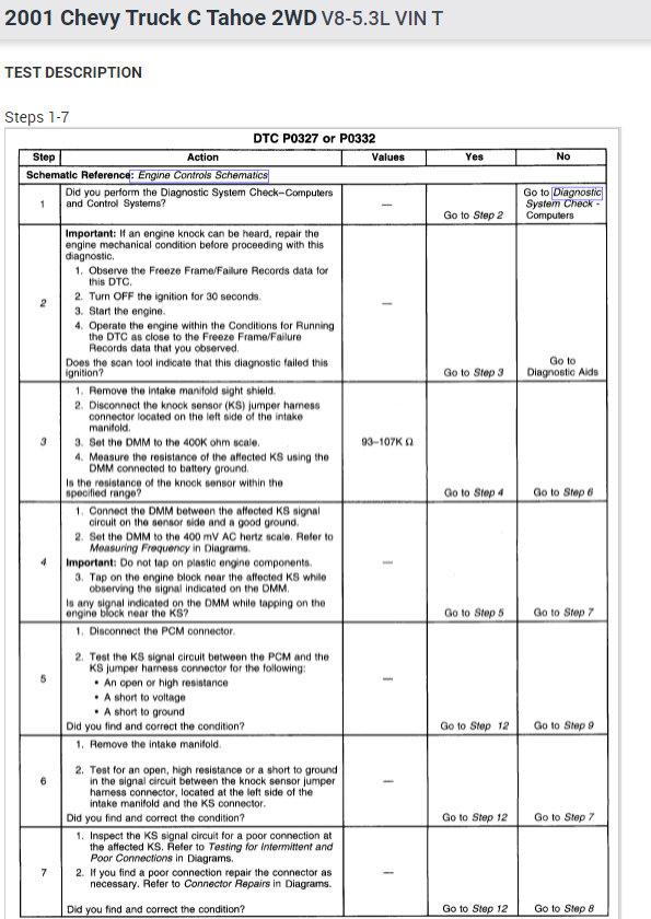

I have attached the diagnostics for the code P0332 (see below).
Go through that diagnostics and let me know what you find.
