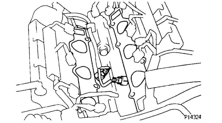

How many knock sensors are in my vehicle? And would they keep the car from running if one of them was coming up on code?
Jun 11, 2018 at 6:56 AM
Experienced Mechanic
52,796 POSTS
Good evening.
Yes, you have two of them. One for each bank. They are located under the lower intake manifold.
No, they will not cause a no start condition.
What happened that it is not starting?
