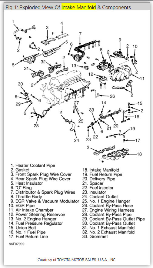

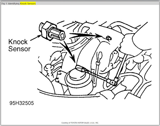

Where are the knock sensors located ? PO330 code is showing.
Sep 2, 2017 at 8:49 AM
Experienced Mechanic
55,682 POSTS
The knock sensor is located under the intake manifold which needs to be removed to replace the sensor.
Here is a guide and some diagram (below) so you can get the job done.
https://www.2carpros.com/articles/replace-intake-manifold-gasket
Please let us know what happens and upload pictures of the problem.
