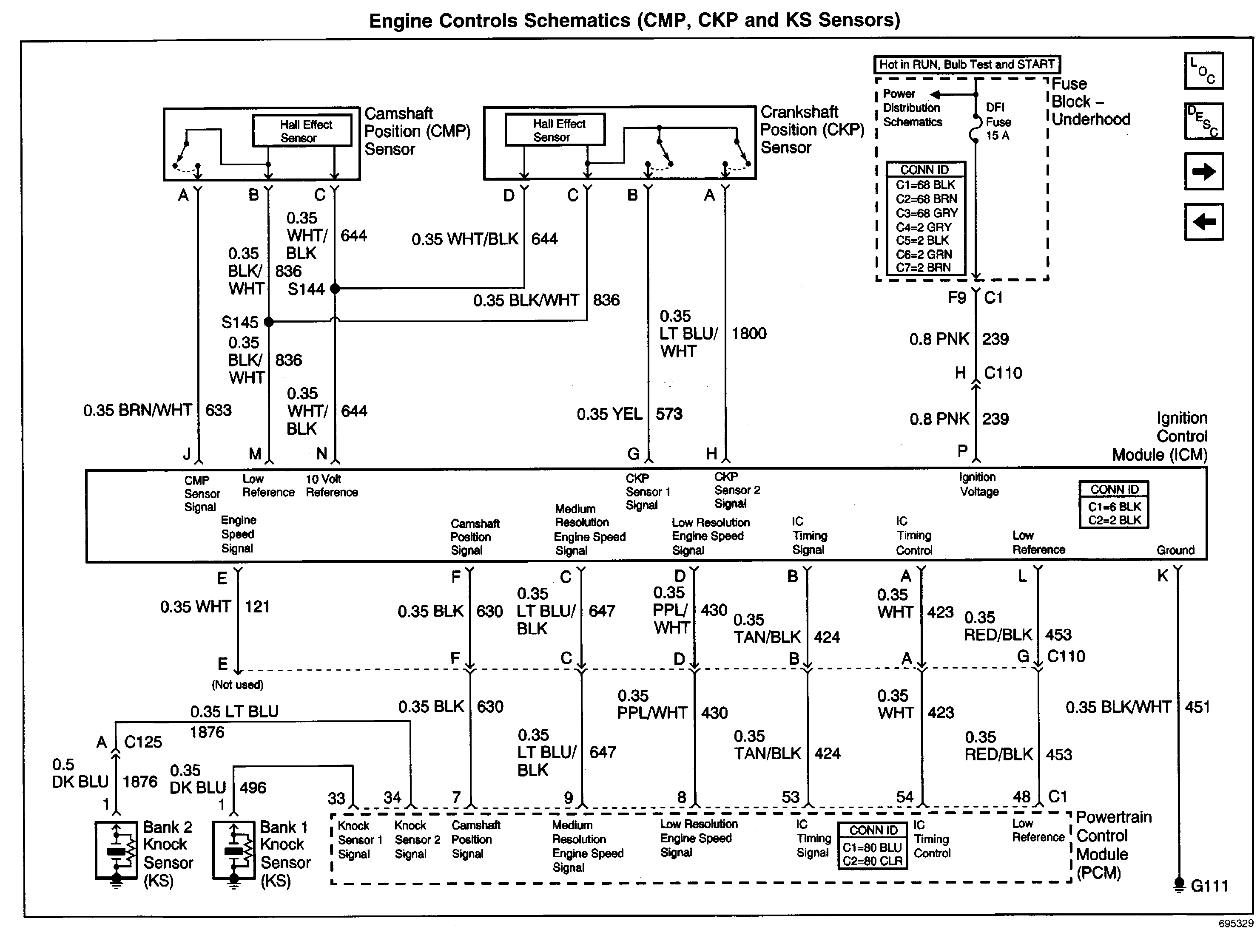

need wiring diagram for knock sensor 2001 buick regal 3.8
Aug 30, 2025 at 2:06 PM
MECHTRIX
  • 529 POSTS
Knock sensor wire diagram
Please click the image below
Aug 30, 2025 at 3:11 PM
