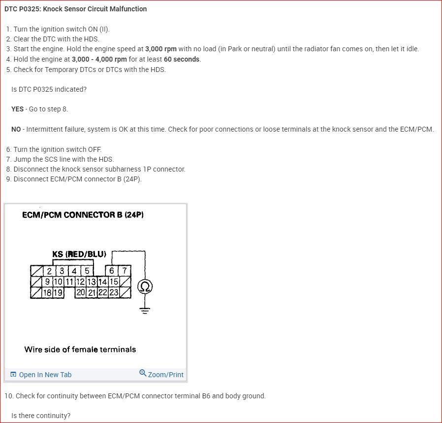

was replacing heater control valve middle firewall area , moved main harness out of way a bit , put everything back and took for a spin , P0325 knock sensor code
is there a diagram step by step replacement with torque specs etc.
also is there anything i should check before replacing the sensor ?
May 14, 2019 at 1:09 PM

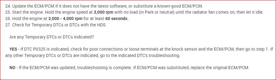

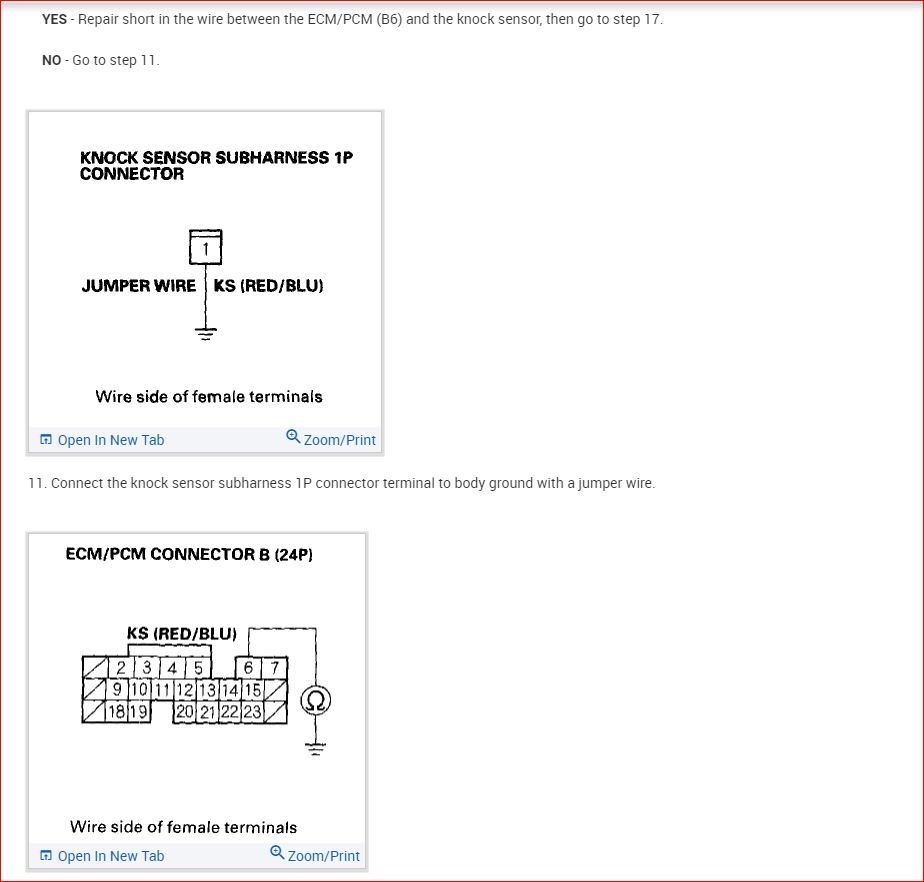

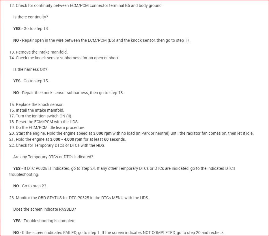

I attached the test procedure for this code. I would not just replace the sensor if all you did was move the harness. More than likely you just have a wiring issue or terminal issue in the connector. This test talks a lot about checking for continuity. This means do have a good wire or is there an open circuit. If you have a terminal issue in the connector, replacing the sensor will not fix it.
Further more, this DTC is for a circuit issue not necessarily a faulty sensor.

Thank you , you are right . It was the wiring there was rodent damage . I ordered the harness already .
I did a solder because the wire was too short from the brown connector side .
Will the solder patch job affect the resistance of the sensor itself ? And if so , should i avoid driving the car until i receive the part by mail?
May 17, 2019 at 9:59 AM
That is great that you found it. Solder itself will not affect the resistance as this is the preferred method of joining wires.
As long as you protected the solder with a heat shrink sleeve, you will be just fine. Solder just like the wiring itself is susceptible to the elements however, if you are going to change it all in a few days then you should not have any issues. At least I personally would not worry about it.
