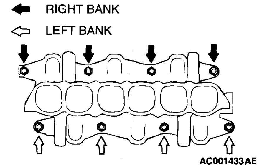

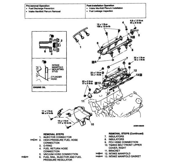

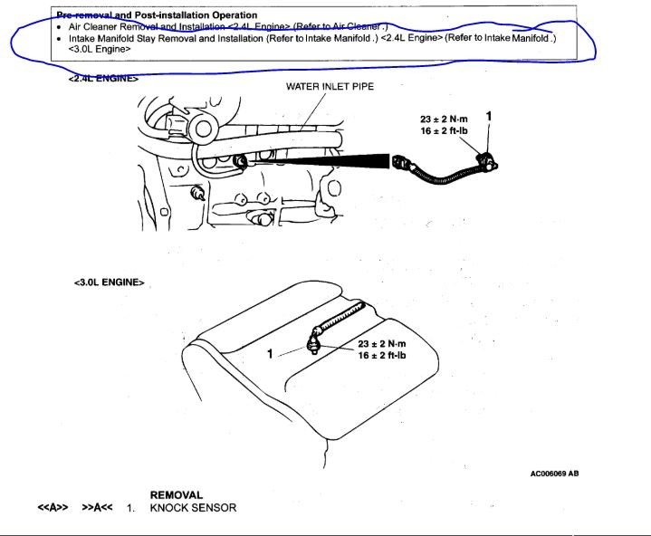

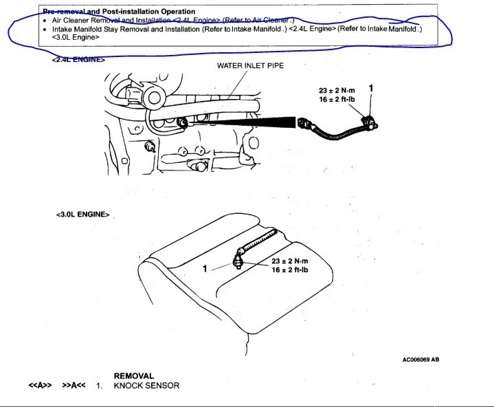

The lower intake manifold needs to be removed in order to access the sensor.

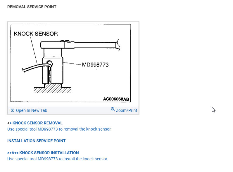

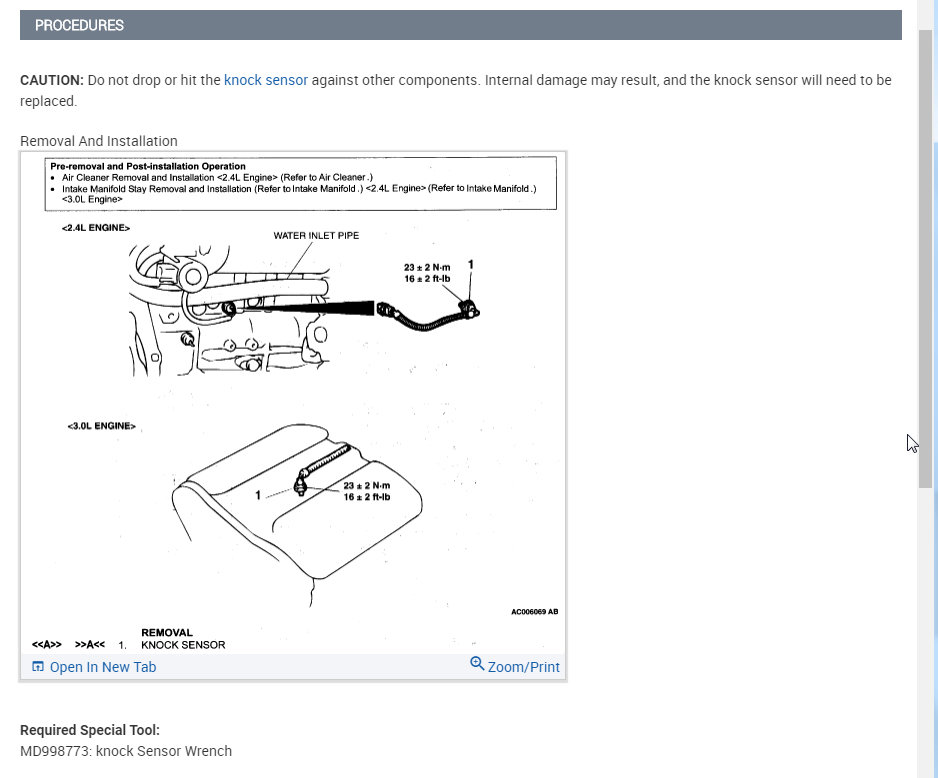

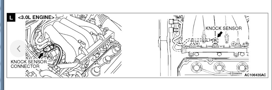

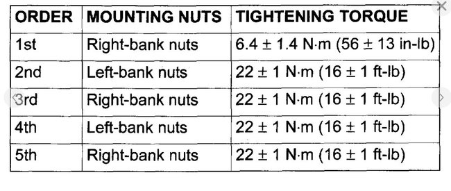

I attached the process for doing this. You need a special socket that has a cut out in it so the harness is not damaged when installing it. If you don't have this, you can pick one up at most parts stores. They are pretty common.
