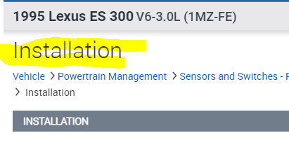

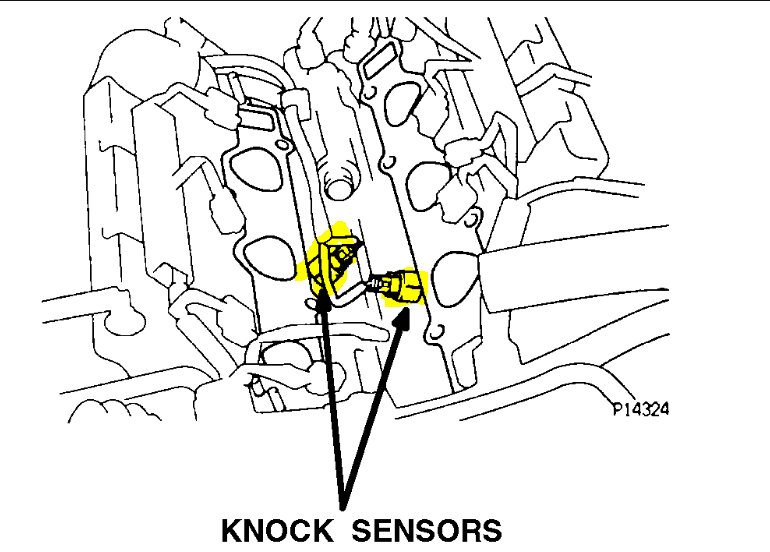

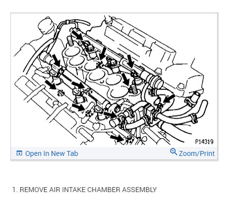

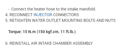

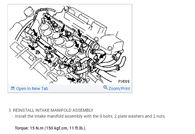

Are the knock sensors on the inside of the intake manifold or are they on the bottom of the motor by the oil filter?
Jun 22, 2023 at 4:37 AM
Experienced Mechanic
110,248 POSTS

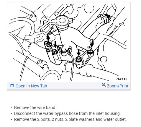

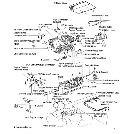

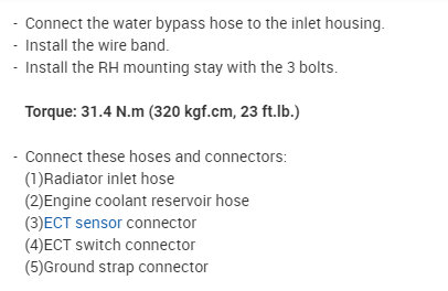

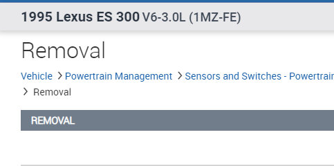

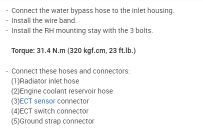

The knock sensors, two of them, are both located under the intake manifold. See pic 1 below.

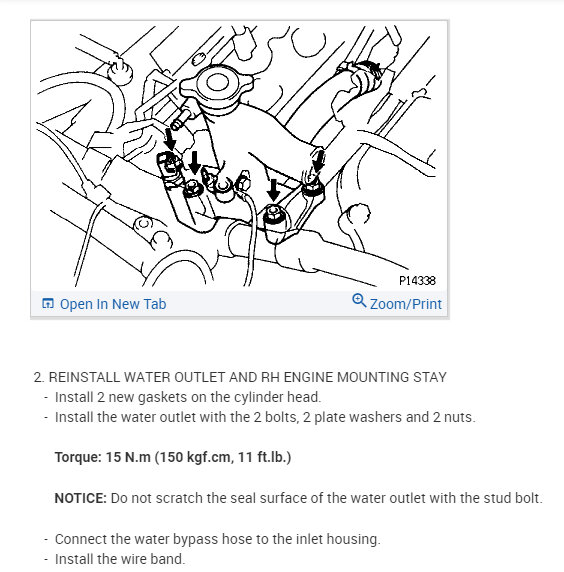

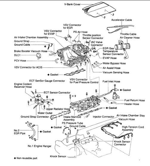

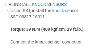

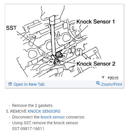

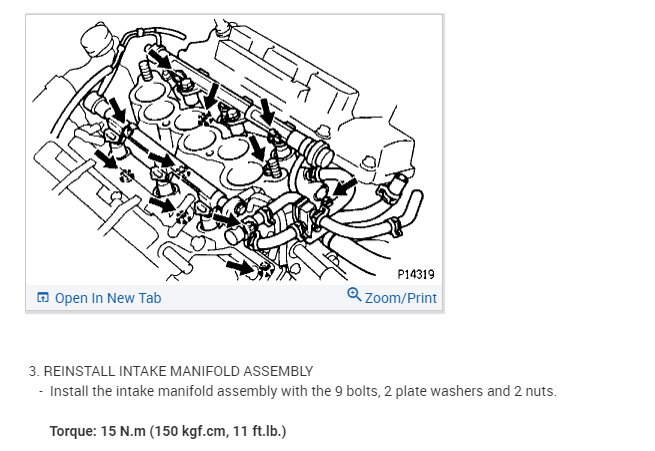

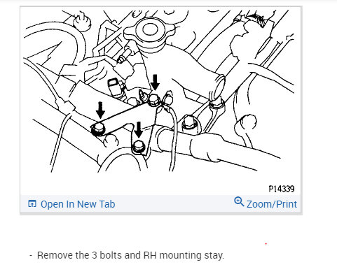

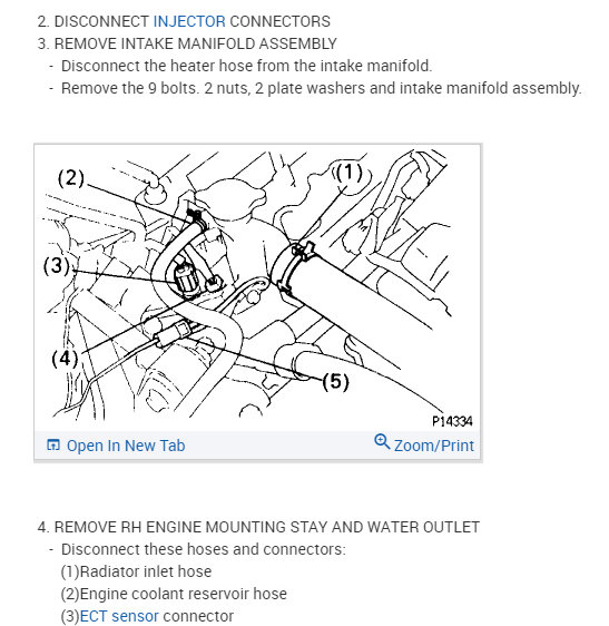

The remaining pictures are the directions for the removal and replacement of the sensors.
Let me know if this helps.
joe
