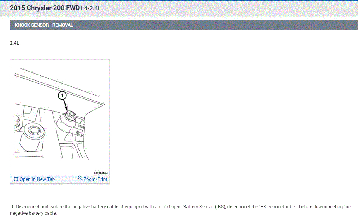

Where is the Knock sensor located?
2015 CHRYSLER 200
105,165 MILES • 2.4L • 4 CYL • 2WD • AUTOMATIC
HAPPY465

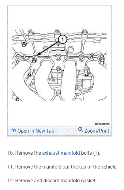

When I got on the part store website it said front location and rear location. Is there more than one knock sensor on this or is there only one and where is it located?
Jun 7, 2022 at 11:05 AM
  • 110,244 POSTS

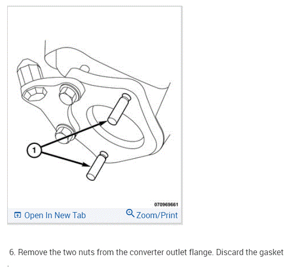

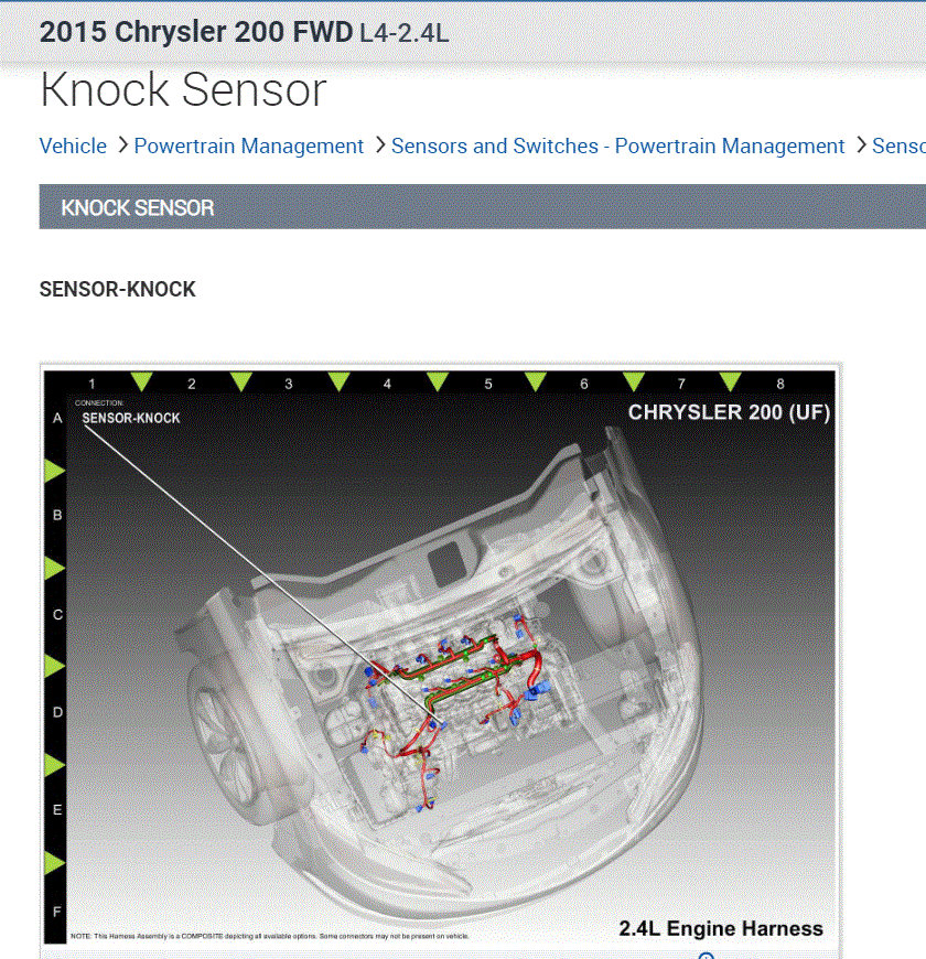

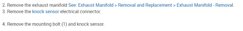

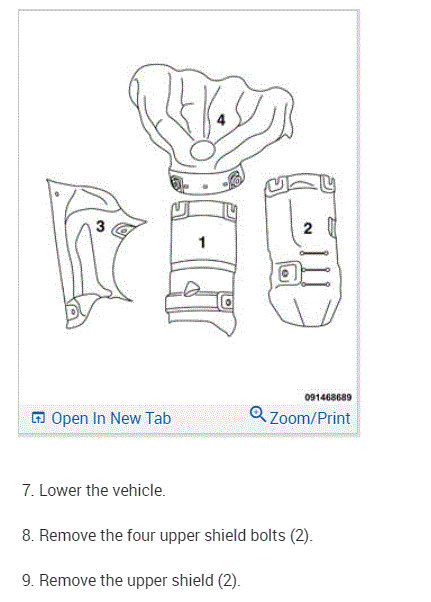

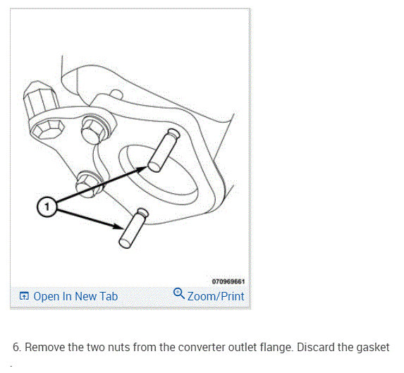

On the 2.4L there is only one. (See pic 1) it is located under the exhaust manifold. It does require the removal of the manifold to access it.

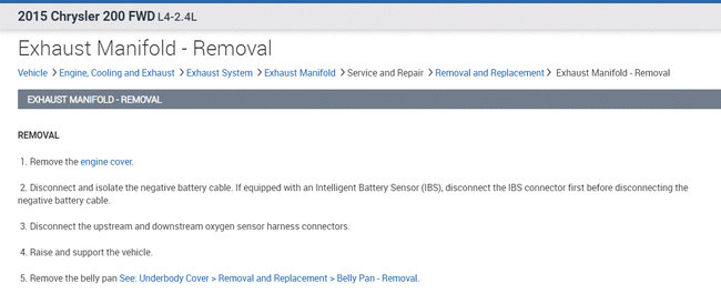

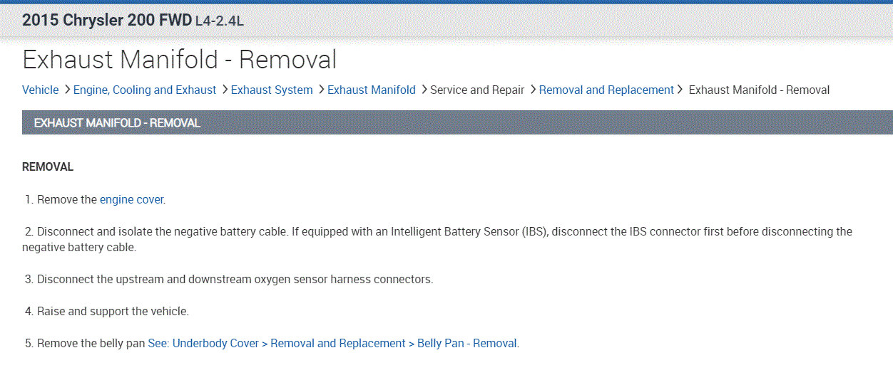

If you look at pics 2 and 3, they explain how to replace the knock sensor. The remaining pics are the directions for removing the exhaust manifold. Installation is the reverse of the removal process.
I hope this helps. Let me know how this turns out or if you have other questions.
