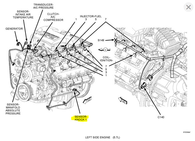

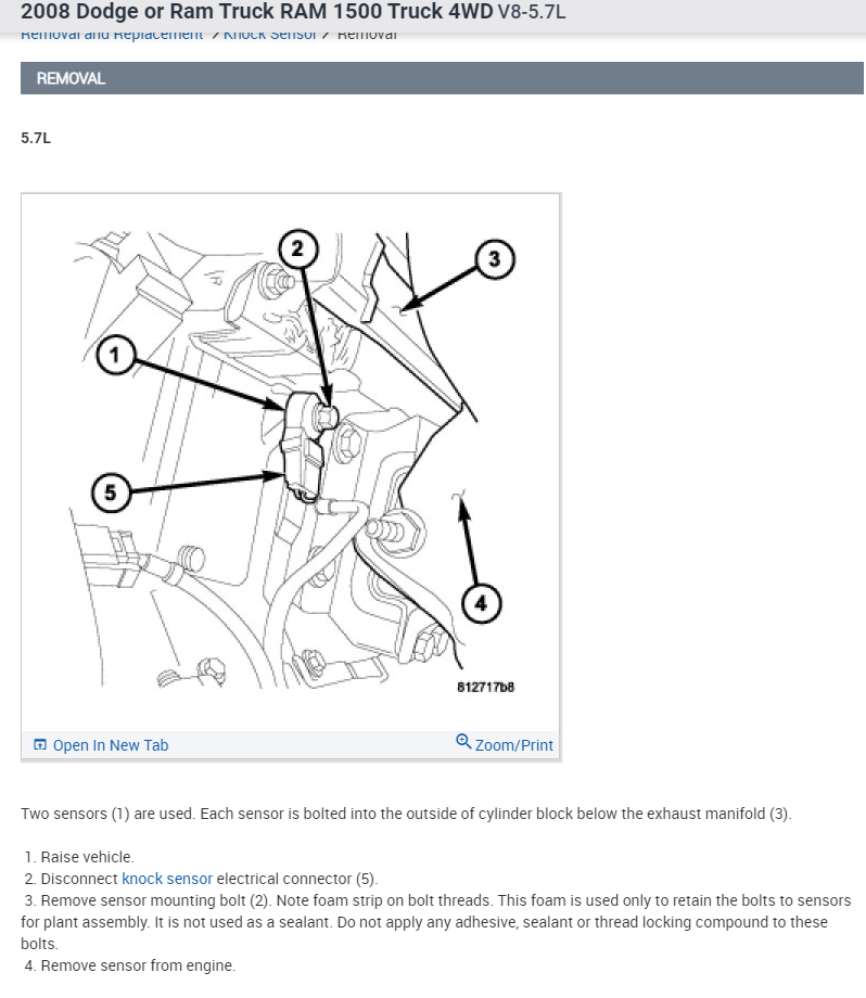

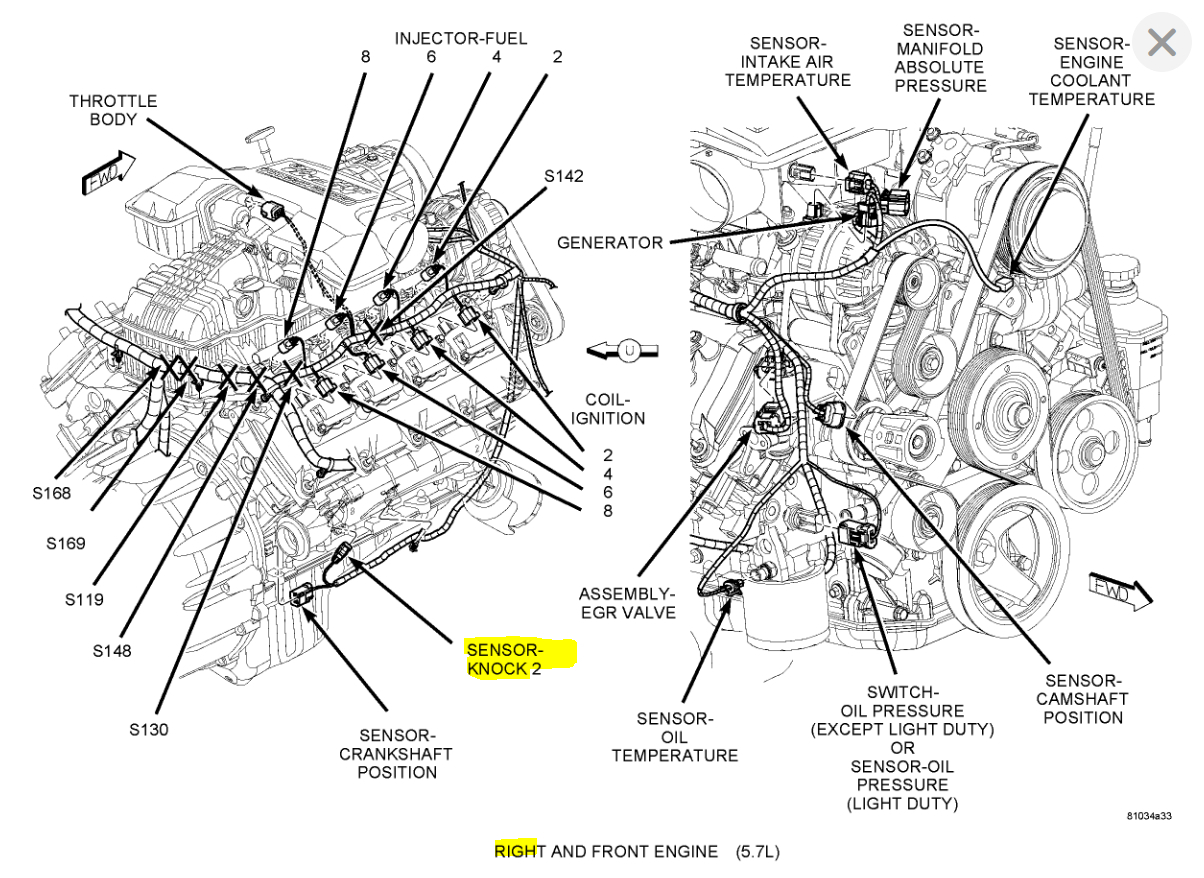

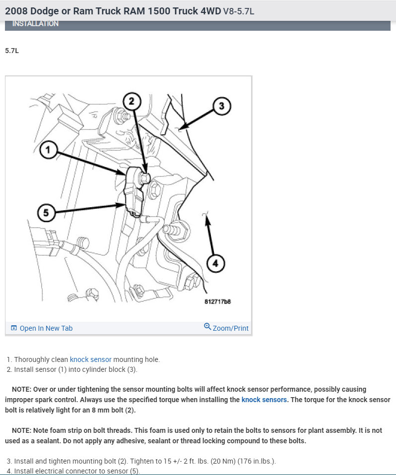

Do you have a diagram of where the knock sensors are located?
Sep 4, 2022 at 2:32 AM
SQM
Experienced Mechanic
6,383 POSTS
See attached diagrams for knock sensor locations as well as replacement procedure.
Let me know if you are able to find them or if you have any questions.
