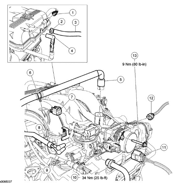

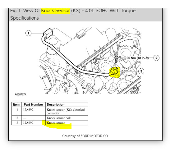

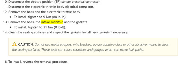

Where is the knock sensor located on the vehicle listed above (SOHC)?
Aug 10, 2023 at 2:09 PM
  • 110,241 POSTS

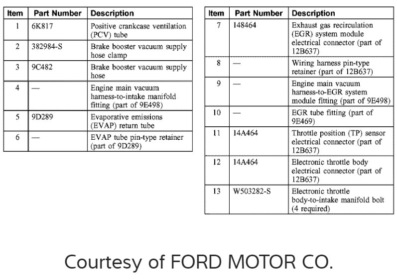

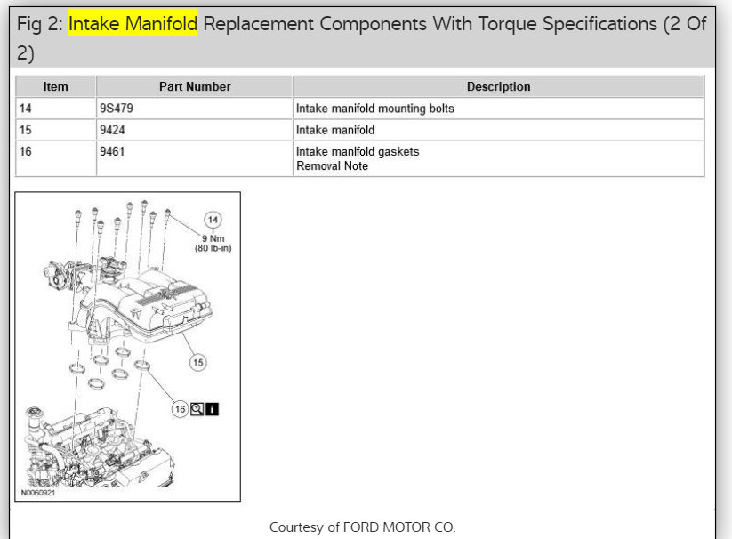

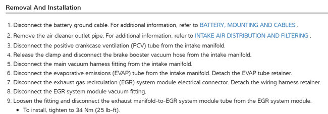

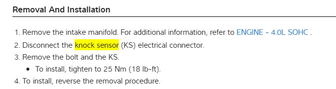

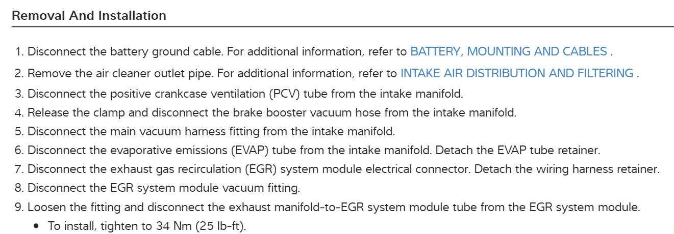

The knock sensor on this engine is under the intake manifold. See pic 1 below. Pic 2 is the very basic replacement directions. I included it so you have the torque specifications.

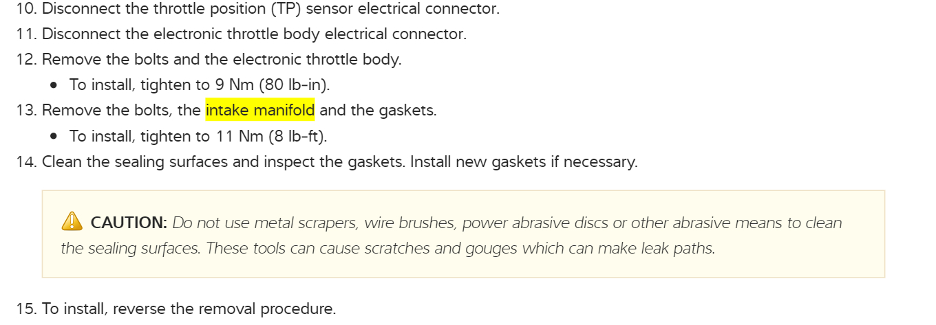

Now, the remaining pictures are the directions for removing and installing the intake manifold. Take a look through the directions and let me know if you have questions or if I can help in any way.
