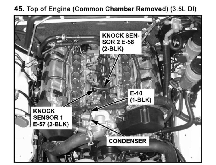

Good morning,

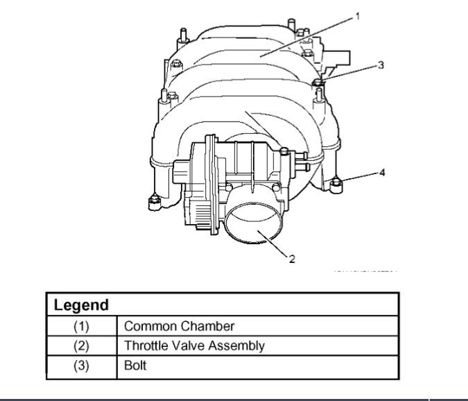

The sensor is under the intake manifold and then you have access to the sensor.
https://www.2carpros.com/articles/how-a-knock-sensor-works
I attached pictures and the procedure for you to view.

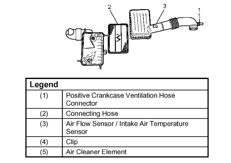

2. Disconnect air cleaner connecting hose.

7. Remove the four throttle body fixing bolts.
8. Remove common chamber four bolts and four nuts then remove the common chamber.

7. Install air cleaner connecting hose.
