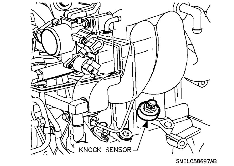

Where is the knock sensor located?

I attached a picture and the procedure for the knock sensor for you as requested.
Do you have a code for the sensor? if you do, what is the code?
REMOVAL
1. Turn ignition Off.
Caution: make sure the vehicle is properly supported and squarely positioned prior to lifting
2. Jack or raise vehicle.
NOTE: The connector must be removed by squeezing the sides. Apply pressure to sides of connector gently. Do not pull on wires.
3. Disconnect electrical connector from knock sensor.
4. Remove knock sensor.
INSTALLATION
1. Install knock sensor.
- Torque: 15 N.m (133 in-lbs)
2. Connect electrical connector to the knock sensor. Push in connector until a click is heard and pull back to confirm a positive engagement.
