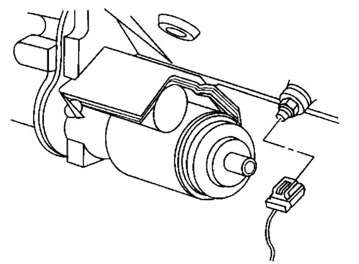

I have a ticking while idling and driving, and I also received a p0237 code for a knock sensor. Where exactly are the knock sensors located on this model? I was also wondering if a bad water pump can cause the ticking or failing spark plugs? Thank you.

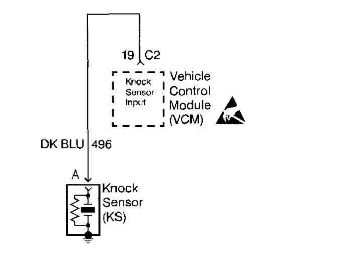

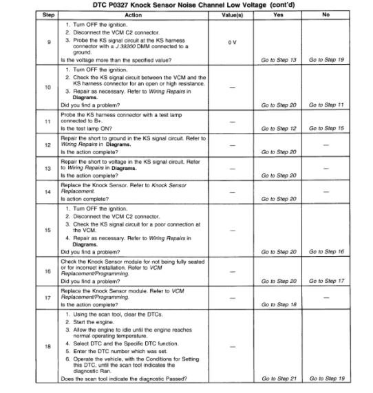

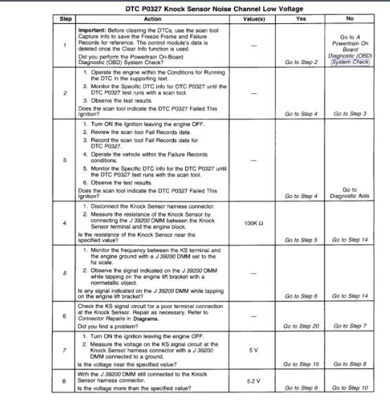

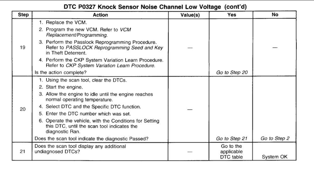

There is no 237 code but there is a 327 code for the knock sensor. I attached the flow chart and schematic for this code below for you to view.

REMOVAL PROCEDURE
CAUTION: Refer to Battery Disconnect Caution in Cautions and Notices.
1. Disconnect the negative battery cable.
2. Raise the vehicle.
3. Remove the Knock Sensor harness connector.
4. Remove the Knock Sensor (2) from the cylinder block (1).

Circuit Description
The Control Module (PCM/VCM) uses the Knock Sensor(s) (KS) in order to detect engine detonation. Ignition Control (IC) spark timing is retarded based on the KS signal input when spark knock is detected. The Control Module monitors normal engine background noise during warm engine operation. It stores these noise values for comparison to the current knock sensor signal to help discriminate between normal engine noise and knock. If the amount of noise is below the minimum stored noise value, this DTC will set.

Test Description
The numbers below refer to the step numbers on the diagnostic table.
2. Ensures that the condition is present.
5. Ensures that the knock sensor is capable of detecting detonation. Striking the lift bracket with a non-metallic object should produce a signal that the knock sensor should detect.
7. Ensures that the 5 volt reference is near the specified value without being more than 5.2 volts.

A common reason for that code is the wiring has rubbed through near the exhaust and it sends the wrong data to the ECM. I would check the harness for damage first.

Just like Steve said, check the wiring before replacing the sensor.
