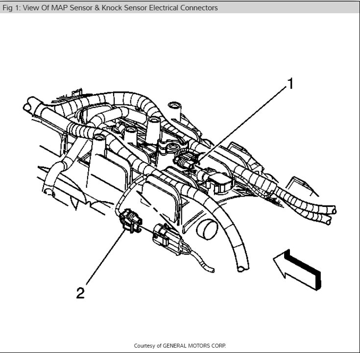

When very cold in the winter the engine would idle rough until slightly warm and go away, then it started happening in warmer weather but no code on the dash. I brought it to the shop and had them do knock sensors and intake manifold. Then it started throwing a code for faulty knock sensor, the shop did the repair twice using ACDelco parts. The code still comes on, any help would be greatly appreciated. The code comes on after the second day after the repair.

Codes were P0332, even when sensors switched it through the same code, no coolant loss to the best of my knowledge.

So, this code P0332, is refereeing to the signal being low that it is putting out to the PCM on bank 2 only. This is the rear sensor.
If both sensors were faulty, you should have a code for bank 1 which is P0327.
Some causes include:
Bad Sensors
Coolant system issues
Lean Air/ Fuel mix
Exhaust Gas Circulation (EGR) System issues
Bad wiring
I am leaning towards a wiring issue myself.

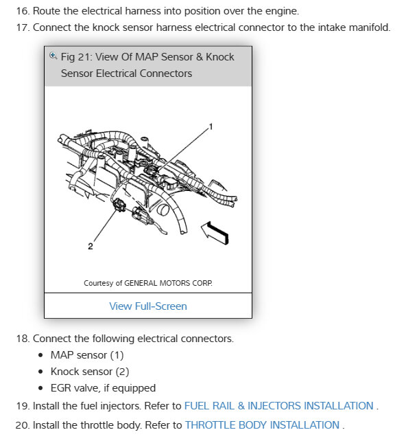

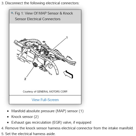

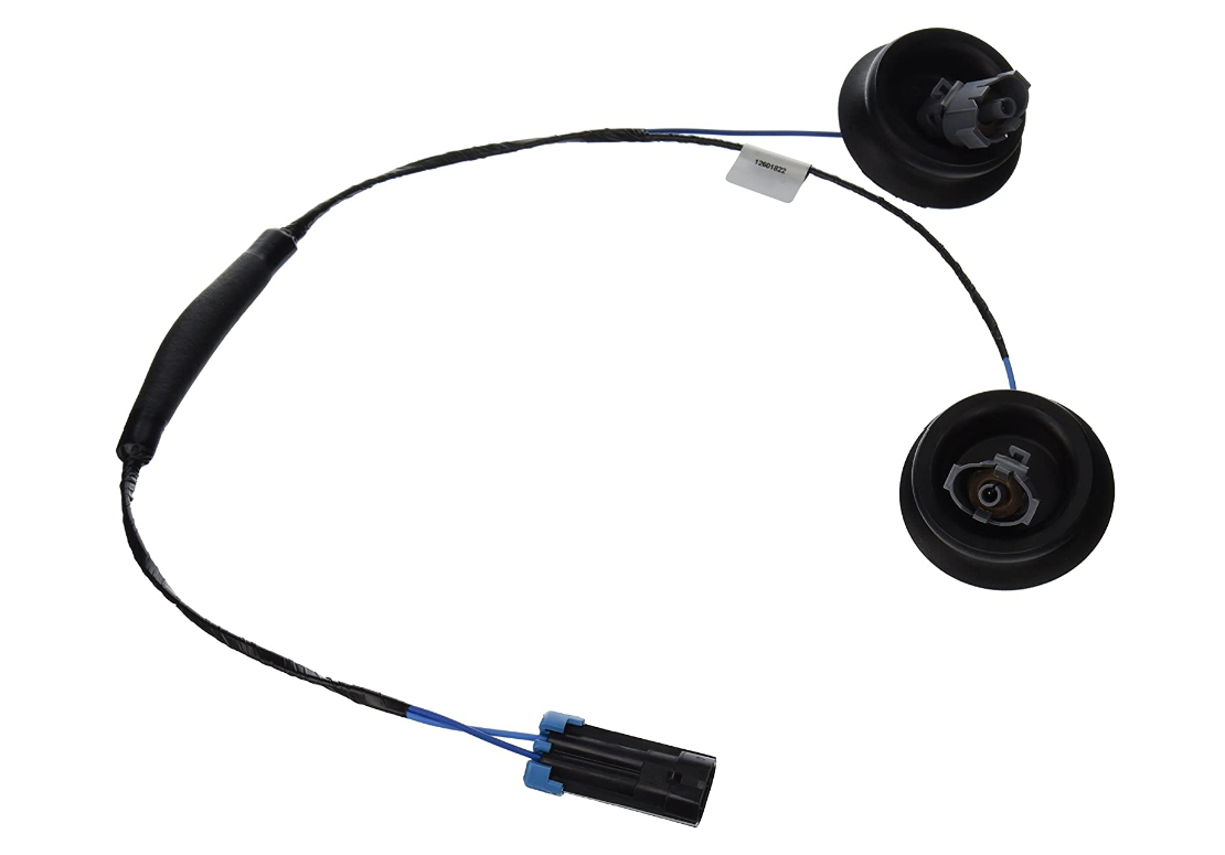

Was the harness ever replaced when they did the sensors?
Since the sensors were replaced twice with OEM sensors, I think something else might be going on. Since you mentioned it has gotten worse over time it is possible it is a corrosion issue as we all know corrosion happens over a period of time, so it would make sense.
Now these sensors are very fragile. All it takes is for the parts guy to drop in the store and its junk. But for this to happen twice with 4 separate sensors seems a little unlikely to me.

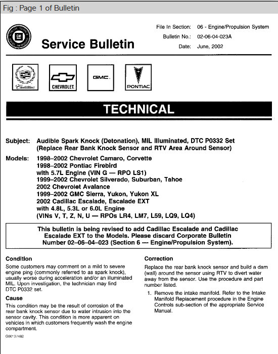

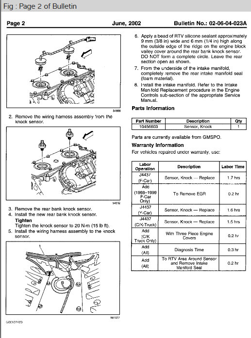

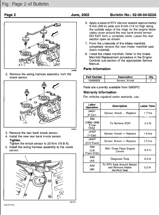

There was a Technical Service Bulletin (TSB) put out in June of 2002. The problem was water intrusion into the rear sensor. The fix was to replace the rear sensor and add RTV around the entire hole to act as a dam for any water that might end up in that area. I will add the TSB for you.

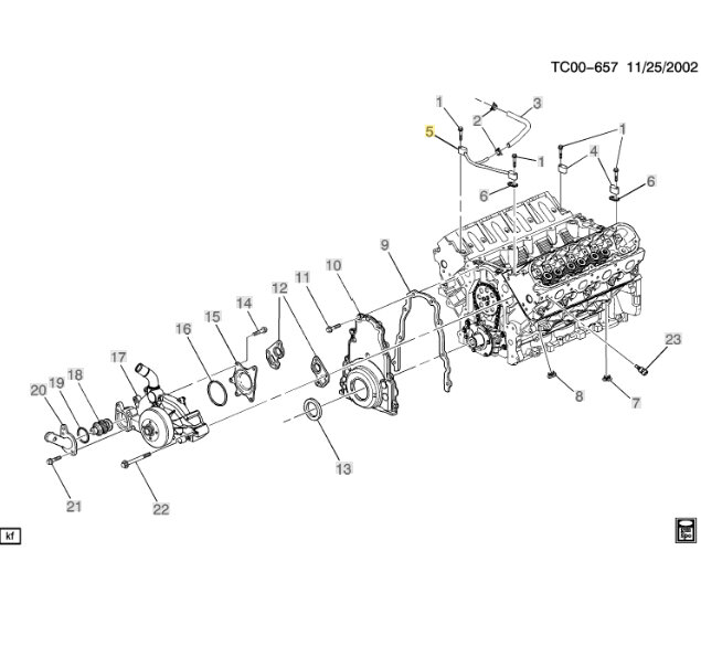

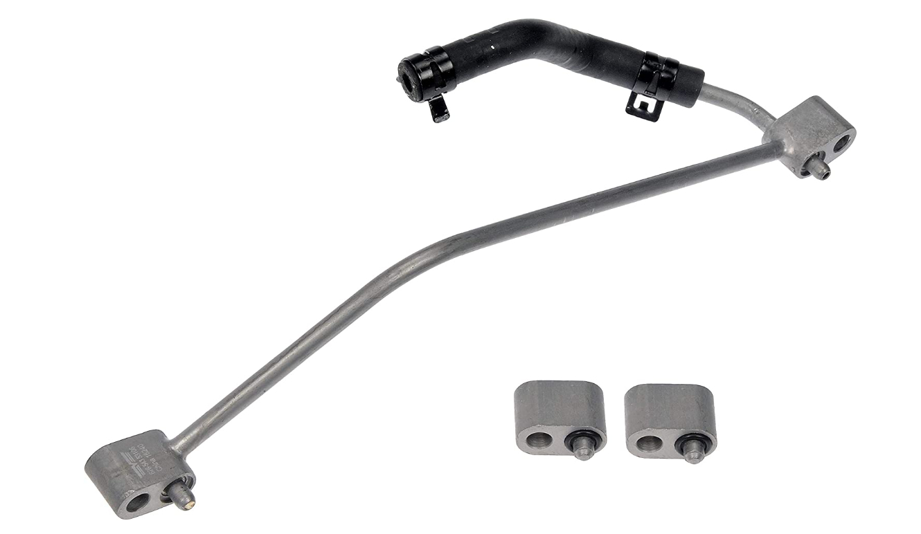

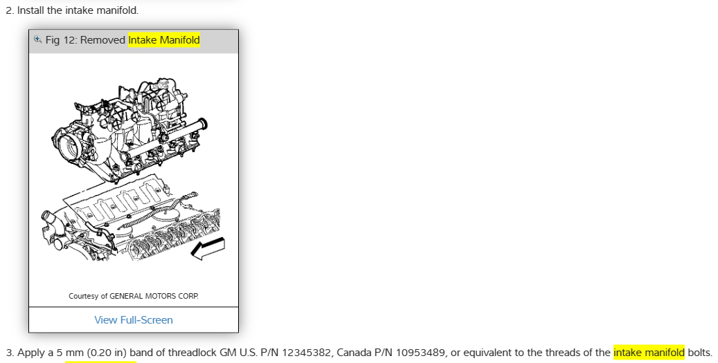

Another thing that would happen is the coolant bleed pipe that goes across from one head to the other would rot out and leak some coolant causing the same issue. I will add a picture of what this pipe looks like. Its purpose was to allow air trapped in the system to move into the bleed pipes so that coolant will reach the top of the head. The picture I have added is a redesign. Usually, it goes to each corner of the heads, but it should give you an idea what I am talking about.

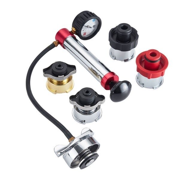

You can test for any leaks pretty easily with a coolant pressure tester that you can rent at an auto parts store. It is possible it might be leaking and getting on the sensors.
Here is an article on how to do this test:
https://www.2carpros.com/articles/radiator-pressure-test
When you do the pressure test you can look under the center of the intake with a light and see if there are any leaks.

1) I would replace the harness going to the sensors if you haven't already. I would go right to the dealer with your VIN.

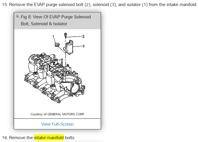

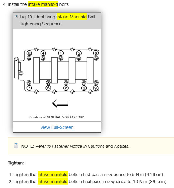

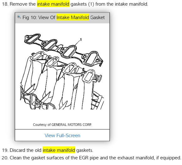

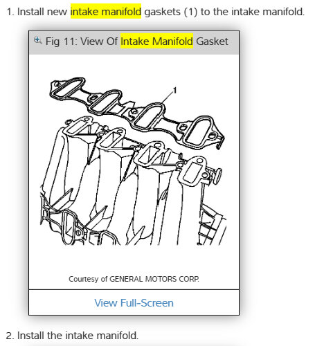

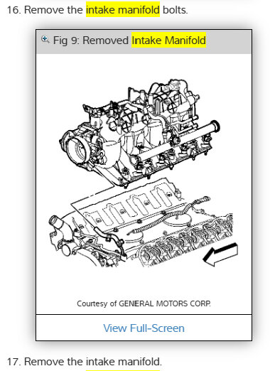

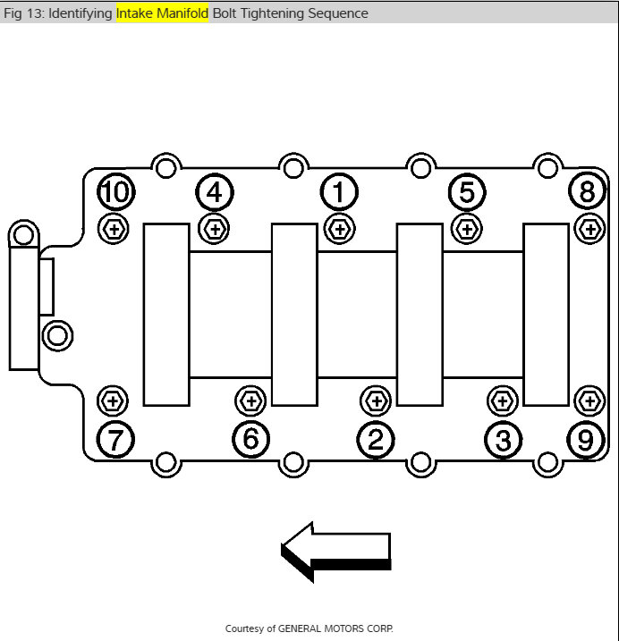

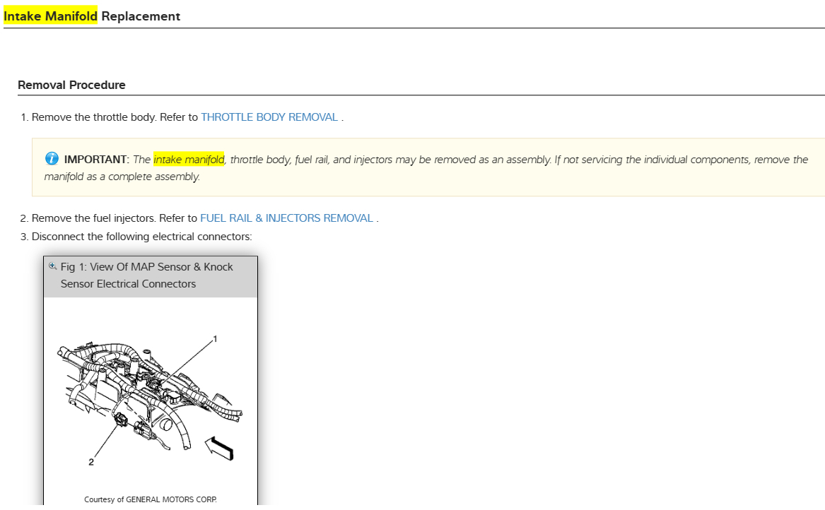

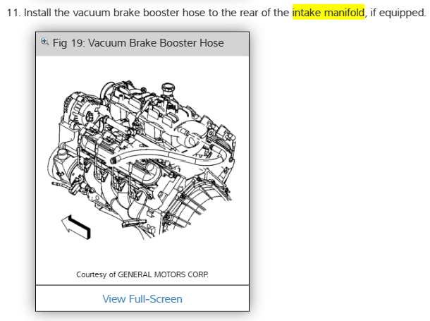

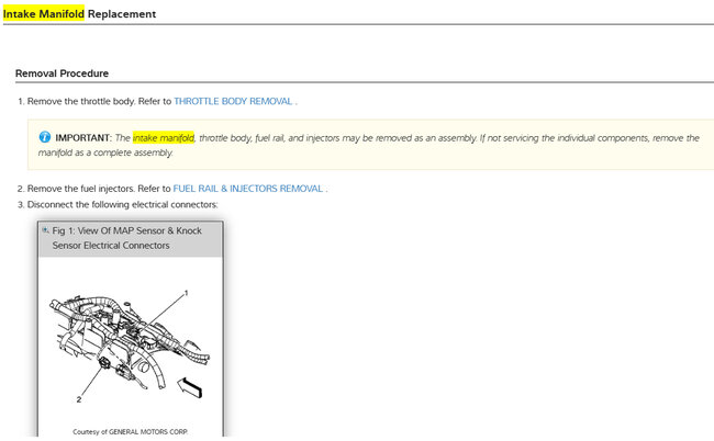

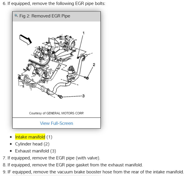

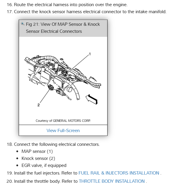

4) Look over the TSB, but I would put RTV around both holes not just the rear. Unfortunately, the intake will have to be removed again. I know you had a shop do the intake before so I am not sure if you will be taking it back, but I will include instructions on how to remove and replace the intake manifold in case you need it.

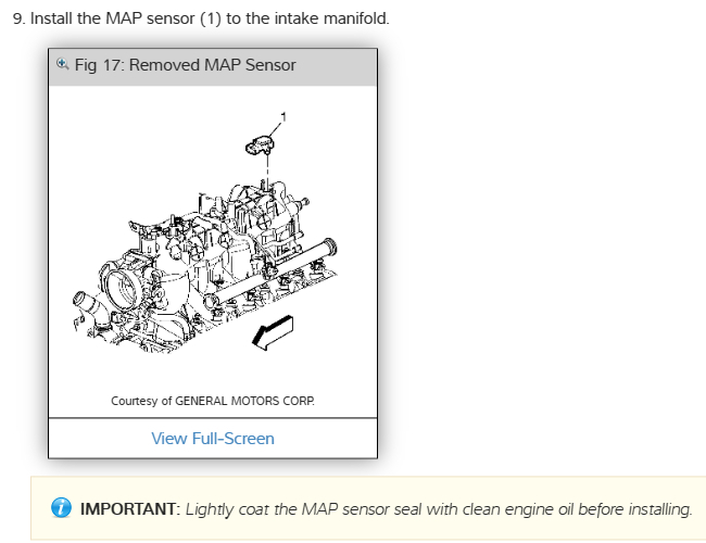

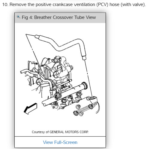

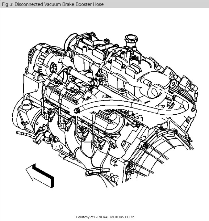

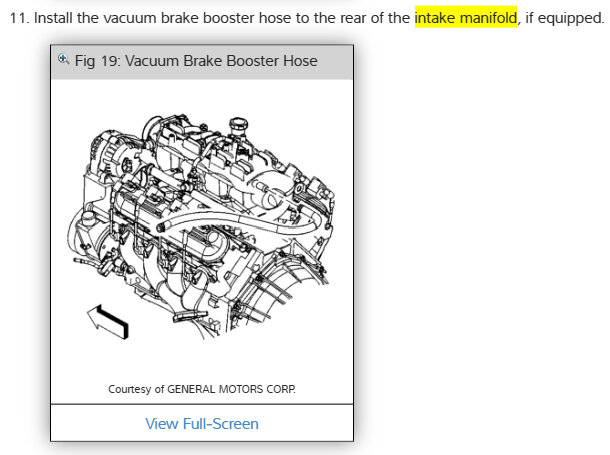

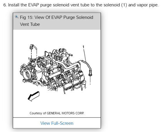

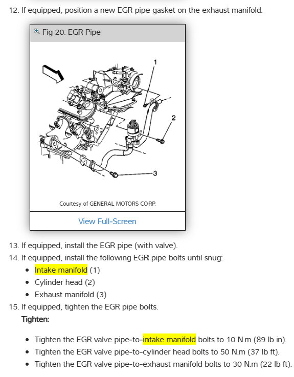

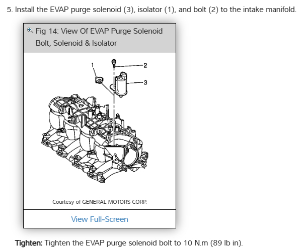

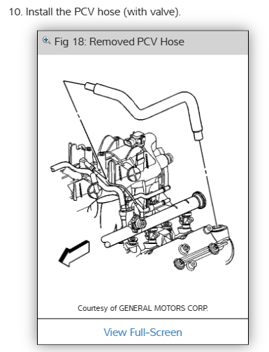

If you remove the intake here are some tools and notes for that:
The throttle body, fuel rail, injectors and MAP sensor can all be left in place.
You will need:
In. lb. torque wrench
Blue thread lock (Permatex is a good brand.)
Clear RTV
New intake gasket
EGR valve Gasket

I think for now is to replace the harness to rule out corrosion at the sensor connectors, Put on RTV around both Knock Sensor holes to prevent further water intrusion if that is what is going on, pressure test the cooling system and run some octane booster through your fuel system.
