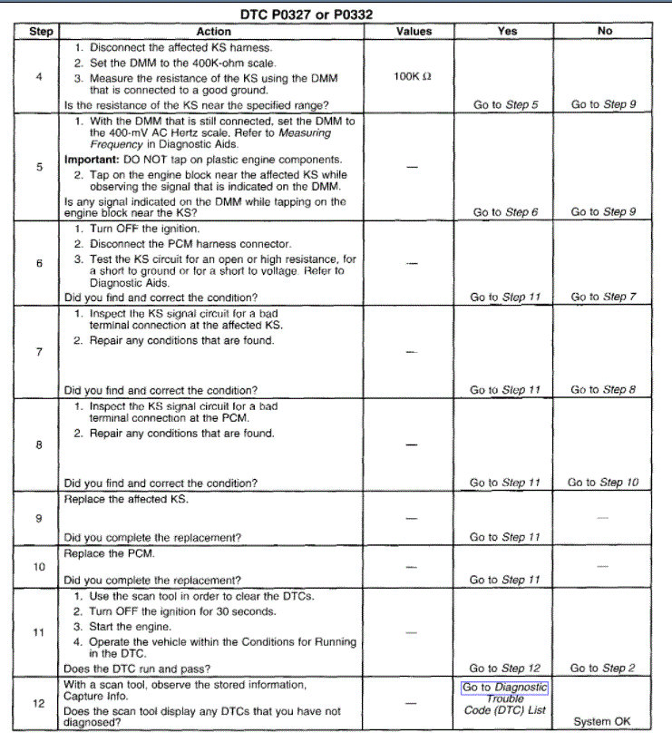

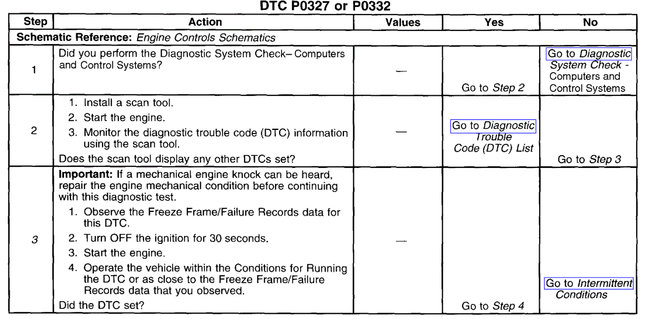

Has the knock sensor been replaced? Is the P0332 the only code present?
As far as the light, clear all codes and drive it until either one monitor is not reset. Hopefully, the knock sensor will be part of the last monitors to set. Once there is one left, get it inspected before the light returns.
However, please understand, the sensor may be part of the first monitoring system to reset and turn the light right back on.
Let me know if there are additional codes. Hopefully, we can just fix it, so you don't have to worry about the issue.
Also, take a look at the two pics below. Let me know if it is something you are comfortable doing. It is the diagnostics for the P0332.
Take care of yourself,
See pics.
