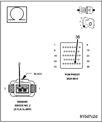

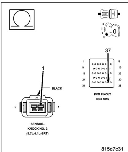

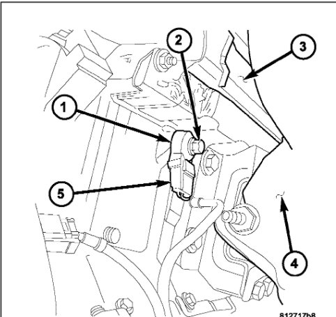

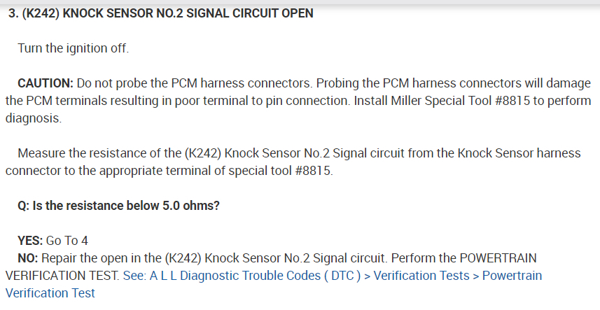

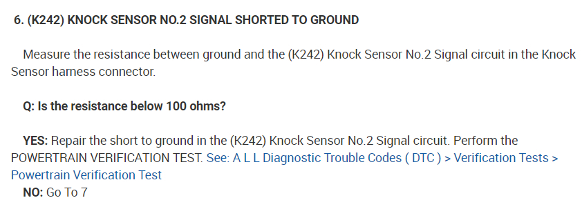

Hi, I was hoping someone could tell me about a faulty knock sensor on a 5.7 hemi. it's gave me a trouble code of p0330, it's been accelerating kind of funny sometimes too. sometimes it feels like it pulling a heavy trailer on takeoff, other than that the engine runs and idles smooth. is this something fairly easy to replace myself or should I have a shop do it? And is it okay to drive it like this for a little while? Thanks in advance!
Sep 28, 2020 at 11:39 AM
DANNY L
  • 5,648 POSTS

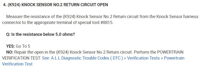

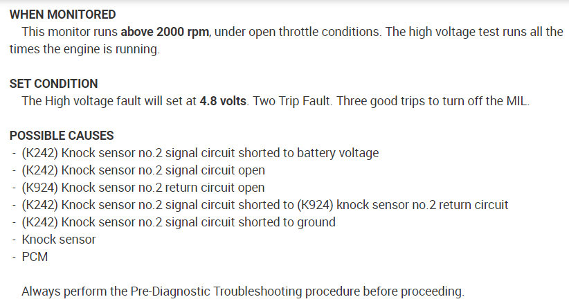

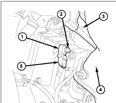

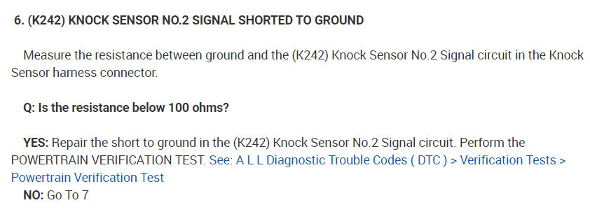

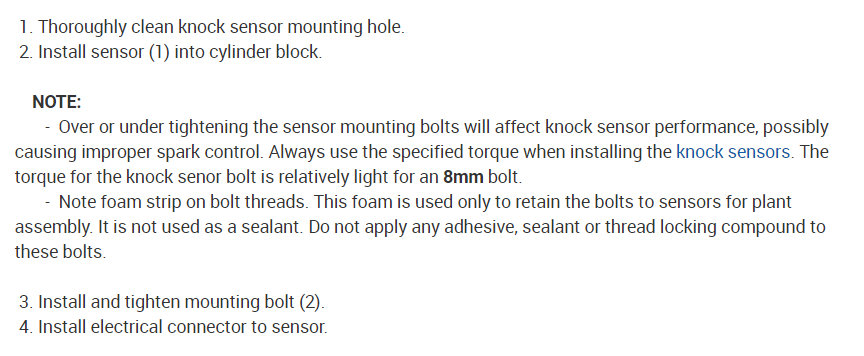

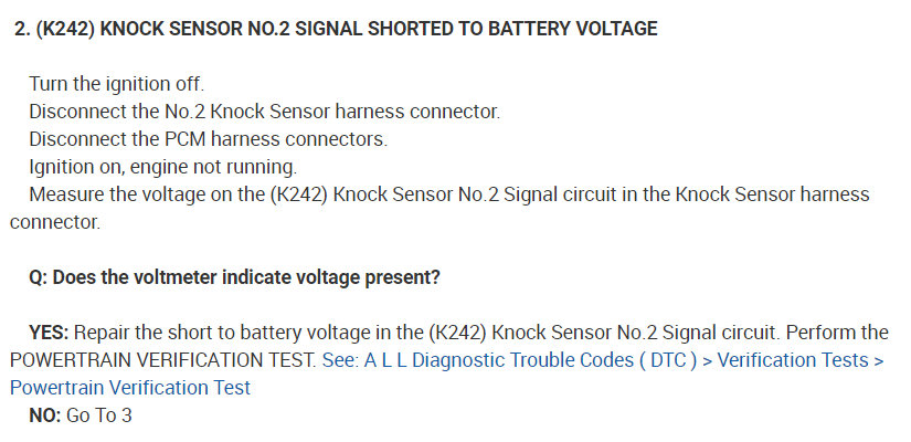

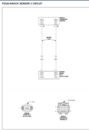

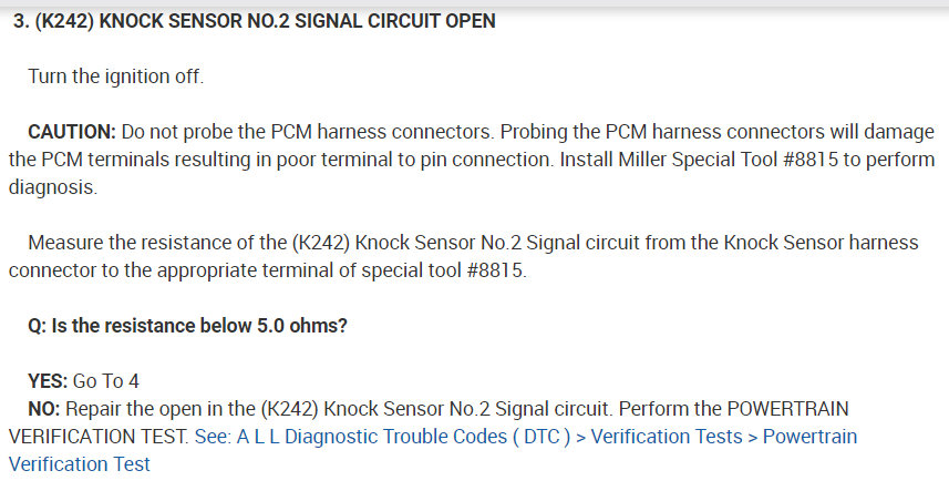

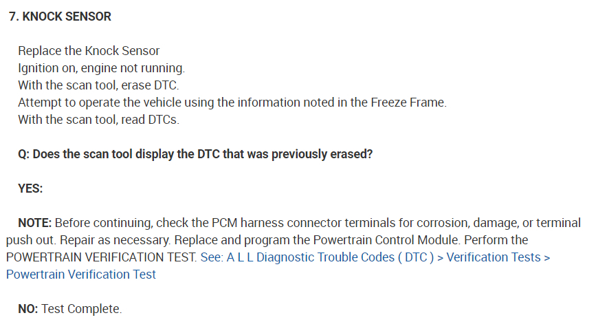

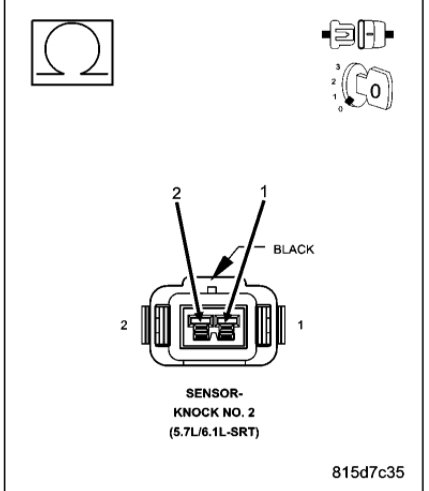

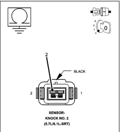

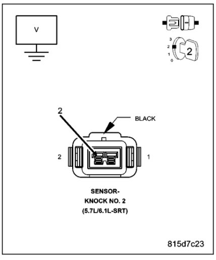

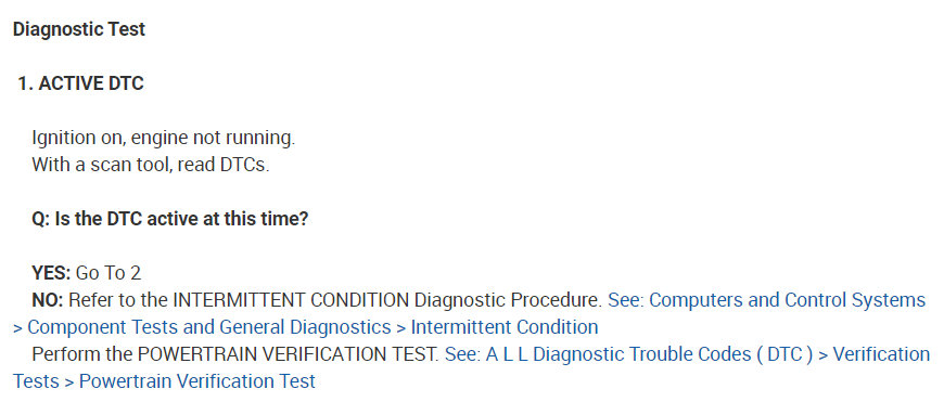

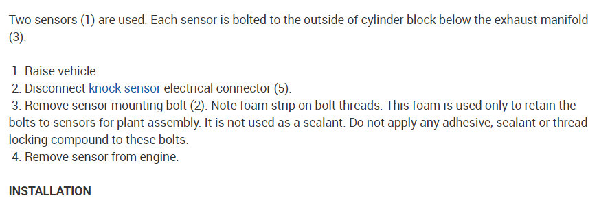

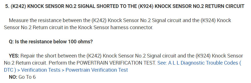

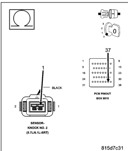

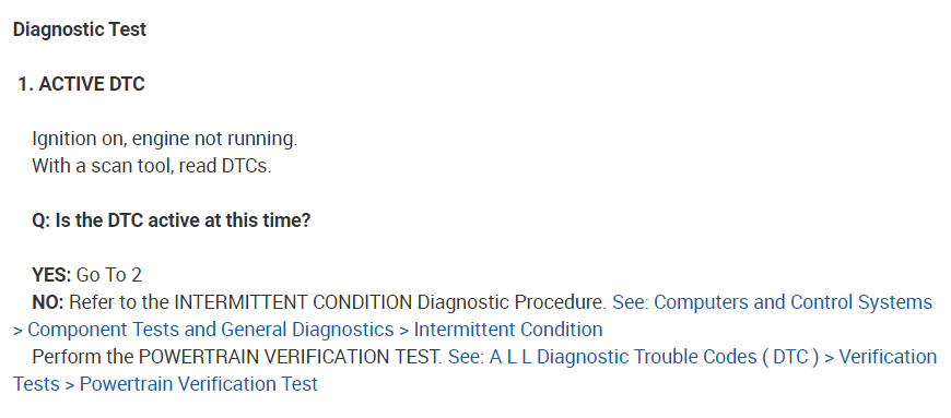

Hello, I'm Danny.
I've attached diagnostic steps below for code P0330 you mentioned. Replacement is fairly easy for the knock sensor. I would fix sooner than later as having a smooth running car gives better performance and gas mileage. Here is a tutorial showing what is involved for knock sensor replacement:
https://www.2carpros.com/articles/how-a-knock-sensor-works
I've also attached steps below for knock sensor replacement for your car. Hope this helps and thanks for using 2CarPros.

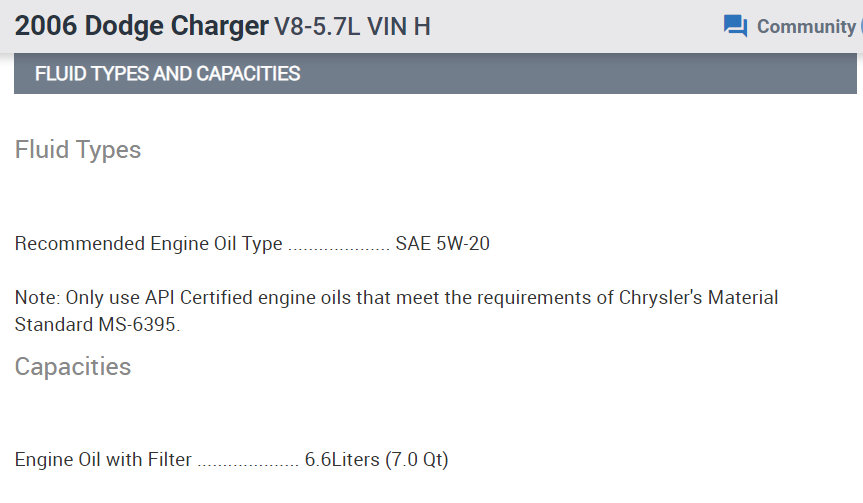

Sorry it has been awhile. I still have the trouble code for wrong oil type. I checked with the dealership on the type of oil it's supposed to have (i.e. conventional, synthetic etc.) and they looked it up and they said it calls for conventional. so what should I do? Could it be a sensor? Thanks!
Jan 10, 2021 at 12:34 PM

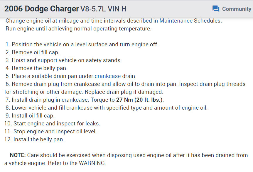

DANNY L
  • 5,648 POSTS
Hello again.
Yes, having the wrong engine oil can wreak havoc. The oil that is required for your for your 2005 Dodge Charger 5.7L car is 5W-20 conventional oil. Yes, it does make a difference and I've had to go through with this with a 2005 Honda Accord I'm driving now having the wrong type of engine oil until I changed it -the oil- and got the car to run right including the check engine light being on. Funny, how just engine oil oil can mess things up. Here is a tutorial showing how to change engine oil with filter:
https://www.2carpros.com/articles/how-to-change-engine-oil-and-filter
I've attached 2 pictures below. Let us know how things are going and if you have any further questions on this issue. Hope this helps and thanks again for using 2CarPros.

When I went to have it changed on the 4th I made sure that's what they were putting in it, as far as I know it's running the same as always. I feel the engine vibrate like something is kicking on then off at say a stop light. I figured it's the mds, other than that it runs good.
