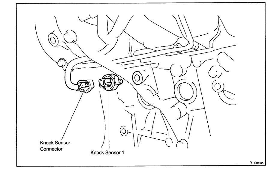

Where is the knock sensor on the vehicle listed above? Do you have a diagram to show where it is and what are the years that are the parts alike?

Good afternoon,
I attached the location of the sensor for you.
Why are you replacing the sensor? Do you have a code?
https://www.2carpros.com/articles/how-a-knock-sensor-works
Knock Sensor
The knock sensor is fitted to the cylinder block to detect engine knocking. This sensor contains a piezoelectric element which generates a voltage when it becomes deformed, which occurs when the cylinder block vibrates due to knocking. If engine knocking occurs, ignition timing is retarded to suppress it.
