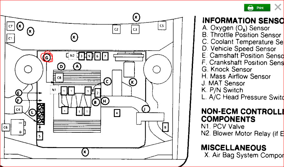

I ran the trouble codes and got code 43. Now I am trying to figure out the location of the knock sensor.

The knock sensor is located on the lower right side of engine, near oil filter. I have attached a tutorial and picture as well. Hope this helps and thanks for using 2CarPros.
