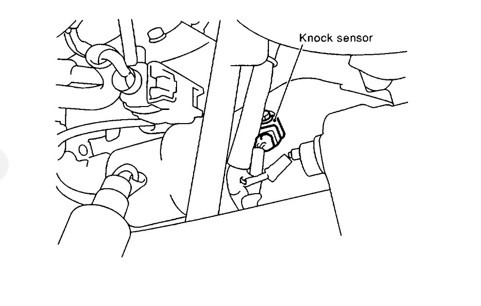

Where is the knock sensor located on my car?I want to change it.

It is located on the right side of the engine block below the intake manifold.

Do you have a exploded picture of its location?

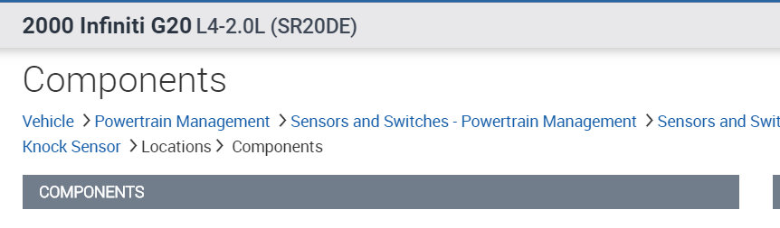

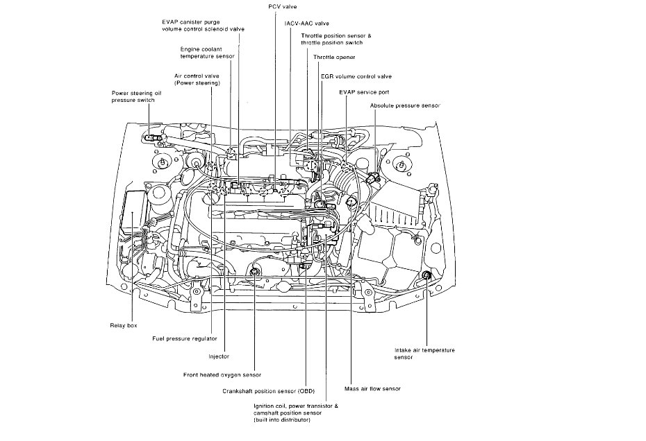

I have included the information that you requested in the diagrams down below. I have also included a diagram of all of the other engine sensors on your vehicle for you as well. I hope this helps.
