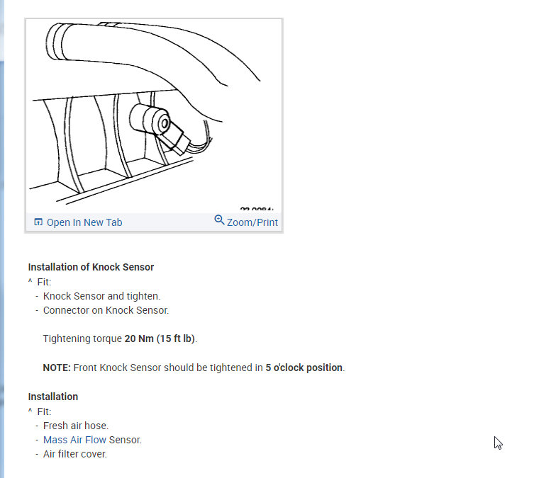

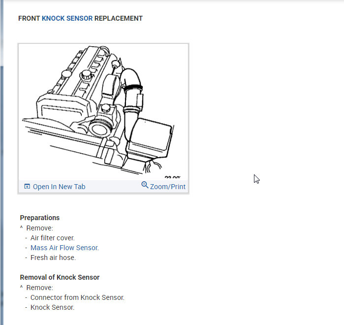

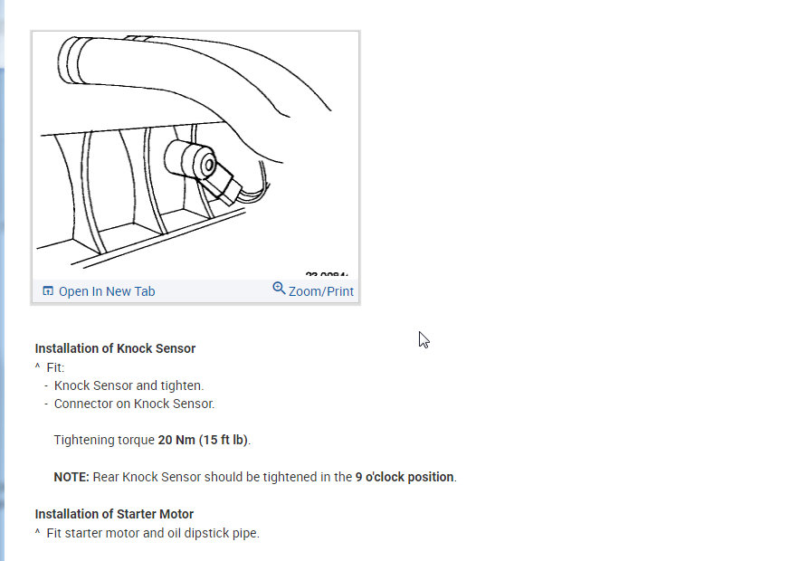

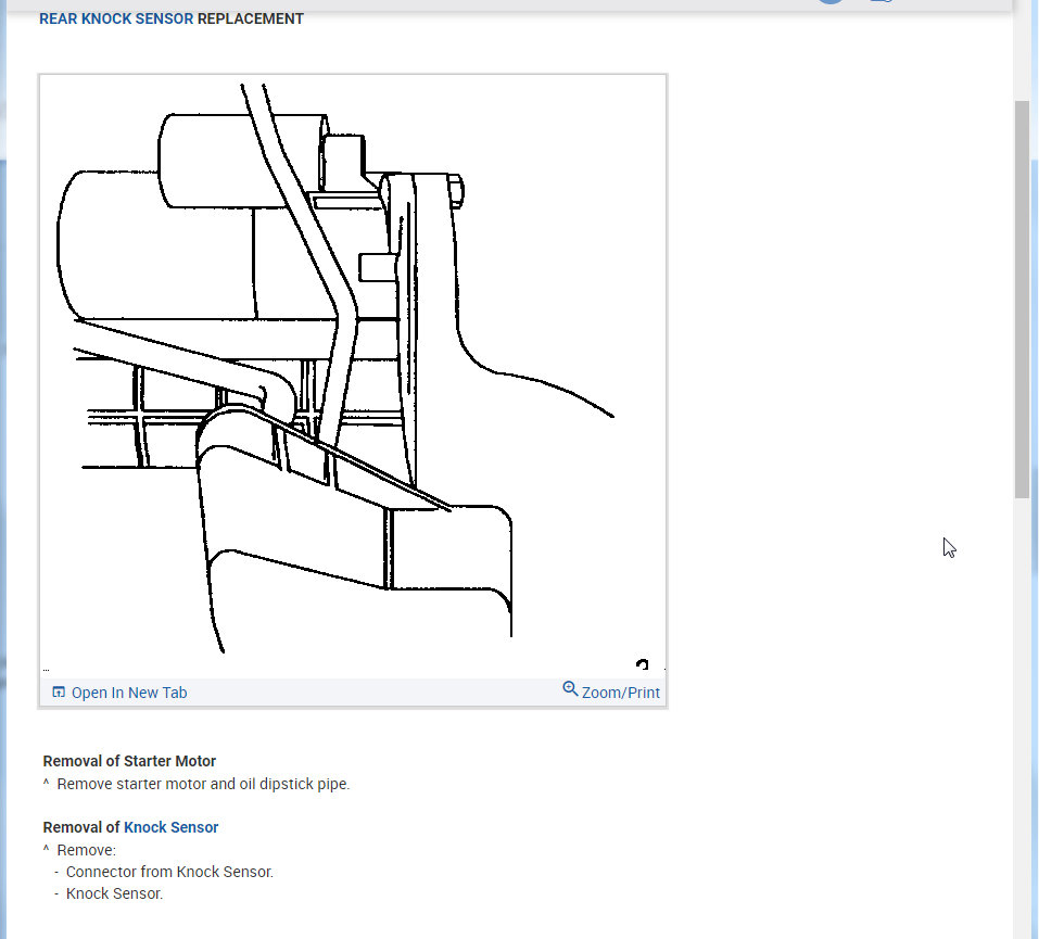

What position do you install the knock sensor?
Monday, November 2nd, 2020 AT 3:40 PM
MECHANIC
18,907 POSTS
I am attaching the process for the front and rear. Just make sure you don't switch the positions of the front (5 o'clock) and rear (9 o'clock).
Let us know if you need more info. Thanks.
