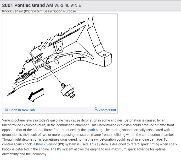

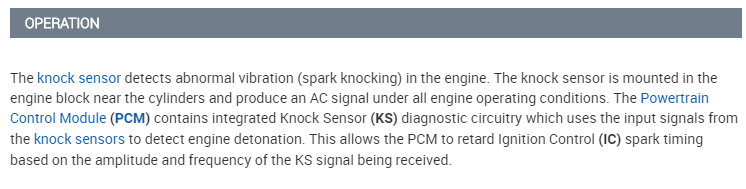

What is a knock sensor and what purpose does it serve?

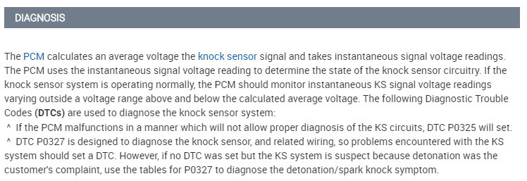

I've attached 3 pictures below showing the purpose and description information you requested for a knock sensor for your Pontiac Grand Am.Hope this helps and thanks for using 2CarPros.
