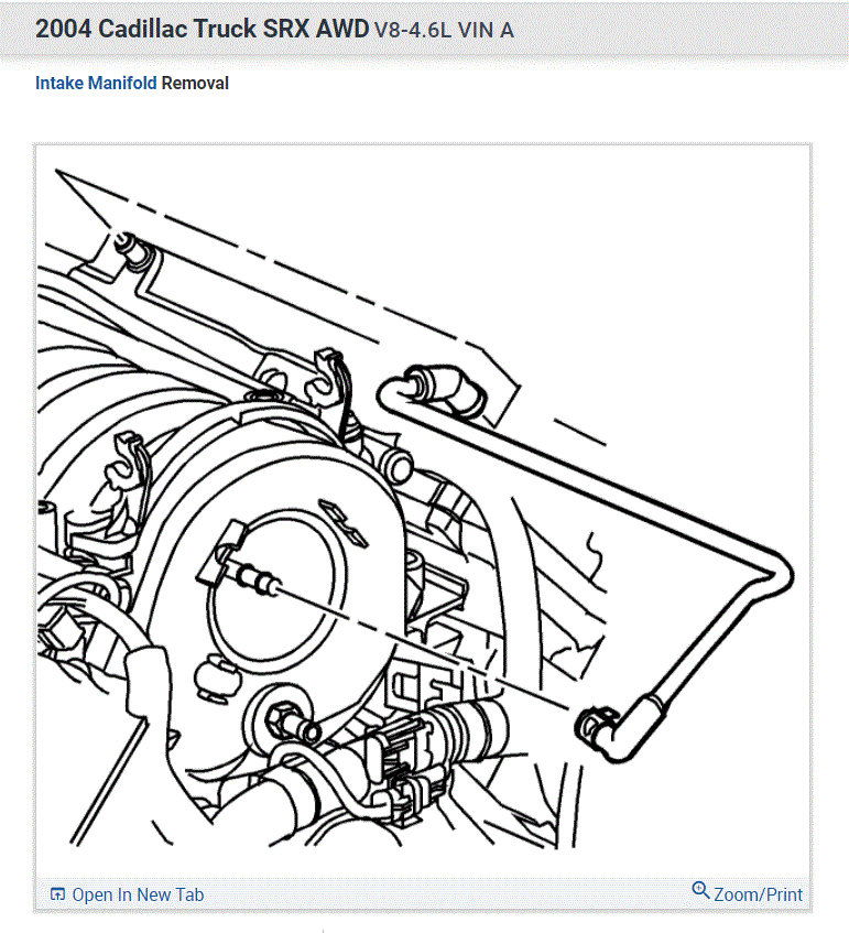

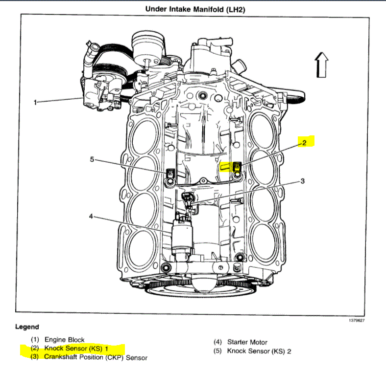

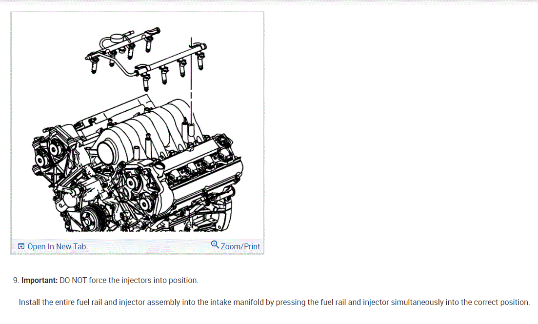

How do I locate (Bank 1) knock sensor? Car listed above has a 4.6 Northstar.
Mar 23, 2021 at 4:19 AM
  • 110,248 POSTS

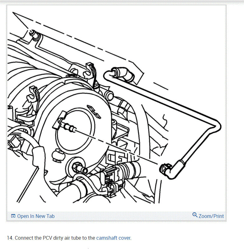

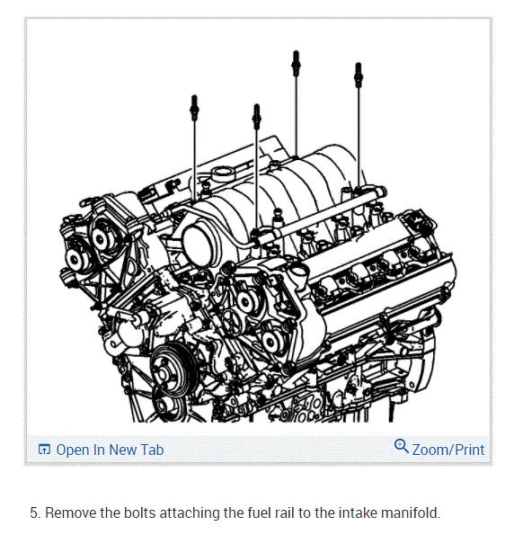

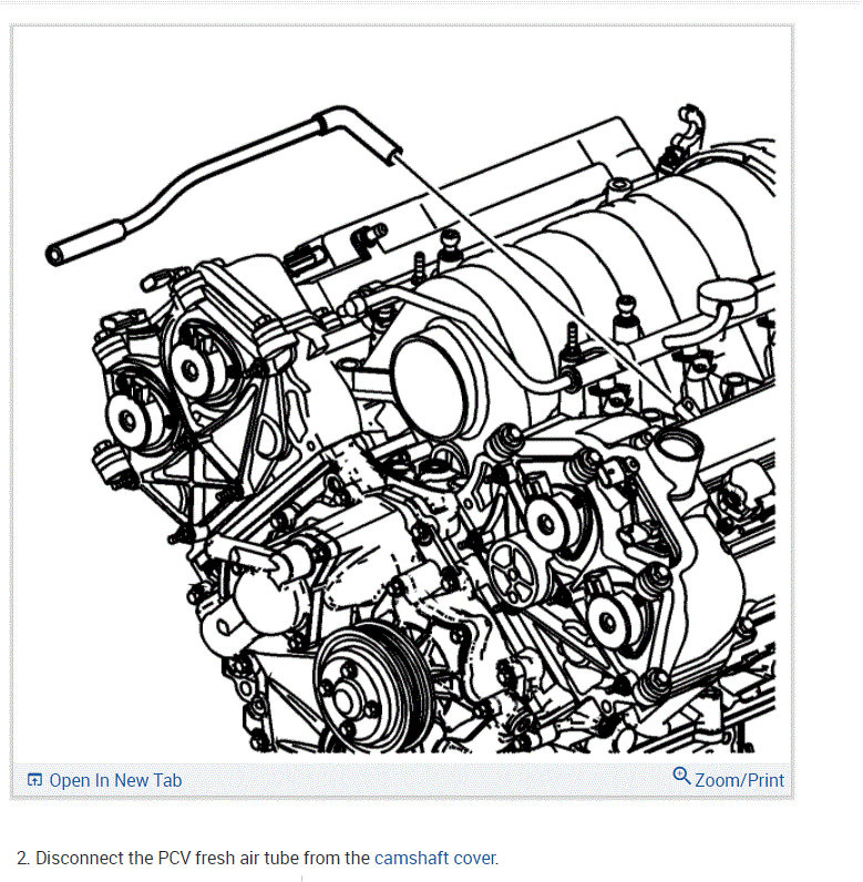

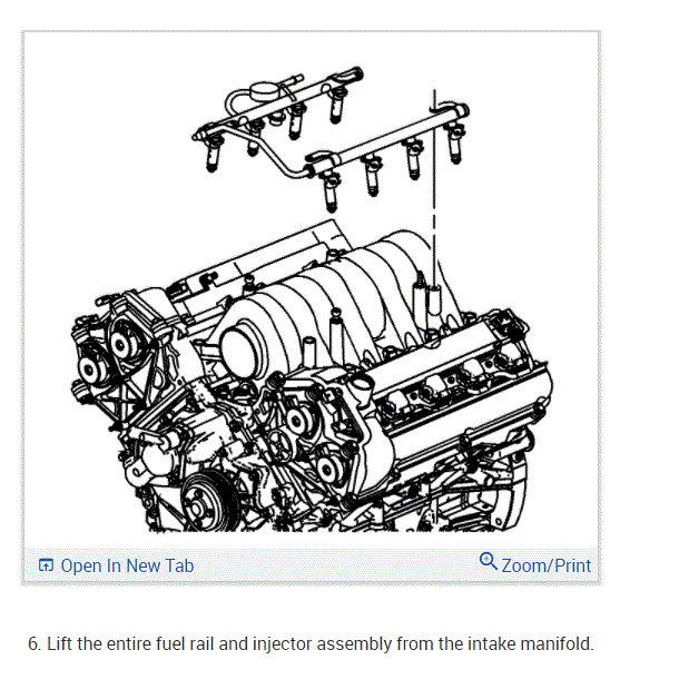

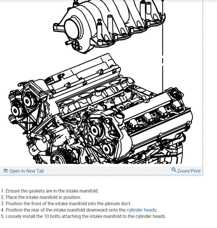

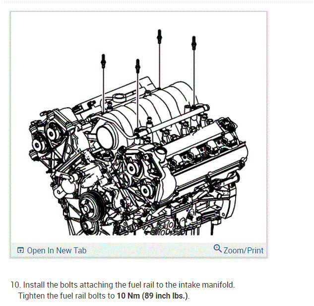

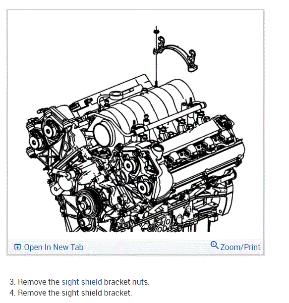

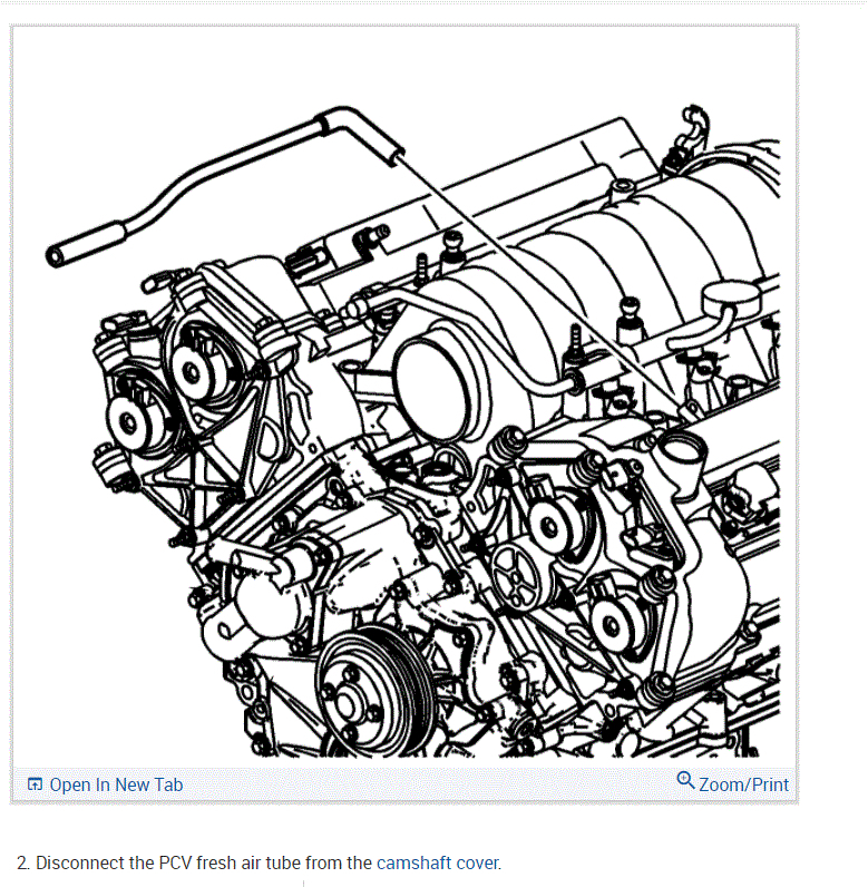

To access the knock sensor, you need to remove the intake manifold. Also, there are two knock sensors. If you look at the first picture below, I highlighted the bank one knock sensor.

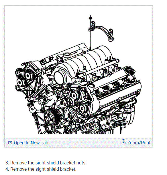

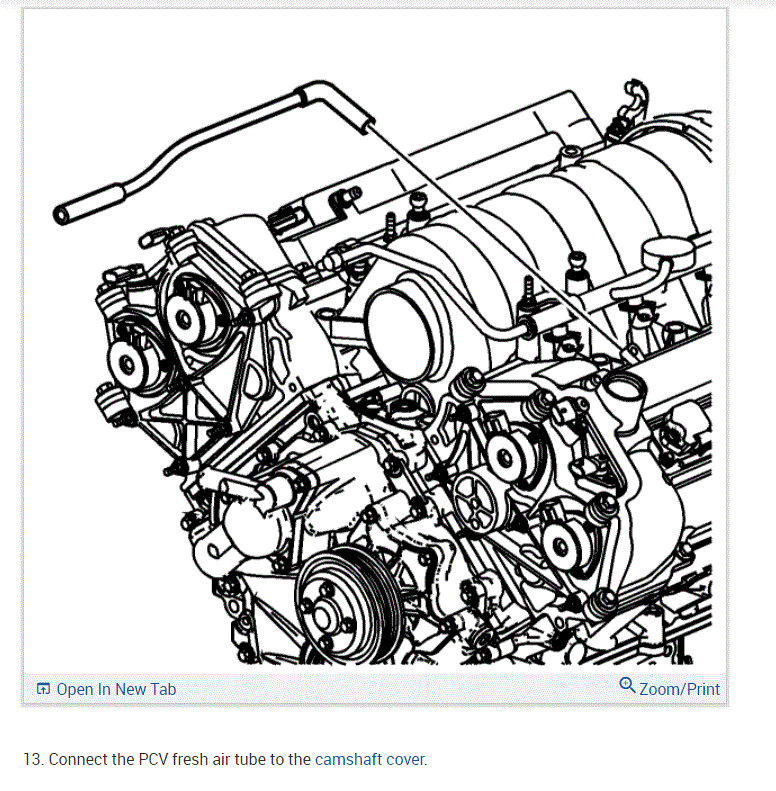

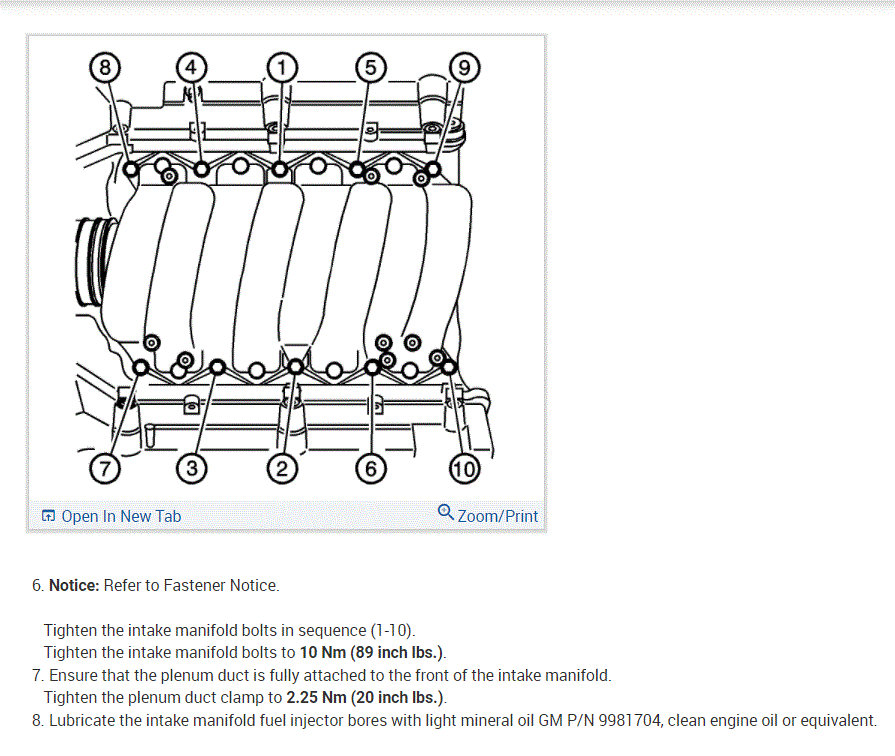

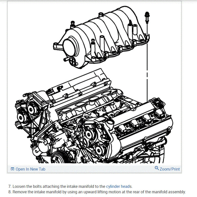

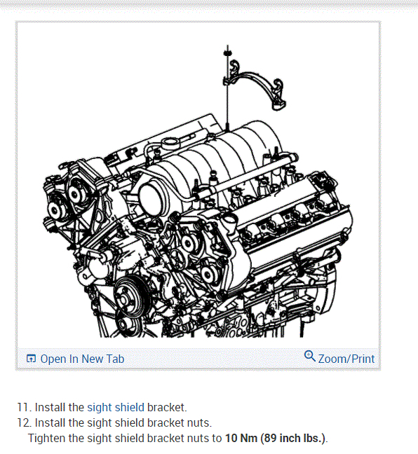

You will need to remove the intake manifold. The pics below (starting with pic 2) are the directions and pictures for the removal and replacement of the intake.
See pics below

Thank you so much! Looks like I’ll be busy on Saturday! Thanks again Joe!
