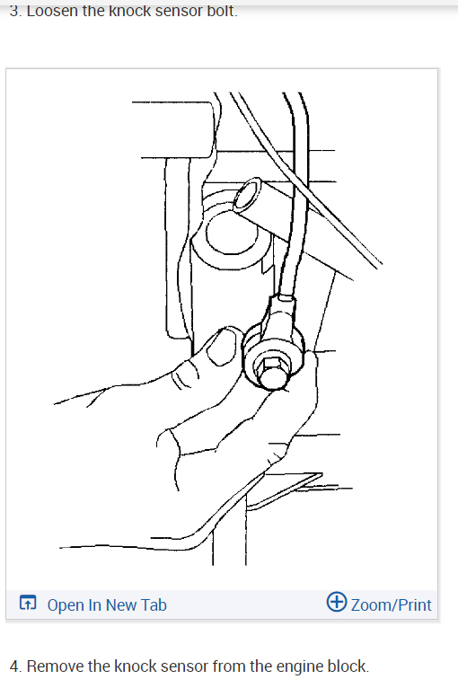

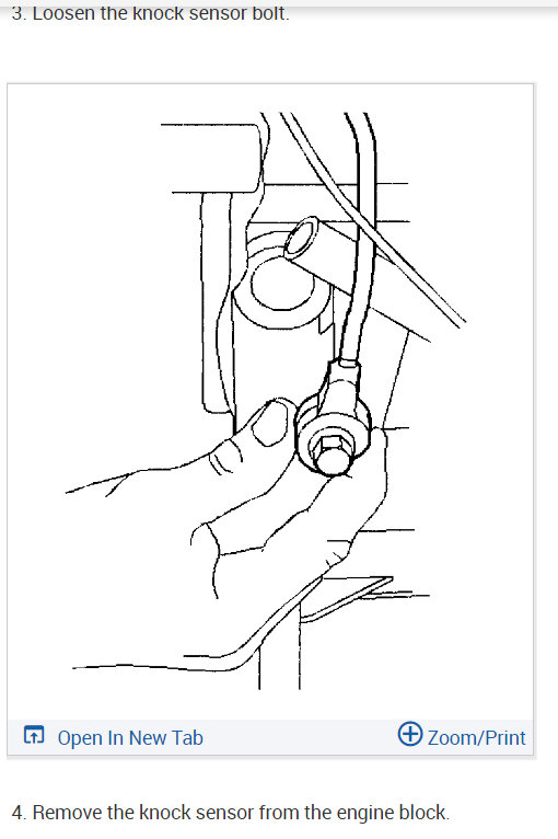

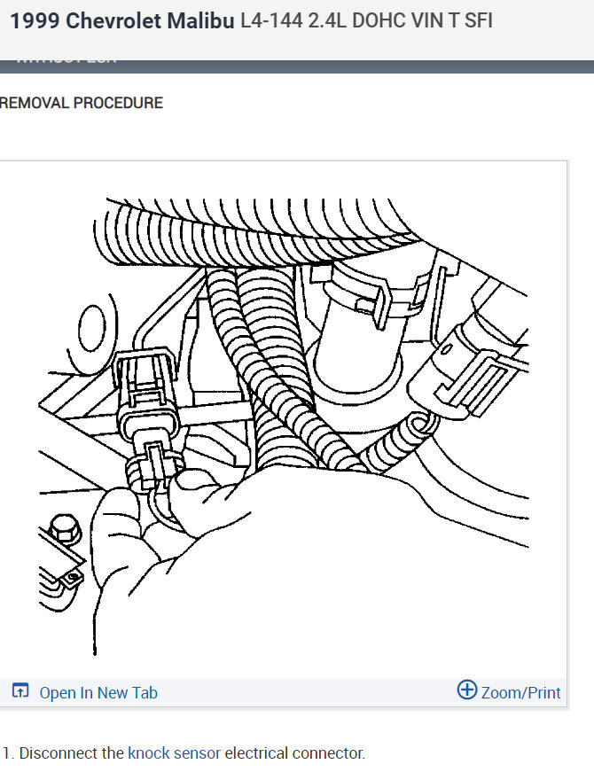

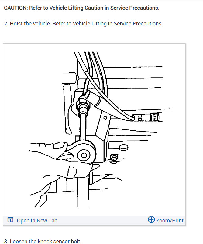

Where is the Knock sensor located?
1999 CHEVROLET MALIBU
125,000 MILES • 2.4L • 4 CYL • 2WD • AUTOMATIC
ANRDTC1220
Needed a diagram or a specific location for the knock sensor.
Oct 8, 2024 at 4:34 AM
  • 55,447 POSTS
the knock sensor is on the top left side of the engine. Check out the images (below). Let us know if you need anything else.
