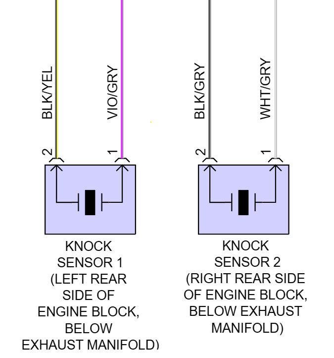

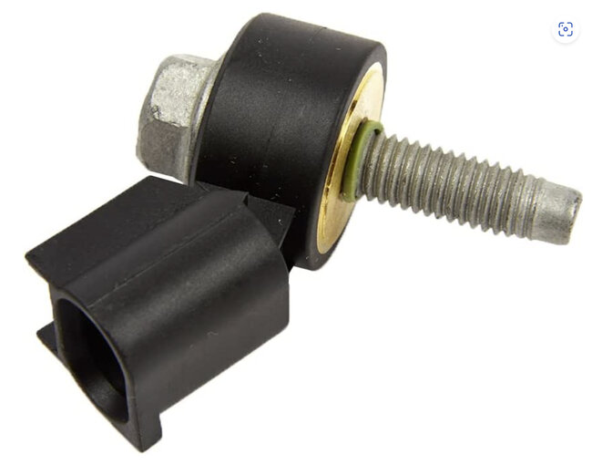

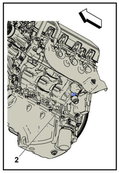

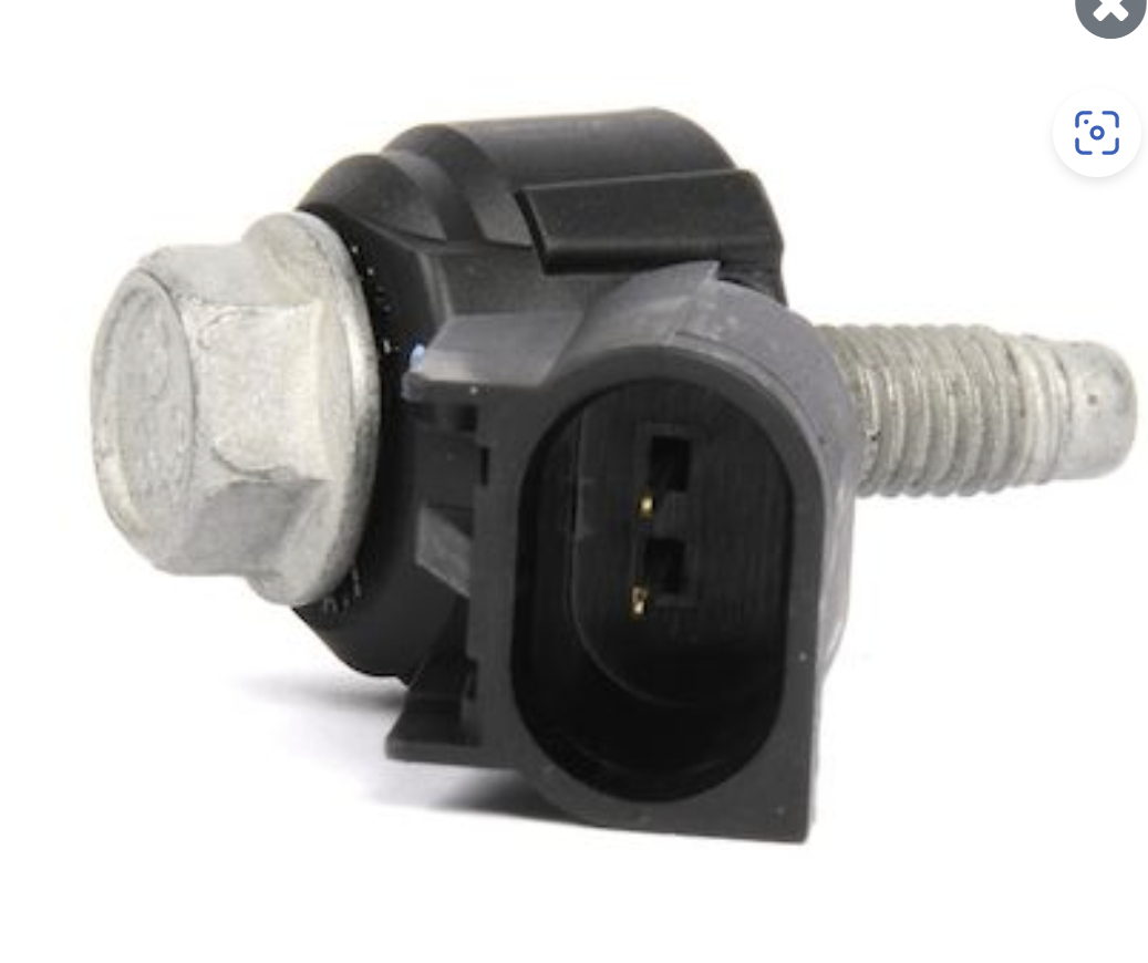

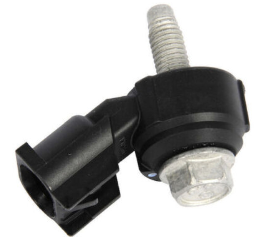

Can you tell me where the knock sensor is located? I understand it is no longer under the intake but on the block with a little better access.
Thank you
May 19, 2023 at 3:39 PM
BRENDON S
  • 653 POSTS
Hello 5123321055,
They should be located on each side of the engine, on the back under the exhaust manifold.
I added a few images for you.
Brendon
