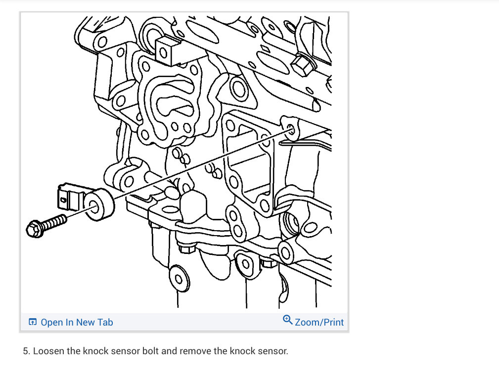

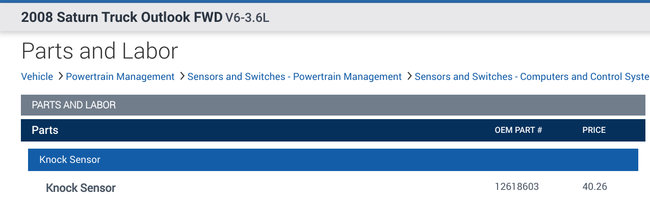

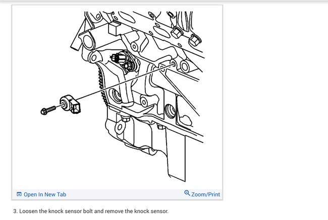

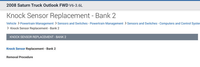

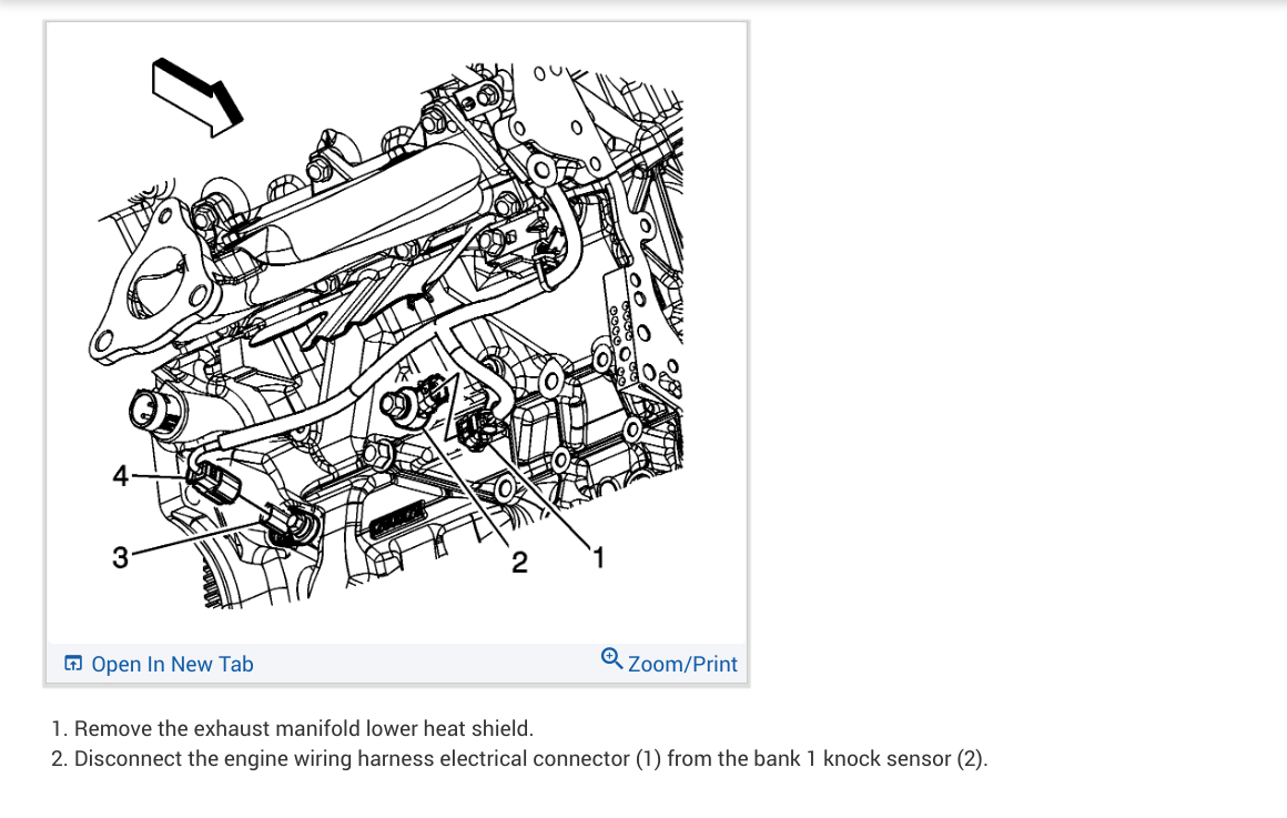

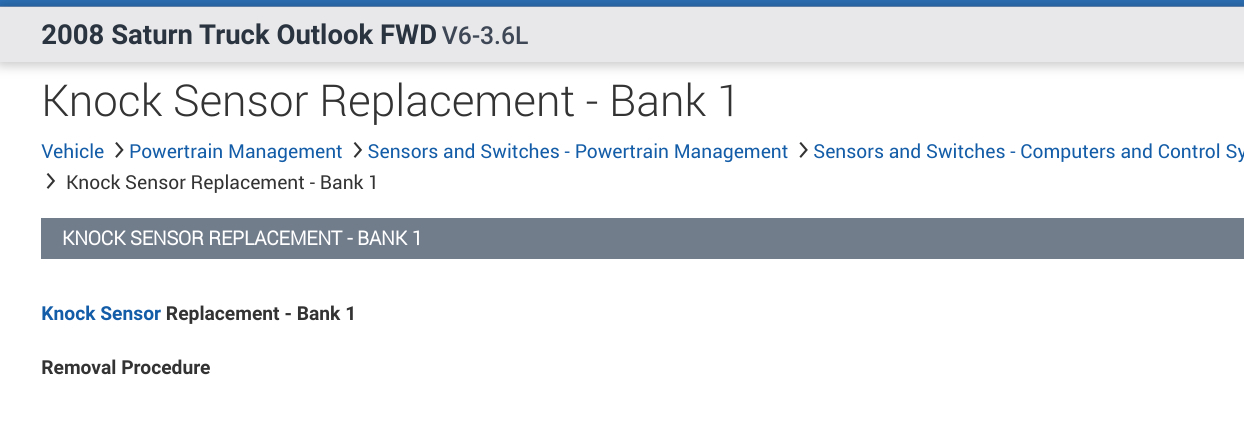

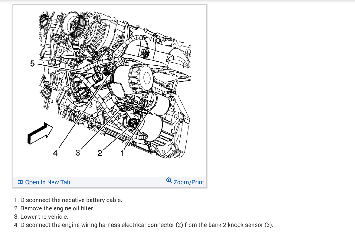

How many knock sensors are there for the vehicle listed above? when I order them how do I know what both sensors look like if there is two? Thanks I would really appreciate it.
Mar 25, 2020 at 5:51 AM
SCGRANTURISMO
  • 4,897 POSTS

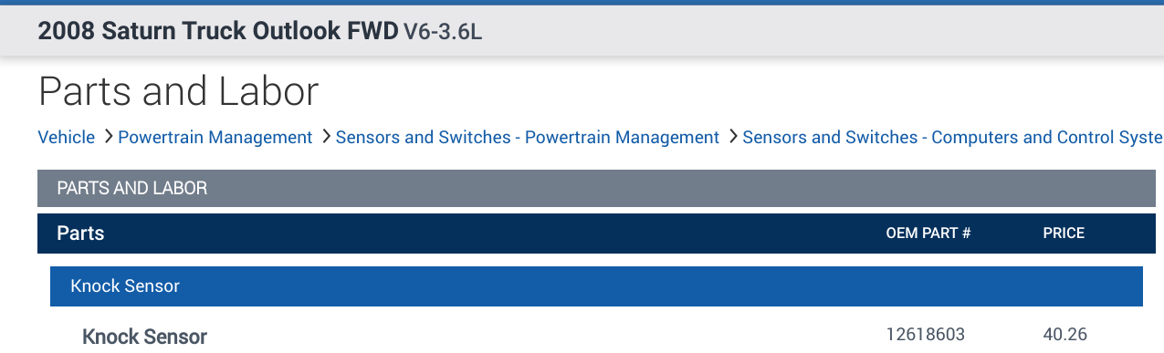

There are two knock sensors for your vehicle, one for each bank of cylinders, and are identical. In the diagrams down below I have included the Original Equipment Manufacturer[OEM] part number for the knock sensors and the removal instructions for both knock sensors. The installation is the opposite of the removal instructions. Please go through these guides and get back to us with how everything turns out. I hope this helps.
