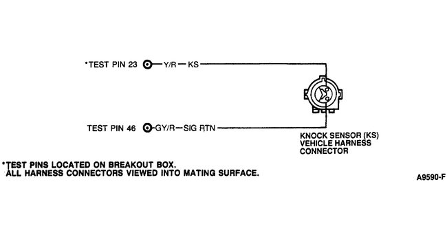

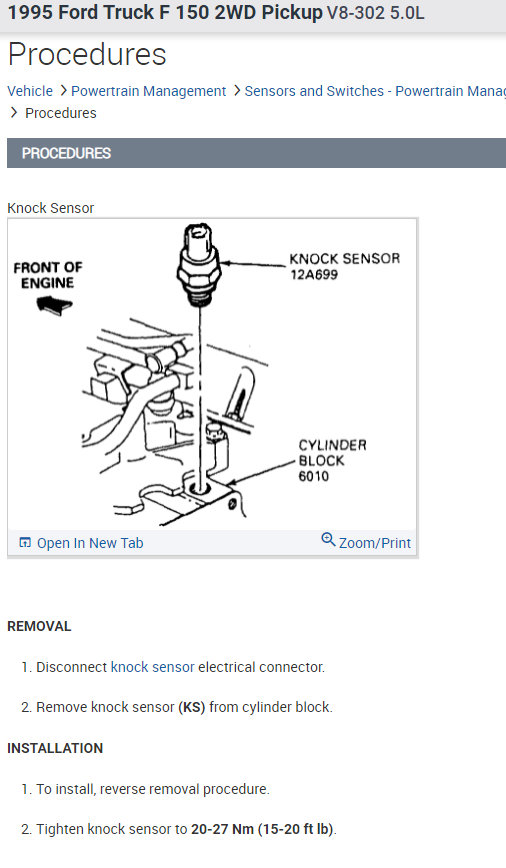

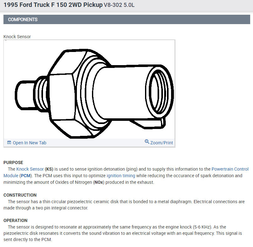

Where is the Knock Sensor located and how do I change them?
Aug 30, 2021 at 2:04 PM
SQM
  • 6,383 POSTS
The knock sensor is located at top part of the engine close to the firewall.
To replace the sensor just undo the wiring harness and unscrew with an appropriate size wrench.
See diagram for reference.
