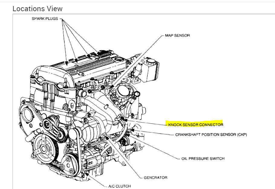

Yes I have a 2000 Saturn LS1. Every time I put my car's model of car in it always gives me stuff for a SL. Not what I asked for. Anyway, I need to know where is the knock sensor located on a LS1.

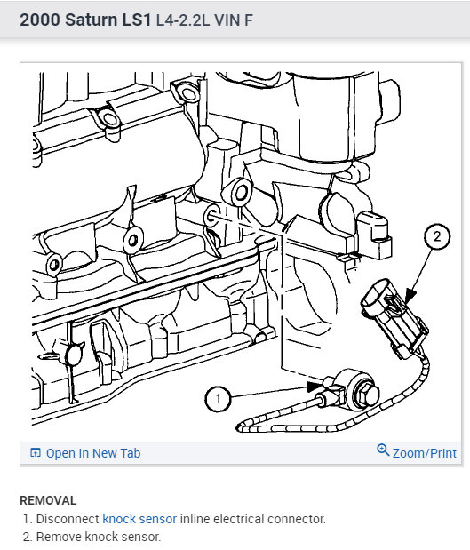

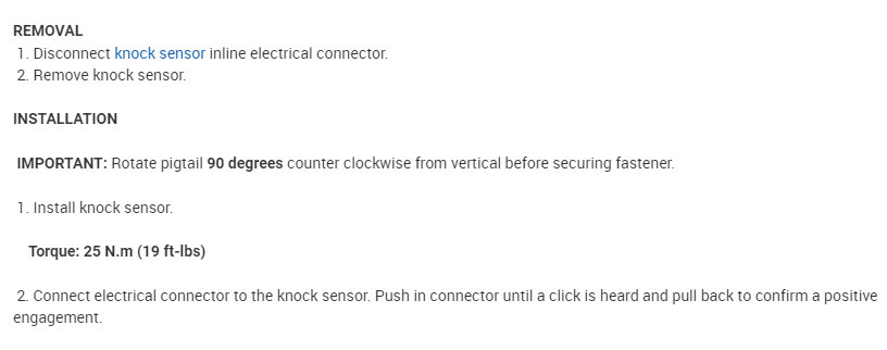

If you look below, pic 1 shows the location of the sensor you mentioned. The remaining pictures are the directions for replacing the sensor.
Take a look at the pics/directions and let me know if they help of if you have other questions.
