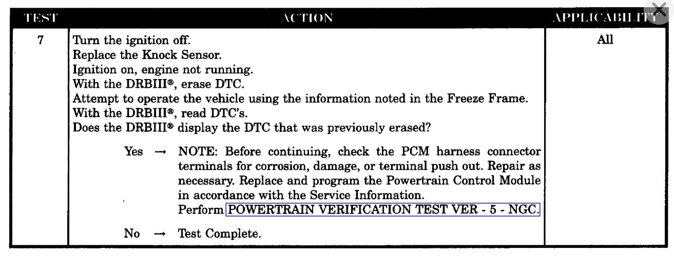

Knock sensor location
2003 CHRYSLER PT CRUISER
182,000 MILES • 2.4L • 4 CYL • TURBO • 2WD • AUTOMATIC
PTBILL

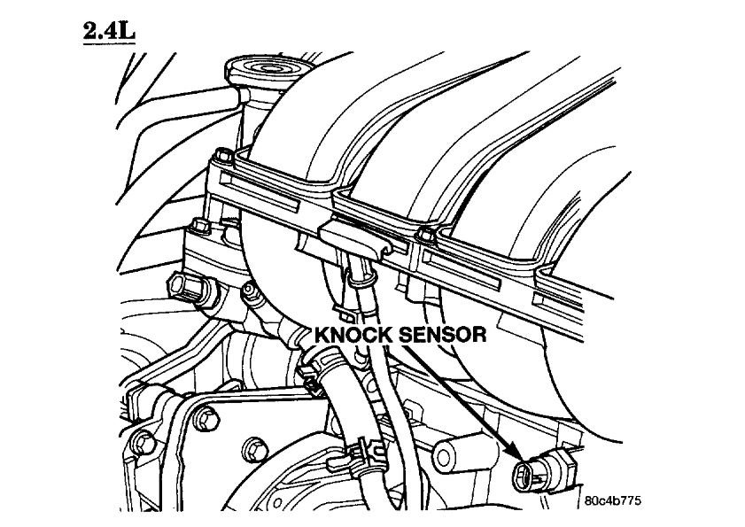

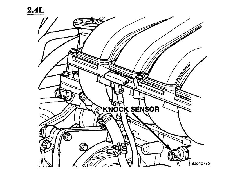

Where is it?
Jul 8, 2020 at 3:08 PM
Good evening,
I attached a picture for you of the sensor.
https://www.2carpros.com/articles/how-a-knock-sensor-works
Why are you replacing it? If you have a code, can you give me the code so I can verify if the sensor is bad?

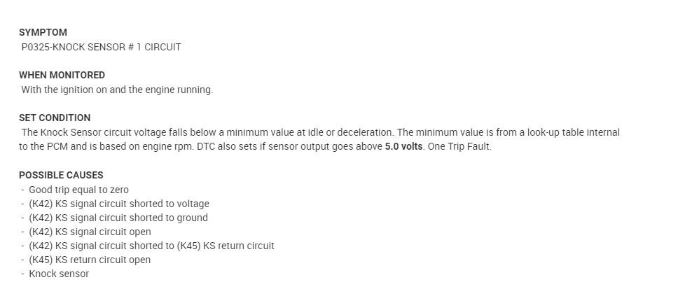

code: 0325.
Jul 9, 2020 at 10:15 AM

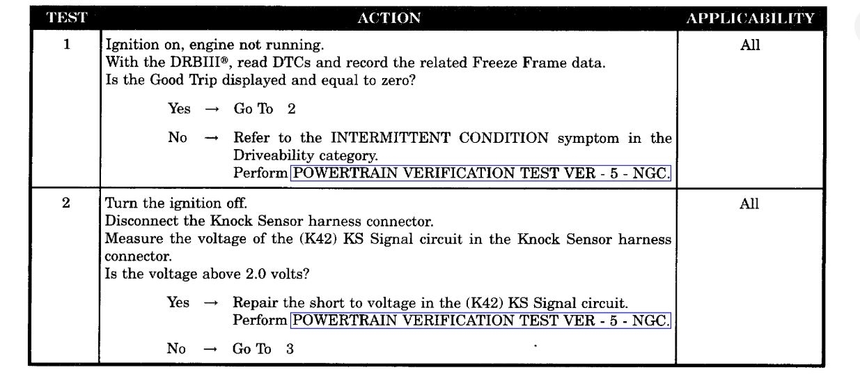

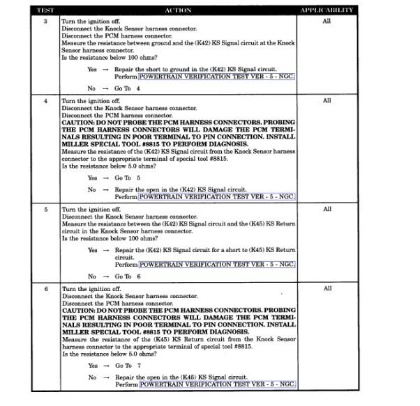

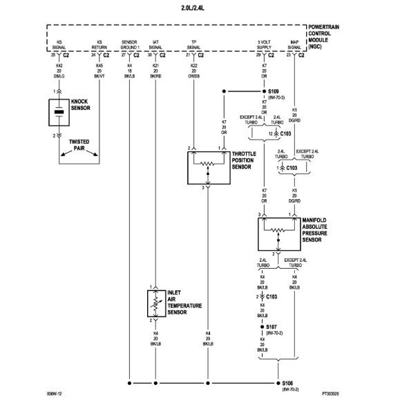

Okay, I attached a flow chart for you to view and some testing to be sure it is the sensor.
The one thing I would do is remove the connector from the sensor and use a voltmeter and test the voltage at the sensor. Use the red lead in one terminal and the black lead to the other terminal. Then tell me the voltage reading with the key in the on position.
