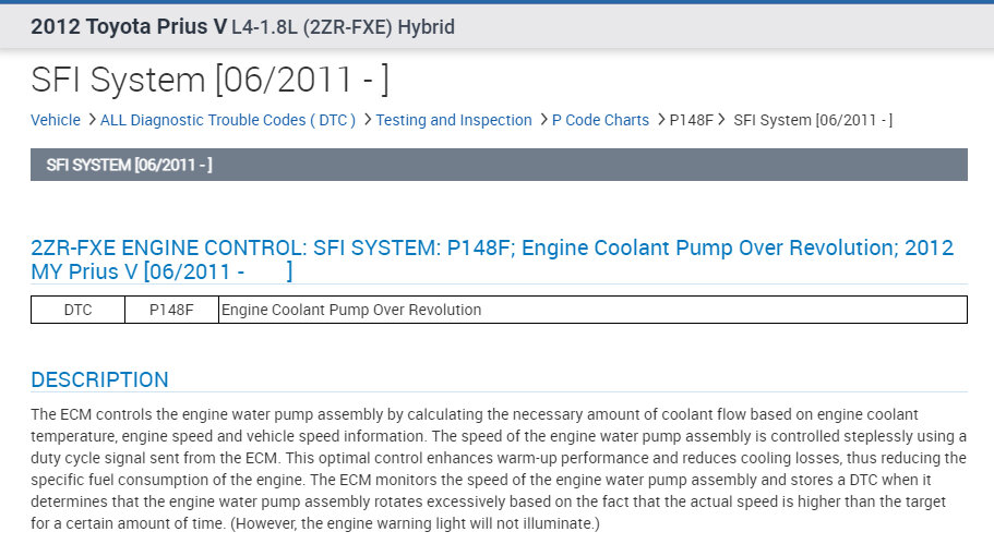

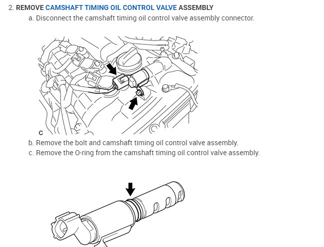

Is this code related at all? I know the EGR, and intake issues can cause this but what about this code? p148e
Oct 23, 2022 at 8:09 AM
  • 110,244 POSTS
That code is related to the variable camshaft tuning (VCT). Absolutely, that can cause a knocking when first started. In most cases, looking for a sticking or stuck VCT solenoid valve caused by contamination. See pic below for what I'm questioning.
Interestingly, I'm not showing that code for this vehicle. By chance, are you outside of the US? Let me know because that may be why.
See pic below.
Oct 23, 2022 at 2:54 PM

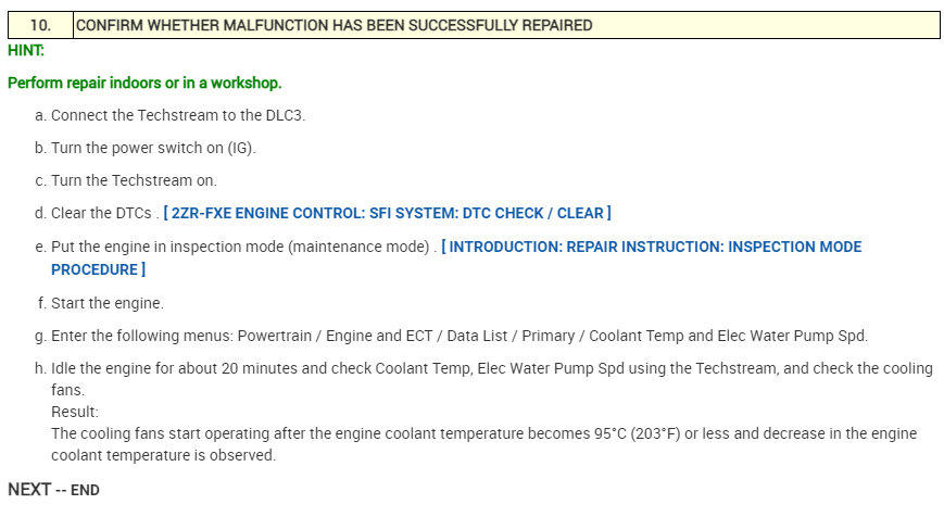

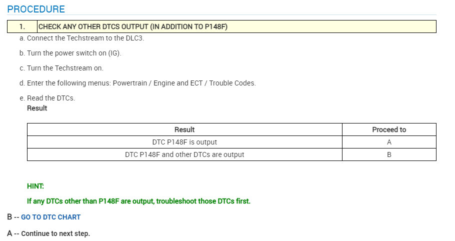

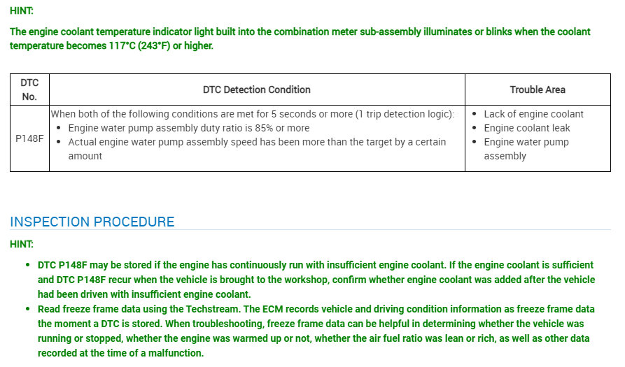

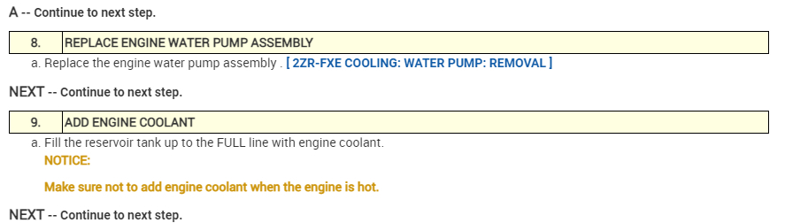

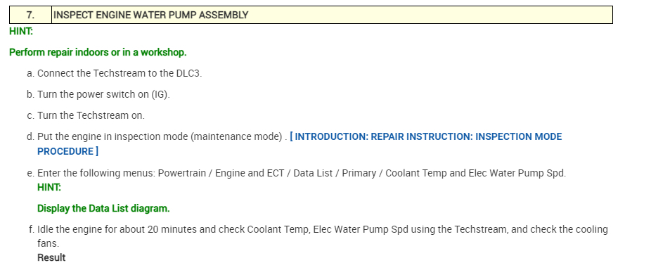

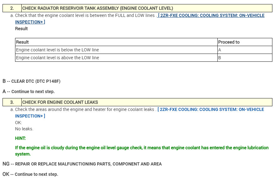

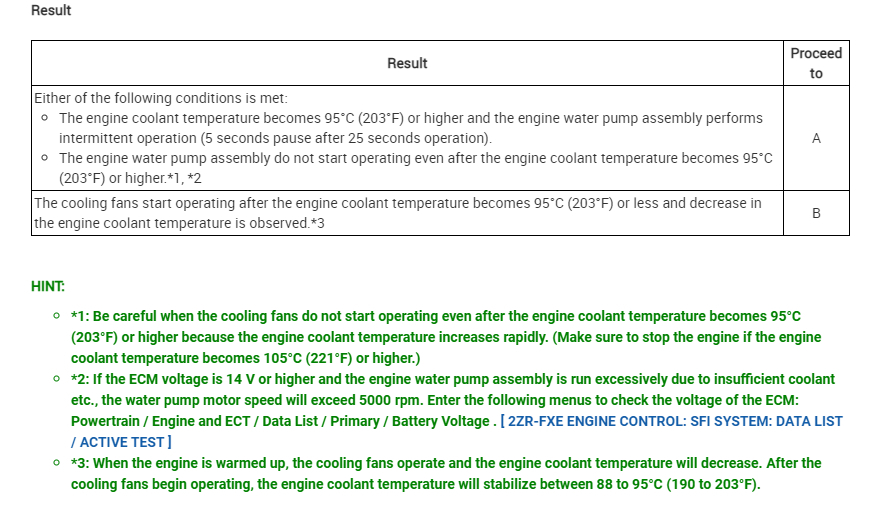

  • 110,244 POSTS

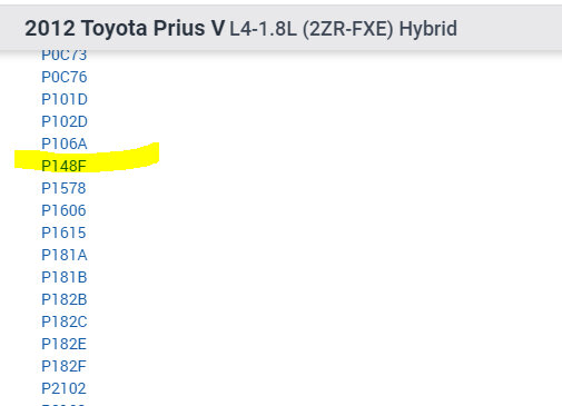

I checked in a different manual and found the same thing. I have no idea why it isn't listing it.

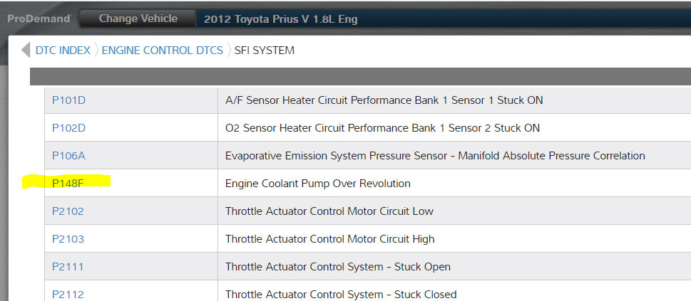

As far as the code is concerned, again, it doesn't even show that on this vehicle. See pic below and you'll see what I mean. Also, the pics above are accurate for the control valve.

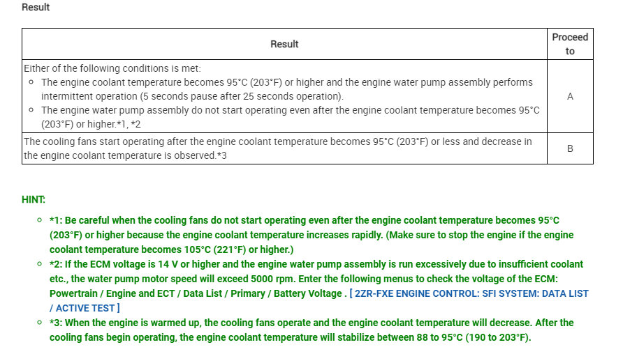

See pics below. That is from two different professional manuals. I wish I had a better answer for you, but I'm not sure which direction to go.
Oct 24, 2022 at 11:44 AM
BHAMDOC1973
  • 2,007 POSTS

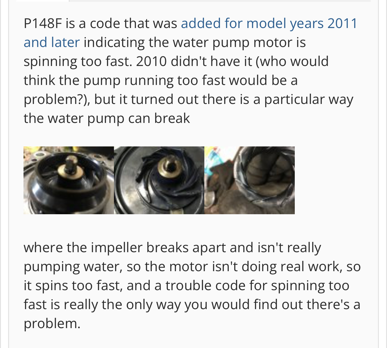

Yes, i see it now. They changed it in 2012 to the water pump code.
Oct 24, 2022 at 12:01 PM
  • 110,244 POSTS

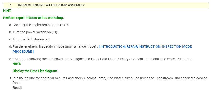

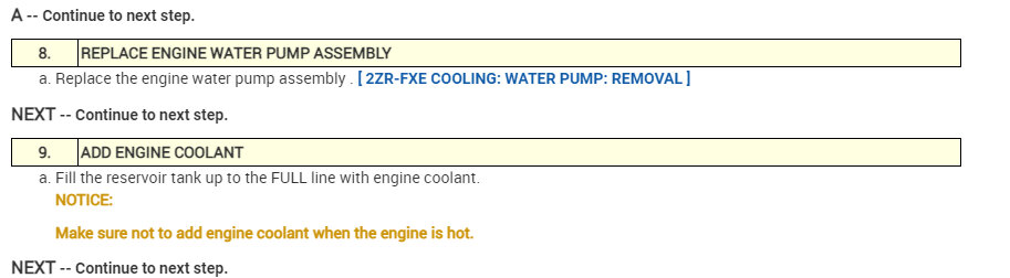

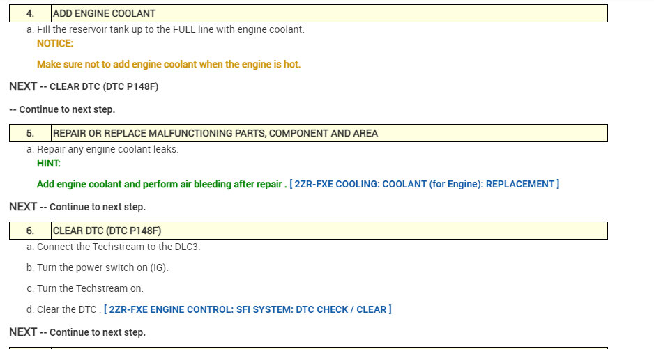

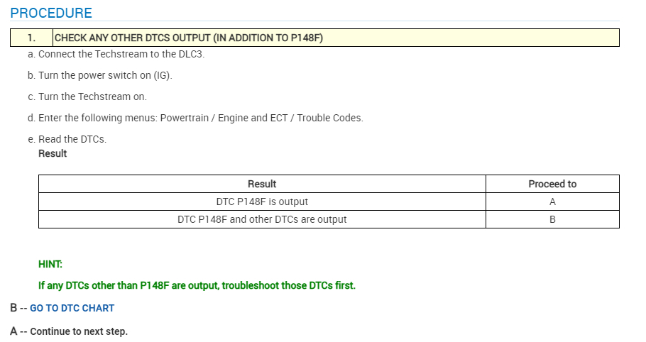

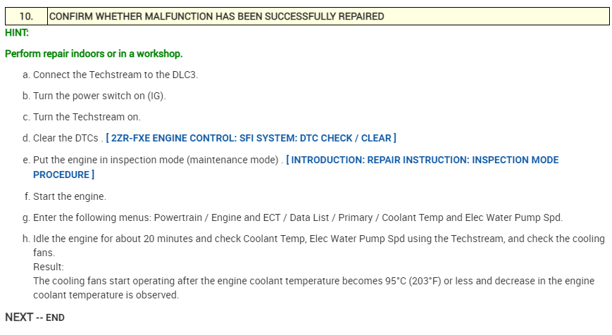

That makes sense. LOL Okay, I attached the diagnostics below for the P148F. Take a look through them and let me know if it helps.
Oct 24, 2022 at 12:49 PM
