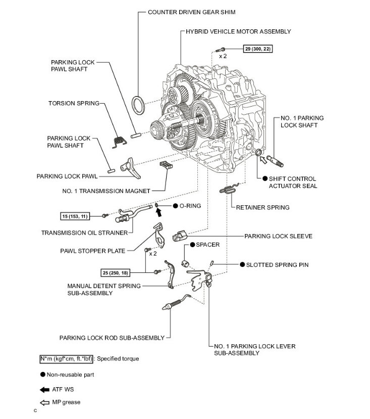

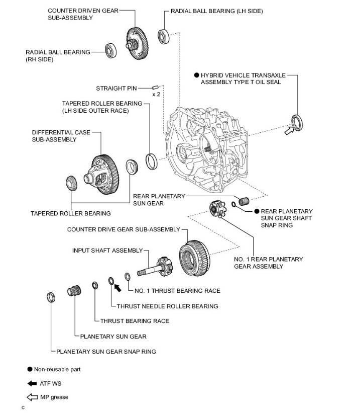

Thanks for the video, you are right the engine is okay and I don't is it misfiring, it sounds more like the Hybrid transmission front planetary or possibly the input shaft can you tell if the engine is coming from behind the engine and in the transmission area? Here is what I am talking about. The noise can cause the knock sensor to go off and cause the engine to become unbalanced which can cause the random misfire codes. Check out the images (below). Please let us know what happens.

You mean is the sound coming from around where transmission meets the engine?
Jun 29, 2023 at 3:47 AM
BHAMDOC1973
  • 2,007 POSTS
Feels like it's coming from the back, but there is no vibration while I am driving, so what are the possibilities? How can i check on mounts on this vehicle like we did with regular cars by pressing gas and brake pedals since it's hybrid?
Jun 29, 2023 at 4:14 AM
  • 55,845 POSTS
Yep, that is one way, also you can try lifting the engine or transmission with a floor jack to see if there is excess movement. I don't think it is an engine mount, but you never know. Does the noise change when shifting from park to drive to reverse?

If the noise has just begun then it could be cold only at first and then wear further to be present at all times. I still think it could be the coupler between the engine and transmission. Can you get a video of the noise from under the car?
