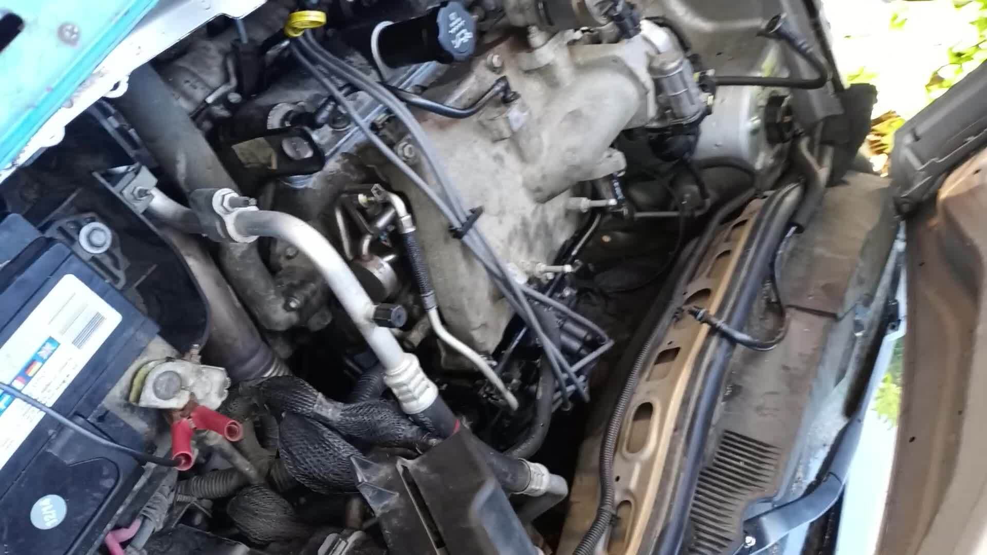

We replaced the rocker arms and lifters changed oil and filter it still has knock in the top end but drives fine. The codes that come up are P0405 P1516 and P2101, what else could be the problem?

None of these codes will create an engine knocking sound. Please upload pictures or videos of the problem so we can see what's going on.

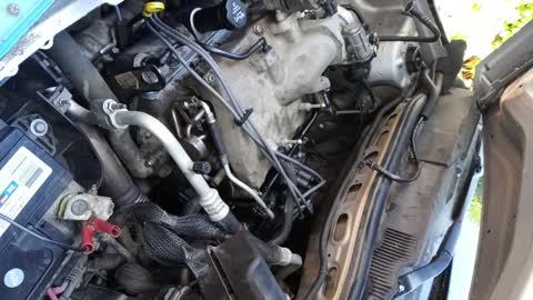

ED&DESI
That is with the back value cover off.
Aug 11, 2023 at 7:39 AM
  • 55,746 POSTS

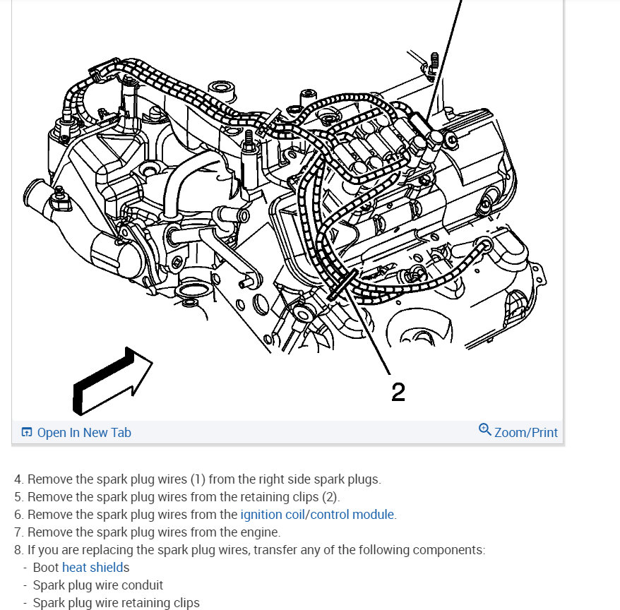

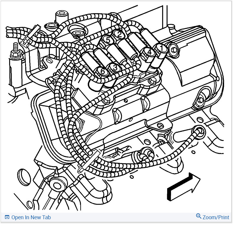

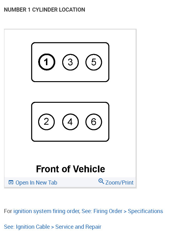

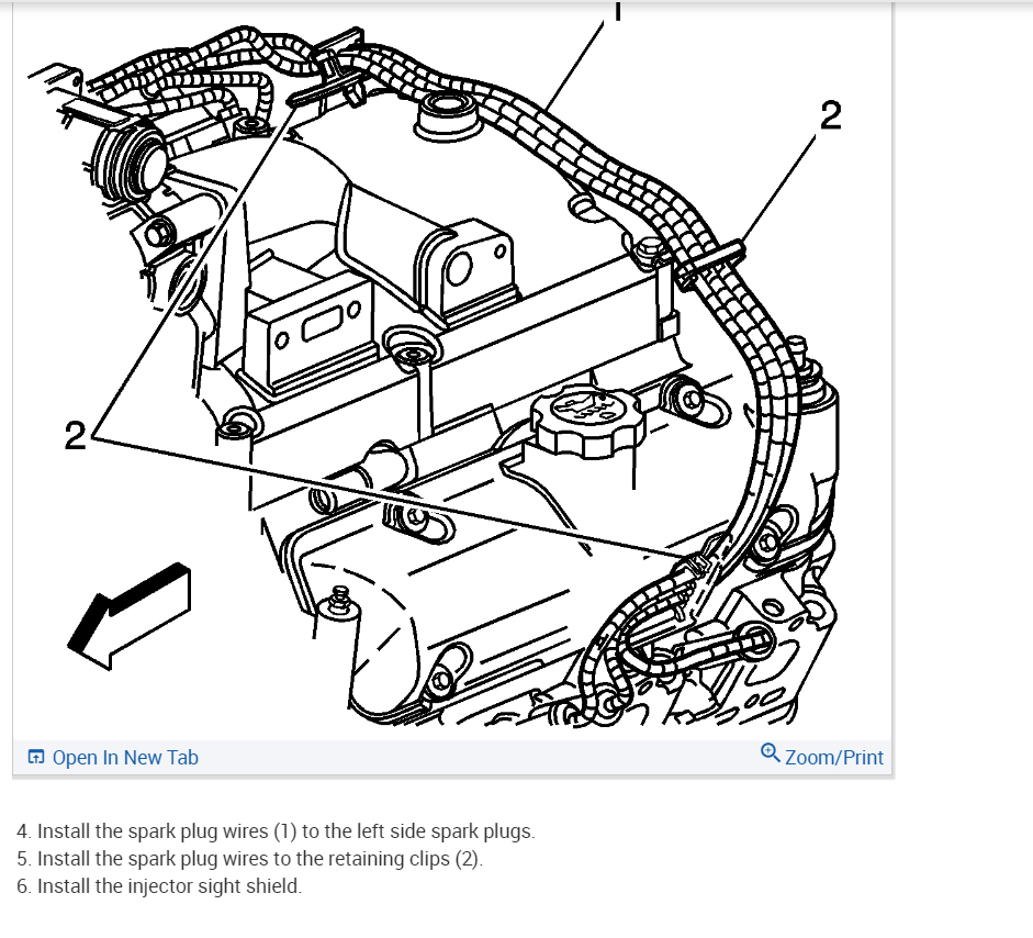

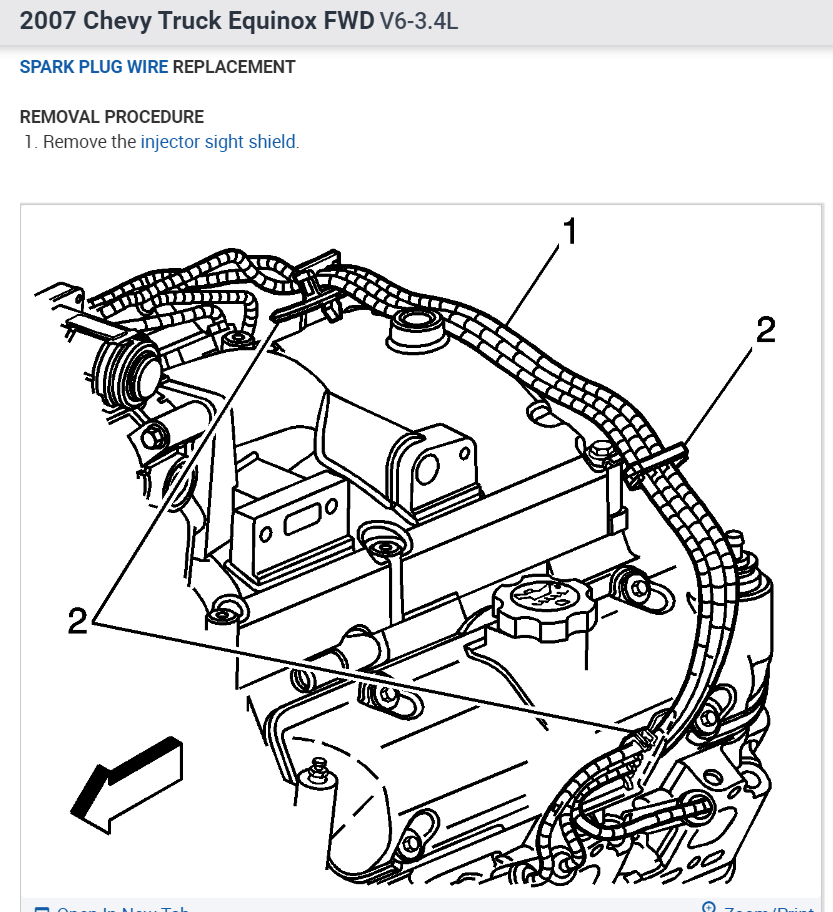

It looks like the spark plug wires could have been installed incorrectly. Can we please double check it?
Firing Order .................... 1 - 2 - 3 - 4 - 5 - 6
Aug 12, 2023 at 2:16 AM
ED&DESI
They are In the right place.

You might have a head gasket blown between two cylinders, let's do a compression test to see what's going on.
Please go over this guide and get back to us.
