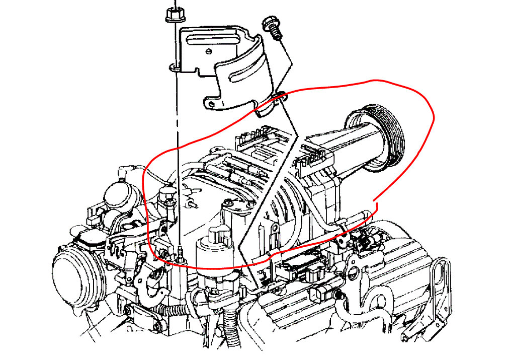

I took my car into the mechanic for a head gasket replacement, paid almost $1,800.00 in total, they replaced the gaskets, took the heads and had them machined and stuff. I pick the car up and upon starting it the car hesitated to start, and acted like it wanted to stall, and then a knock started. Could the knock be caused from them changing my head gaskets or are they not held reliable?

My supercharger boost gauge is also stuck in the middle now as well, not sure what they did to cause that or if that could have caused a knock ?
Mar 1, 2021 at 11:53 AM
  • 110,240 POSTS
The supercharger had to be removed. See if you can tell if that is where the sound is coming from. I attached a pic of it below.
Let me know,
Mar 1, 2021 at 12:31 PM

I think maybe my supercharger belt is worn. pulleys are loose or the supercharger bearings, or the supercharger coupler.

It sounds like lower end noise. if when you raise the idle the noise is heavier, you have lower end noise (rod knock). there is a possibility for your blower to have a failure. determine by removing the drive belt and listen again.
