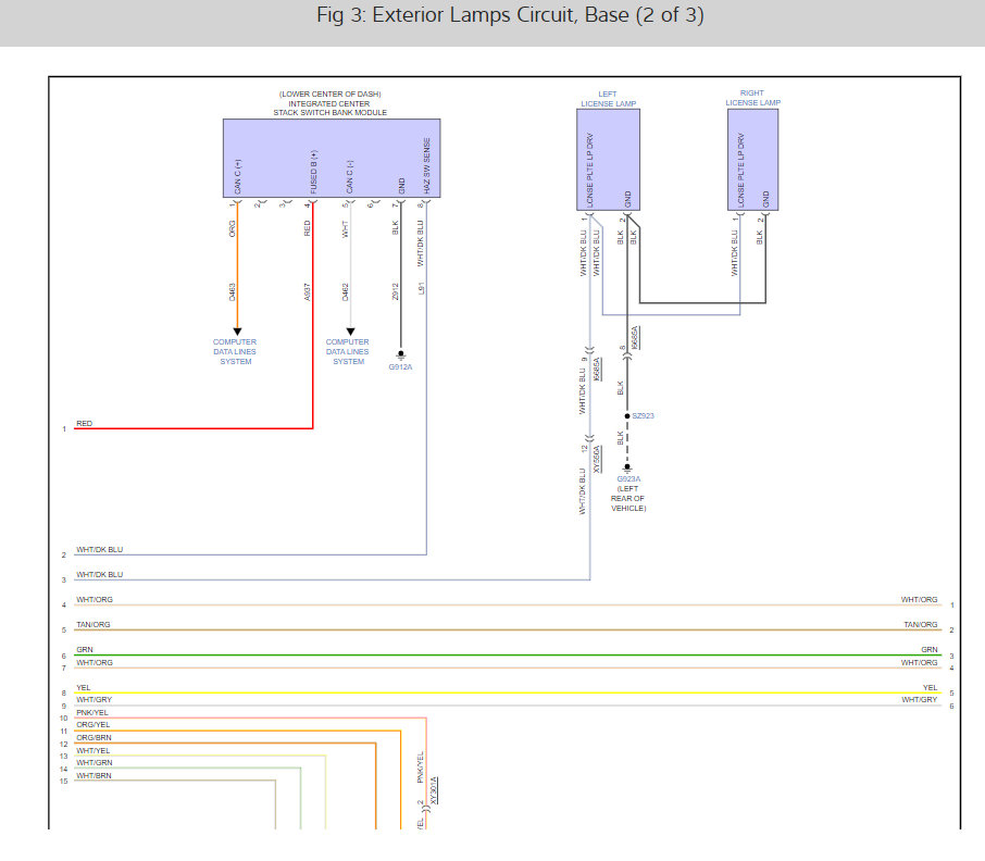

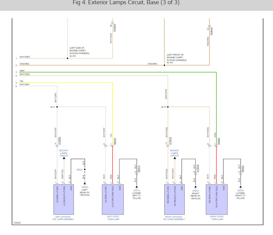

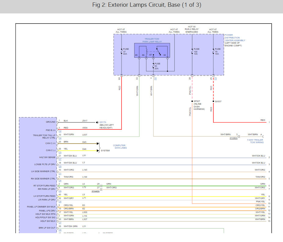

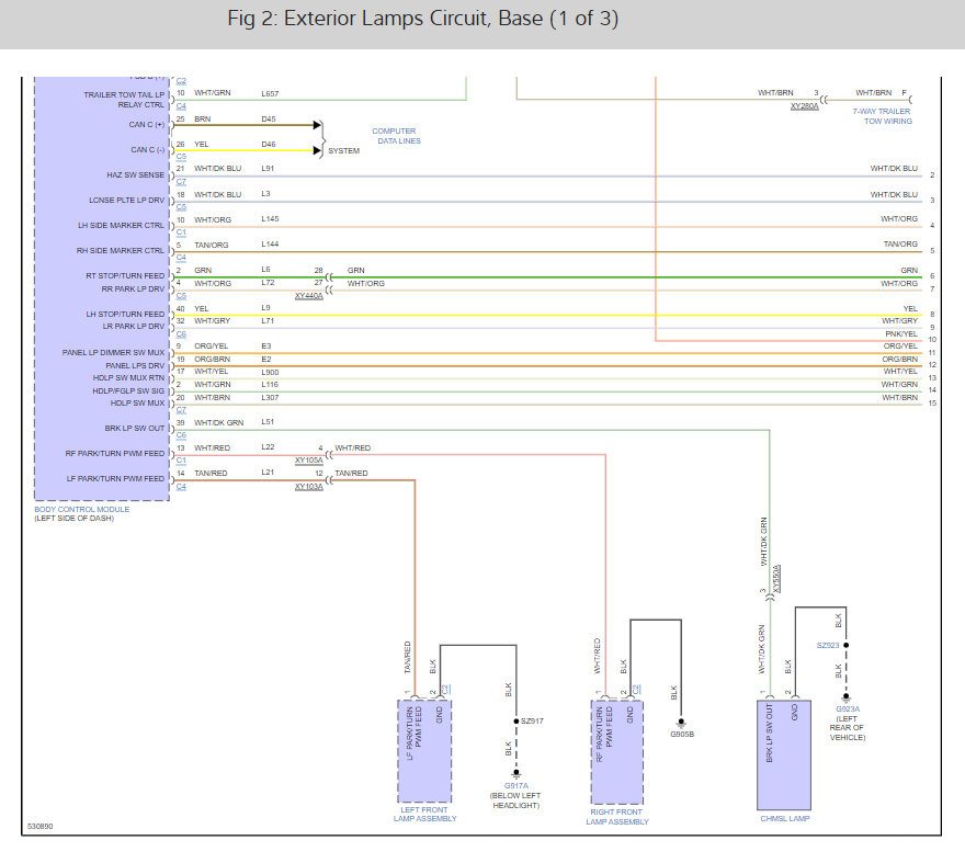

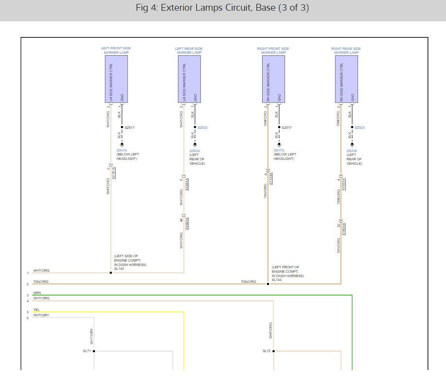

Where is the wire to the rear turn signals located?
217,000 MILES • 6 CYL • 2WD • AUTOMATIC
ADAMWLODARCZYK
Rear turn signals wire location.
Sep 18, 2022 at 2:34 AM
  • 55,746 POSTS
The wiring harness for the rear lighting system and how the wiring harness is layed out inside the car. Let me know if you need anything else to fix the problem. Check out the images (below). Please let us know what happens.
