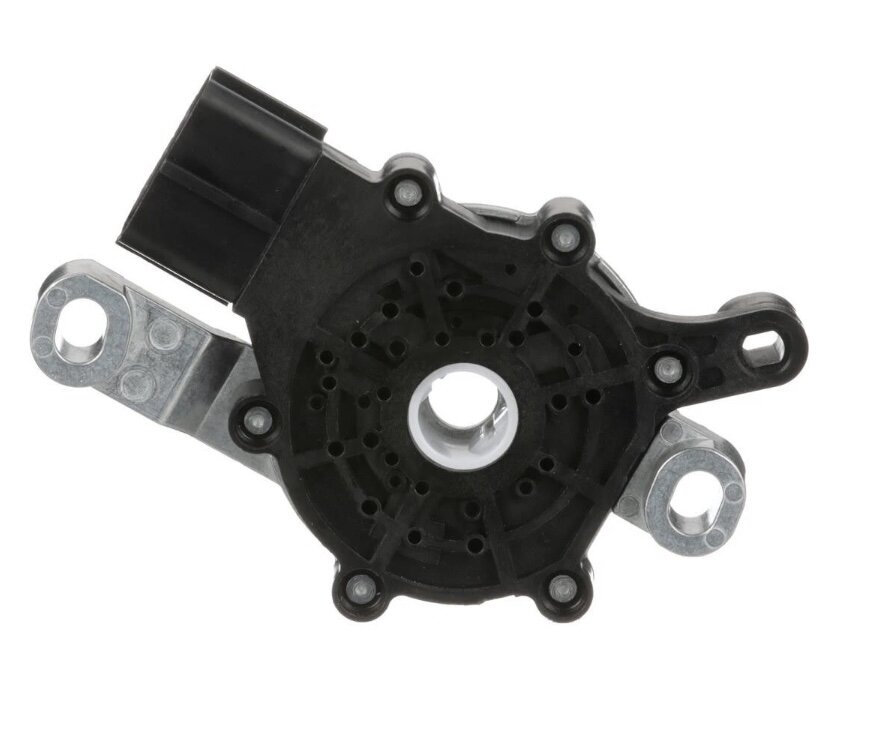

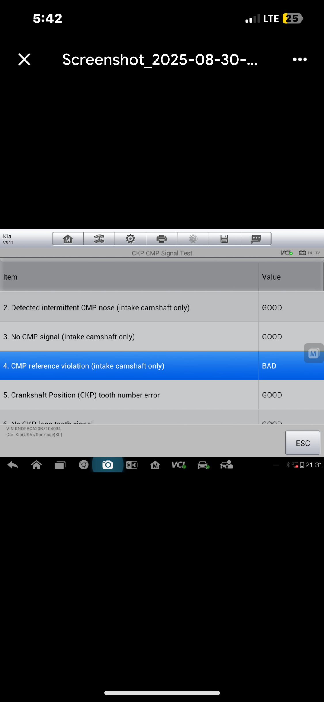

Please I am having difficulties locating the differences between these sensor and their locations, a diagram can help to know location of each sensor.
I get confused which is my scanner reporting fault.
Main issue is, car has drives and stalls, sometimes don’t keep idle, also idling is below specification.
KNDPBCA23B7104034
The intake manifold runner sensor switch, does it have a particular way of installing?
Please check the images below and advise.
Thanks!

While the engine was running, I actually pulled out both sensor. and it was still running as if nothing was pulled out.
What about the manifold runner? Could it also cause stalling or delay in starting?
Regarding the internal cams, it’s true they had suffered worn out.

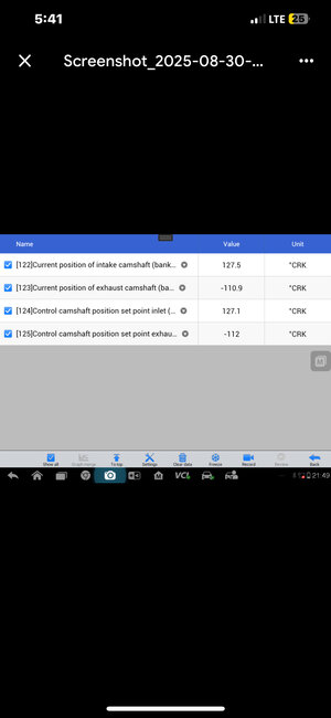

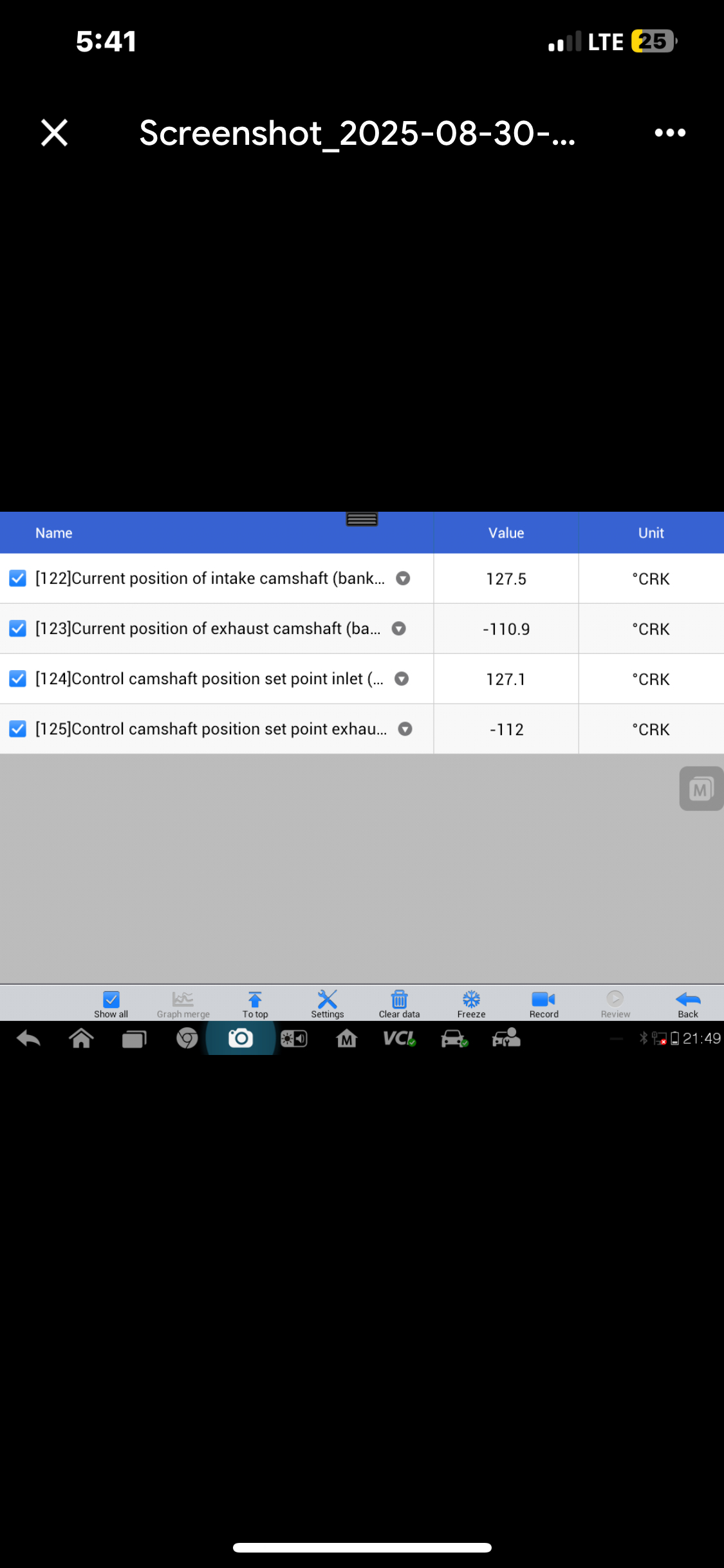

Let me attach a live data chart I took while both were connected.

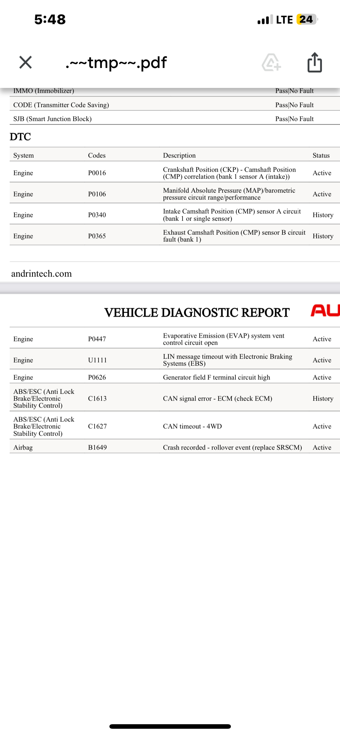

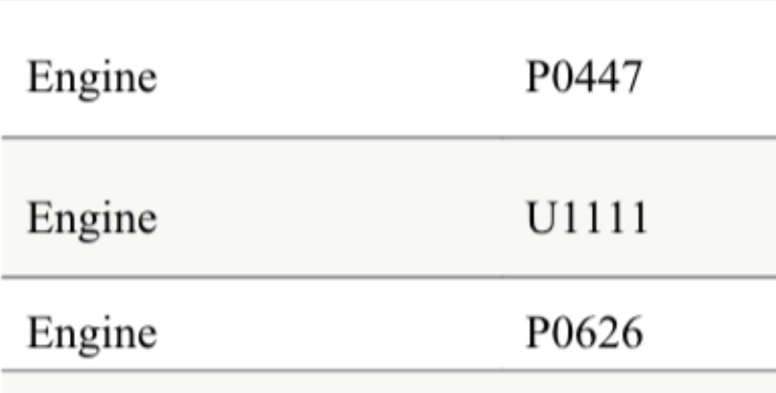

Ok! Erasing the data will reset the ecu tight. When I did, these codes remain permanent. For the AwD I removed the module. I have attached an image of the codes below.
Sep 1, 2025 at 3:58 AM
MECHTRIX
  • 529 POSTS
1.Ok th code u111 is just for when you disconnected a the batery or it has a chaging problem can be related to munber 3 down below
2..the po447 is for the evap system you can check this later after the other two numbers 1 and 3.
3..the po626 is for a fualty alternator signal or bad wiring to or from the alternator it can cous lots of problems check that first ot also might be related to number 1 up top ..so check this first
So far these are pretty simple fixes but let us know if these are fixed then some of the old problems night not come back good luck
