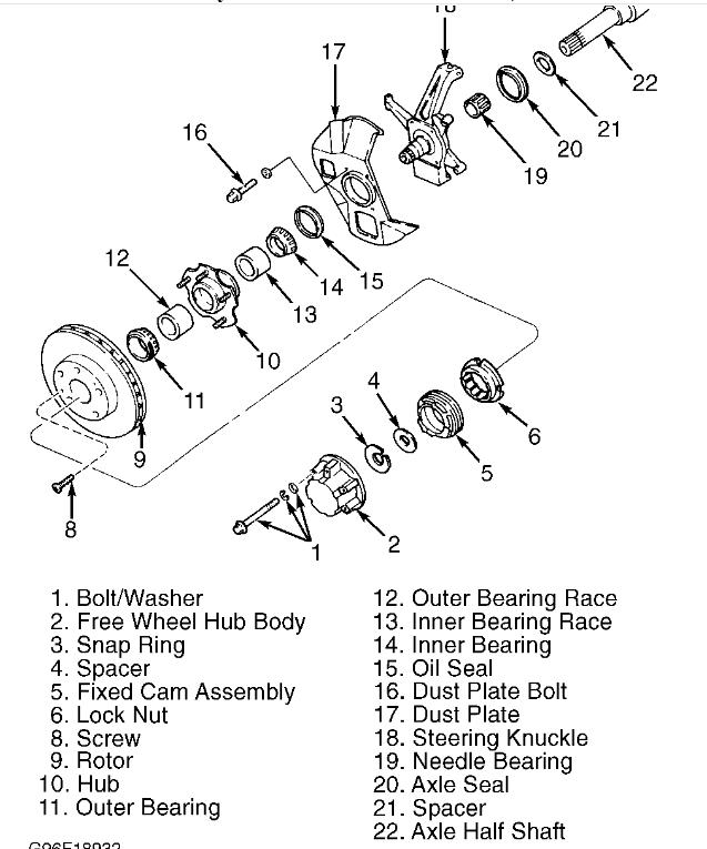

Hello , i want to ask you something. I have a kia sportage year 2000 , and the right front wheel looses it's power after i drive the car in 4hi or 4 low for 20 meters, and during the 20m drive i hear a crank sound. Car has manual hubs , so i figured out how to unlock the wheel temporary ( i get out of car , set the wheel hubs on free position , and then drive the car for 20 meters) , but then when i put 4hi or low again , the car works the same, 20 m and then the cranking sound, and then it's like the front right wheel has only 10% power, and the rest of wheels have the remaining power. Please help me, conditions about road where this happens: snow, dry , wet , any kind of road.

kinda sounds like the hub is bad. or the axle shaft is stripped out. see pic
