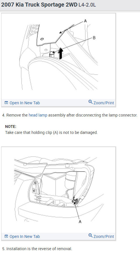

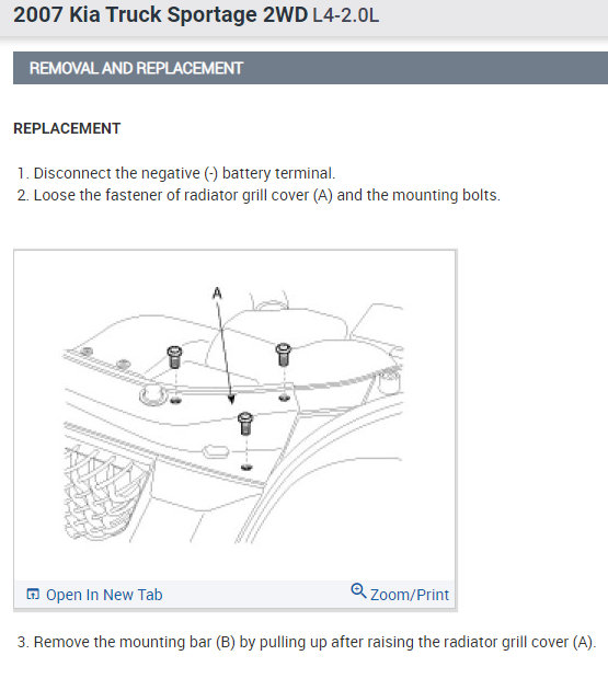

how do you change the front parking lights?
2007 KIA SPORTAGE
CAPUTER
how do you change the front parking lights as there are no access panel or hole to get to them
Mar 5, 2009 at 7:59 PM
SQM
  • 6,383 POSTS
In order to change those lights you will have to remove the headlight assembly.
Removing the headlight assembly can be done easily.
You will have to remove three fastener on the top of the radiator grille cover.
Lift up the cover.
You will see a mounting bar that needs to be pulled up to remove.
This will release the headlight assembly.
