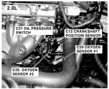

2005 Kia Sportage OXGYEN SENSORS
RAVENMAN50
  • 2005 KIA SPORTAGE
  • 6 CYL
  • 4WD
  • 114,000 MILES
WERE ARE THEY LOCATED AND HOW MANY ARE THERE ON THIS VECHILE. WHEN WE LOOKED UNDER THE CAR WE DON'T SEE THE SENSORS. WHEN I LOOKED UP TO ORDER THE SENSORS ON LINE THEY HAVE THREE DIFFRENT ONES? JUST NEED TO KNOW SO I CAN ORDER AND REPLACE THEM.
Tuesday, April 7th, 2009 AT 3:57 PM
BLUELIGHTNIN6
  • 16,542 POSTS
The 2.0L engine is equipped with 2 oxygen sensors, located at top left rear of engine (pictured below)..
https://www.2carpros.com/forum/automotive_pictures/261618_Noname_420.jpg
The 2.7L engine is equipped with 4 oxygen sensors, located top right rear of engine, left front of engine, top left rear of engine and top right front of engine.
