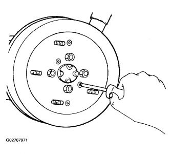

I need help figuring out how to get the rear drum off. I can not find an adjustment screw to lossen the shoes.

make sure you have loosened the 4 hub nuts and screws, shown below. once removed ensure park brake is off then drum should slide off, may have to bang on it with rubber mallet a few times in between studs.
