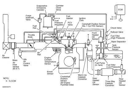

why won't it except gas when on empty? it keeps spitting it out

It has something to do with your EVAP and vacuum systems. Start by checking your tank pressure sensor and the two way check valve.
