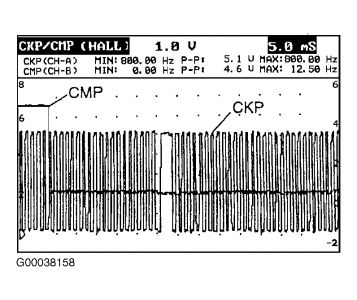

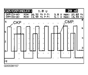

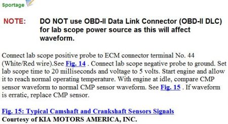

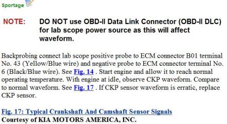

How do you test the crank and cam sensors?
Mar 29, 2009 at 11:23 AM
ZACKMAN
Experienced Mechanic
4,202 POSTS
Mar 29, 2009 at 2:37 PM
