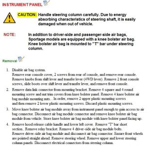

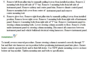

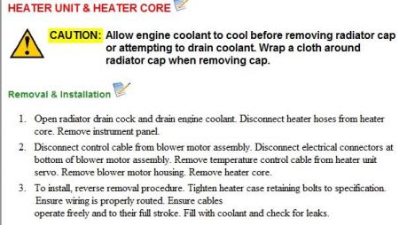

how do i change heather core
Mar 29, 2010 at 4:21 AM
BLUELIGHTNIN6
Experienced Mechanic
16,542 POSTS
Mar 29, 2010 at 10:58 AM
